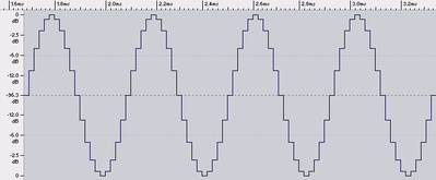

I suspect the origin of this myth comes from a common misconception: many people (even they stop to think about it at all) assume that because digital audio is a set of samples, when you play back those samples you will get something like this:
Figure 1: 2400 Hz 0dB sine wave sampled at 48kHz 16 bits
It's easy to understand why this misconception occurs. There are plenty of published graphs very similar to the one above that purport to explain how digital audio sampling works. Even software programs that manipulate digital audio often draw waveforms on the screen like this. The above example is actually a screen capture of Steinberg's Wavelab 5.

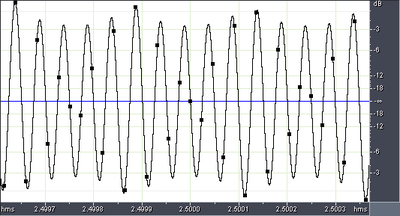

The truth is: digital audio playback will reproduce sine waves "perfectly" (or at least, within the resolution implied by the sampling word depth). This is how the above sine wave (19,997 Hz sampled at 44.1kHz) will theoretically be played back (on a "perfect" DAC):
Figure 5: The same signal as Figure 4 but with analog reconstruction
As you can see, a perfect sine wave is "reconstructed" between the samples, with amplitude accuracy in between sample points. By the way, the above is a screen capture of Adobe Audition, which is the only digital audio editing tool I have encountered that actually correctly draws the analog reconstructed waveform in between sample points.

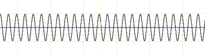

To prove that Figure 5 is not just a theoretical reconstruction, here is the actual analog output of the Panasonic DVD-S97 player playing the above waveform, captured at high resolution. As you can see, what comes out of the player is a perfect sine wave (exactly as theory predicted and not as Figure 4 would imply), within the limits of capture accuracy:
Figure 6: Analog output of Panasonic DVD-S97 playing back a 19997Hz 0dB sine wave

Armed with this knowledge, let's re-examine Figures 1-5. Hopefully, you will now realise that the output of a digital audio player cannot be a set of "staircases" like Figure 1, because the abrupt transitions between sample points contain frequencies far higher than Nyquist. Similarly, it cannot be a set of straight lines between sample points, like Figures 2-4, because the sharp transitions and "corners" between sample points also contain frequencies higher than Nyquist. In all the above cases, once you have filtered out frequencies above Nyquist, what remains is a sine wave.
But what about Figure 4, where the samples don't quite align to the peaks of the sine wave? How can removing frequencies above Nyquist restore the correct peak levels (which are higher than any individual sample)? This is hard to explain without resorting to mathematics, but essentially Fourier Theory postulates that any complex continuously varying signal can be represented by a set of sine waves of varying frequencies and amplitudes. When you sum all these sine waves, you get the original signal.
In the case of Figure 4, if you draw a set of straight lines between sample points, you are plotting a signal composed of many sine waves summed together. These sine waves "modify" the original sine wave and lower the actual peaks of the waveforms. When these extraneous sine waves are removed, the peaks of the sine wave between sample points are restored.
If you still find this difficult to swallow, try thinking of it in a different way. The reason a perfect sine wave is output even though the samples did not capture the peaks is that a 19997Hz sine wave is the only possible plot that you can draw that passes through all the sample points but does not contain frequencies higher than Nyquist. This can actually be proven mathematically, but I will spare you the calculations.

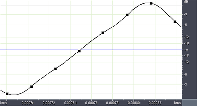

As an example, this is how a 4001Hz sawtooth wave looks like after filtering at the Nyquist frequency:
Figure 7: 4001Hz 0dB sawtooth wave sampled at 44.1kHz 16 bits
As you can see, the peaks of the sawtooth are "rounded off" and the lines connecting the sample points are slightly "wavy" rather than straight. At higher frequencies, you can see that digital audio playback cannot even preserve amplitude accuracy for sawtooth waves:
Figure 8: 19997Hz 0dB sawtooth wave sampled at 44.1kHz 16 bits
