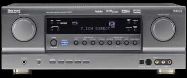

Some Receiver manufacturers such as Sherwood New Castle, and Pioneer Elite now offer bass management on their analog inputs, however there is a price to pay for this convenience. For example, the Sherwood Newcastle Model R-963 claims to offer complete bass management for DVD-A and SACD.
Sherwood New Castle Model R-963 Multi Channel A/V Receiver
I did some digging and found out what they are doing is taking the DVD-A / SACD signal, converting it back to digital, processing it inside the Receiver to add bass management, and then converting it back to analog for amplification. So let's get this straight.
- Step #1
DVD-A / SACD player converts digital signal to analog to pass into Receiver. - Step #2
Sherwood R-963 Receiver converts analog DVD-A / SACD signal back to digital to process for added bass management. - Step #3
Sherwood R-963 Receiver converts re-digitalized DVD-A / SACD back into analog for amplification. Can somebody tell me how we are going to hear the supposed added resolution of DVD-A / SACD when we are butchering the hell out of the signal by bouncing it back and forth between the digital and analog domains? This sounds like a good idea to me, where do I sign up?

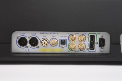

There has been some progress here. The DVD-AWG decided on firewire or IEEE1394 as the standard digital interface for DVD Audio. Now the question remains is when will hardware vendors fully support this? Pioneer has introduced one of the first hybrid DVD-A/SACD players with the I-link digital output which incidentally only interfaces with their mega $4K+ flagship receivers and the digital interface only operates for DVD Audio, not SACD. Another company to note who has a solution is Denon. According to their Rep at CES 2002, the new Denon AVR 5803 Receiver has a proprietary digital interface which is exclusively mated with their new DVD 9000 players. This is a brilliant strategy as it does not violate the copyright law set upon digital transmission of high resolution audio signals. While this seems promising, it leaves me a little uneasy that there are only a few vendors with this solution, forcing us to buy costly flagship Receivers and matching DVD Audio players if we want high resolution DVD-A with proper bass management, time delay, and level settings. It would be nicer if the universal digital interface would be adopted more quickly by hardware vendors so that consumers had their choices of brands and model #'s to suit their preferences and budgets. It would also be nice if Sony / Phillips would jump on the standardized digital interface bandwagon and we could have a single digital interface solution for both formats to eliminate all of the technical and cabling issues currently hindering these potentially high resolution formats.
IEEE 1394 Firewire Interface
Meridian, the co-developer of Meridian Lossless Packets (MLP) also has a proprietary digital interface for their Preamp Processor and DVD player. However this is a very costly system that most people would have to refinance their homes to afford. It is unclear if Meridian intends to transmit MLP data via this interface from the DVD-A player to the Processor, or if this interface will be used solely for DD / DTS and digital transmission to their active DSP loudspeakers.
