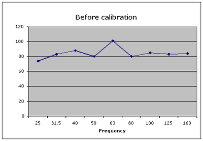

After the first pass, it was apparent that I had some serious issues. I had a huge peak (+20db) at the 63Hz point, one at 40Hz and some peaks in the 100-160Hz range. This is something I would have never known without running these test tones.
This meant when I set my subs level with the SPL meter and the pink noise from my receiver, what I was really in effect doing was setting the bass level to the peak at 63Hz and all the other frequencies were being obscured.
In reality I was down 21db at 30Hz. That also explains why the gain on my subwoofer was always so low.

Now according to the Rives CD and the tones, I was only up 8db at 63 and dead on at 31.5Hz. Now I had good subwoofer positioning to begin tweaking the response with the EQ. Since my sub is only rated flat down to 27Hz, I did not touch any of the EQ settings from 25hz and below and I lowered the bands from 80Hz to 160hz to account for any overlap in the receivers cross over. My final results were pretty respectable from 31 to 160.
My bass was now almost ruler flat according to the meter and the Rives tones and I only had to boost ever so slightly at a few points. However, I am only using the EQ below 80Hz. To fix the upper areas I had lower my woofer sections overall level. I have my receiver bi-amped so I just lowered them a few db's this also helped out from 600 to 2500 as well because it was a little high there too.
