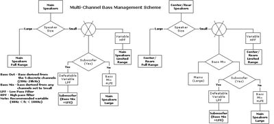

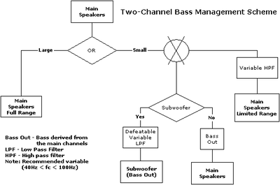

Now Let's Talk About Flexible Bass Management
In order to achieve the most out of your home theater system, I have devised a flexible bass management scheme, regardless of standards, to realize all possible user combinations for maximum performance realization for all speaker, amplifier, and room combos.
Summary of Flowcharts
The point I was attempting to convey in the bass management flowcharts was versatility in the system that can accommodate all speaker types and configurations. The same basic two channel audio bass management principals should be carried over for multi channel applications. For example, if you have large bass capable main speakers and a musical subwoofer that you wish to cross over below 50 Hz to provide added bass boost to your mains, your Receiver / Processor should have the ability to route bass signals to your subwoofer at the desired cut-off frequency, or offer a defeat option on its internal LPF for you to use the LPF of your sub, while still maintaining full frequency range output to your main speakers. There are so many Receivers / Processors on the market from the big name brands that still don't understand this concept and thus either do not allow you to operate your subwoofer in two channel mode at all, or if you have the mains set to large. In fact only about 10-15% of the Receivers and Processors on the market allow for an adjustable LPF for the subwoofer, and fewer units allow you to defeat the internal LPF in case you desire to use the one built into your subwoofer. Why?
The multi channel bass scheme does add complexity over that of the two channel one, but the fundamental concepts are the same. The bottom line is as follows:
Any speaker set to small must route the bass information for that speaker to the main channels if no subwoofer is present, or to the subwoofer if one exits.
