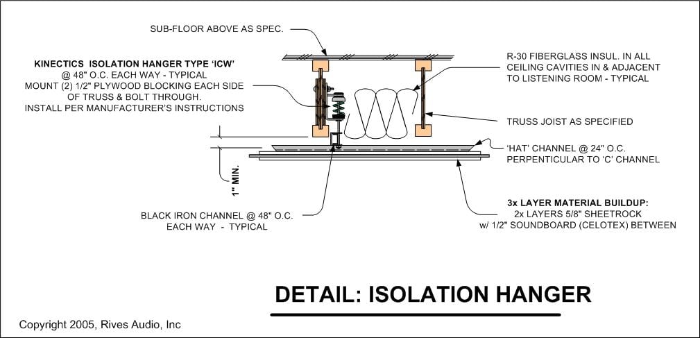

Fig1ceilingsystems.jpgStructure born noise is often the hardest to deal with. You need, as stated above, a high mass and an air space, so that there is no positive structural contact. In the case of the hard floor above the list ening environment you will need to decouple the floor joists from the ceiling joists. The most common and effective way to do this is to use spring loaded isolation hangers. Companies such as Mason Industries and Kinetics make these isolation hangers which are suitable for creating a suspended high mass dry wall ceiling (see fig 1). That is not to be confused with the typical suspended ceiling, which has very little mass and will not stop sound from penetrating into or out of the room very effectively.

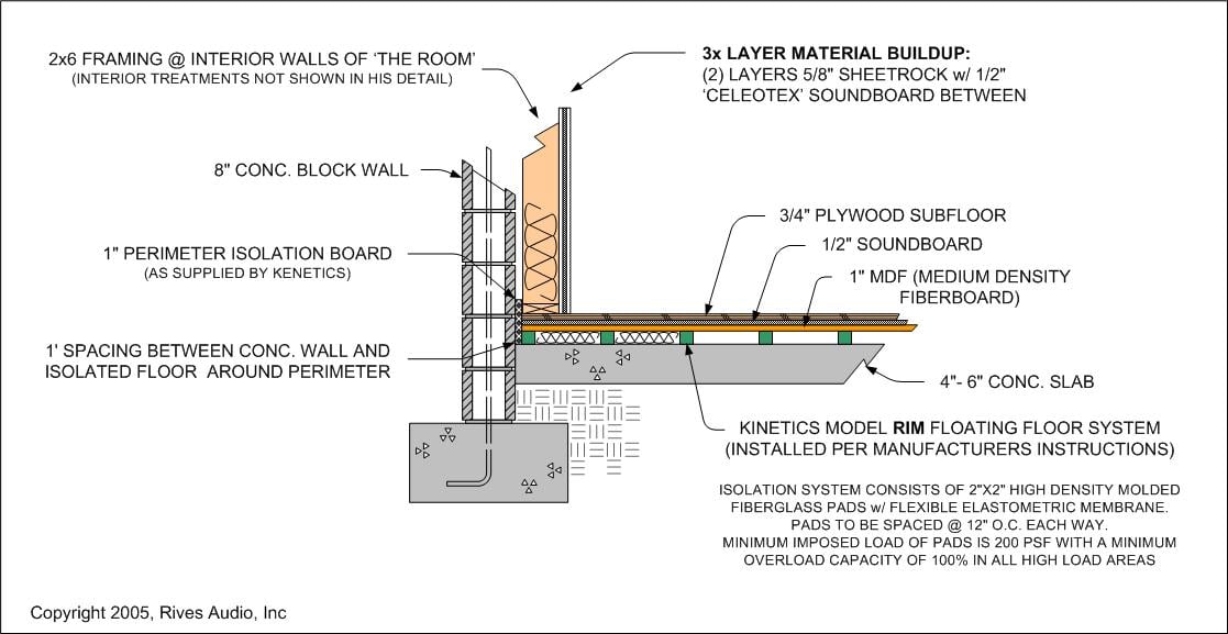

Fig2floorsystems.jpgNow let's look at another type of structure noise - the busy road outside. You might think this is air borne and it could very well be. That noise will penetrate windows quite effectively, but if you are in a basement on a concrete slab, there may be more noise that comes in from vibration. In recording studios this is particularly important and it needs to be dealt with. Kinetics makes a product called a RIM Floating Floor system (see fig 2). This system rolls out onto the sub floor and then you build a standard floor above it. It has a resonance frequency of around 4 Hz, so anything in the audible bandwidth will not penetrate through it, if it is installed correctly. A subfloor (2x ¾" plywood layers or more), the walls, and the final finished floor can all be built on this floor isolation system.

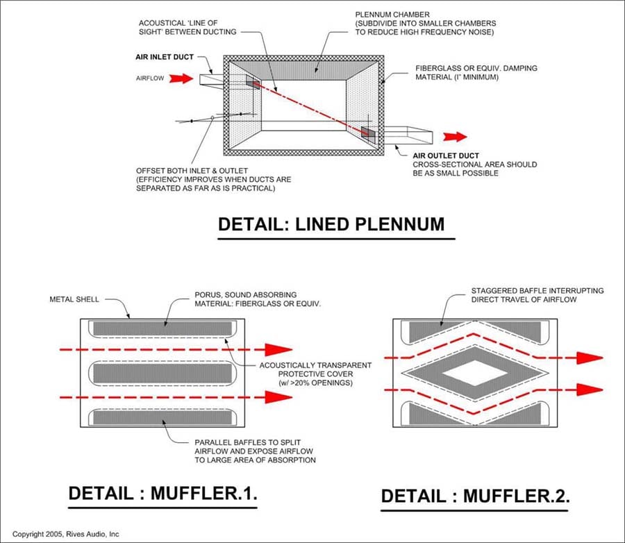

Fig3HVACsystemsEHX.jpgFinally, let's look at air borne noise. This typically comes through thin walls, windows, or as stated previously, the HVAC (one of the most common overlooked issues in a good home theater design). Duct work is like an open channel to transmit sound - a 'flanking path' in Acoustical terms. Have you ever talked in one room and been heard quite clearly in another room, halfway across your house? Were you close to a HVAC duct when this occurred? So what can you do about this type of noise? Actually, it's relatively simple to reduce noise of this type from various parts of the house simply by adding a baffle box and/or plenum that is lined with absorbing material to both the trunk and return of the HVAC unit. A baffle box is basically a large box that has at least two 180 degree turns or a combination of turns to give essentially the equivalent. A plenum is kind of like a muffler, not as effective as the baffle box, but much better than nothing (see fig 3). The second aspect of the HVAC system is the noise it generates by moving air through the ducts and in and out of a room, and the noise of the motors and fans of the unit itself. Most households have relatively small ducts for the volume of air moved. It's fine for most residential applications, but not for our critical sound areas. We need to oversize the ducts and more importantly oversize the diffusers where the air exits into the room. Typically we like to have air velocity into the room less than 225 CFM (Cubic Feet per Minute). An HVAC contractor can calculate the load required for the room and the amount of air exchange needed, and determine the diffuser together with the duct size needed to achieve this. If your HVAC contractor looks at you and asks, "how do I do that?", get another HVAC contractor. It's also a good idea to line the last several feet of ductwork with a sound absorbing material.

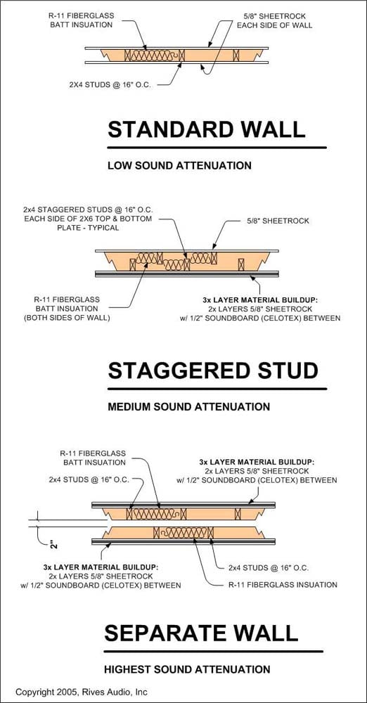

Fig4wallsystemsEHX.jpgNow we have some of the basics covered, let's look at few more areas. First is the interior high mass structure, namely the walls. How will these be constructed so that there is a high mass interiorly and an air gap, a physical space between the two elements of mass? There are many ways to accomplish this. First you need to create the high mass; this can usually be accomplished by using 3 layers of material, generally 2 layers of gypsum with "some" interior layer that they sandwich. I say "some" because there are many interior layers that are suitable depending on the needs of the room. We won't go into the details of these different interior layers, but in general they can be broken down into two categories: Homasote or Celotex, a low density sound board, or a damping layer such as ASC Iso blocks or Audio Alloy's "Green Glue". The second aspect is the air gap, which can be done either by a resilient channel, or by creating a separate or staggered stud wall. The greater the air gap and the higher the mass, the better the isolation will be. (see fig 4).
