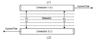

A typical Twin Feeder cable, or more popularly referred to as "Zip Cord", consists of two adjacent conductors separated by insulation, or commonly referred to a "dielectric". For convention we assume Conductor 1(+) current flows from left to right, and Conductor 2 (-) return current flows from right to left as illustrated below.

Self Inductance: is comprised of internal and external inductances (L11 = Le1 + Li1, L22 = Le2 + Li2) Where the internal inductance of a straight wire with circular cross sectional area carrying a uniform low frequency current is 1.27 * 10^-3 uH/in or .0152 uH/ft. In the case of a Zip Cord speaker cable, the total internal inductance at or below audio frequencies is
2*(.0152) = .0304 uH/ft
Mutual Inductance: is a result of L1 and L2 interaction (L12) where L12 < Le2, and L2 and L1 interaction (L21) where L21 < Le1. The coupling coefficient (for two identical conductors) is equal to the Mutual Inductance divided by the Self Inductance where L12 / L11 = L21 / L22 .
