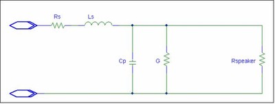

So what does matter in speaker cables? The RLC losses do. Below is a basic lumped model for one foot of speaker cable.
Cable Metric Definitions
- Rdc - Commonly referred to DCR which is the series resistance of a cable at zero frequency.
- Rac - The resistive portion of the cables series resistance as a function of frequency due to skin effect.
- Rs - Total Series Resistance (mohms) measured tip to tip at one end of the cable while the other end is shorted. Note: Rs = Rac + Rdc (minus instrumentation inaccuracies identified below)
- Ls - Series Inductance (uH) measured tip to tip at one end of the cable while the other end is shorted. Check out our article on Cable Inductance for more info.
- Cp - Parallel Capacitance (pF) measured tip to tip at one end of the cable while the other end is open circuited.
- G - G represents conductance ( 1 / Rdielectric). The major relevancy roles of the dielectric in this application are to serve as isolation between the two conductors and control the capacitance of the cable based on the conductor spacing and dielectric constant.
The typical 12AWG zip cord has about 3.4 mohms of loop resistance per foot, .200uH/ft of Inductance and about 20pF/ft of capacitance. As the cable length increases, these three parameters increase proportionally. However, it takes very long lengths of cable to cause measurable, let alone audible differences. If we examine the data from our various Speaker Cable Face Off articles, particularly Speaker Cable Face Off I, we see that a 10ft length of 12AWG zip cord terminated into a 4 ohm load only experiences -.088dB of loss at 20kHz and about 2nsec of group delay. Increase the cable length to about 50ft and we do see losses surmount to about -.745dB and 209nsec. Note that at 20 kHz, a phase shift of 36 degrees represents 5 microseconds (almost 24 times larger than our 50ft cable delay), this delay being considered as close to the limit of human directionality perception. Further examining the data from our article Skin Effect Relevance in Speaker Cables we illustrated that model for human hearing is highly insensitive to ultra high frequency response and also discussed that music above 8kHz is harmonic in nature with minimal content at the high frequency extremes. It is a good idea however to use lower gauge wire (10 AWG or less) for runs greater than 50ft to minimize these losses especially when driving loudspeakers with a low impedance (4 ohms or less) profile.
