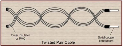

Advantages of Twisted Pair Wire
Twisted pair wiring, even when unshielded, is very effective in reducing magnetic field coupling to and from the wire pair. There are only two conditions necessary for this to be true. First, the signal must flow equally, and in opposite directions, on the two conductors. Secondly, the length of the twist must be less than one twentieth of a wavelength at the frequencies of concern. (One twist per inch will be effective up to about 500 MHz).
The above is true whether the terminations are balanced or not. In addition, if the terminations are balanced, twisted pair wiring will also be effective in reducing electric field coupling to and from the wire pair.
Even though field coupling is not the primary noise coupling mechanism in audio systems, it is still a good practice to always twist the signal and return conductors in a cable. (Twisting is especially important in the case of very low-level microphone cables.)
A 60 Hz shield current flowing between two interconnected devices will still produces a voltage drop in the shield, but this noise voltage is not in series with the signal. Rather it will be coupled equally (as a common-mode noise voltage) into both signal conductors. Since the receiver looks at the difference between the two signal conductors (not the voltage between one of them and ground), the common-mode noise voltage cancels out and is not seen by the receiver.
