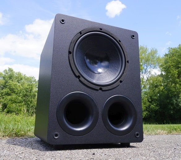

The VTF-1 mk3 arrived sandwiched between eight thick foam blocks on every corner that kept the subwoofer away from the box sides and protected it from bumps and shocks. It was bagged in a soft foam wrapping to protect it from scuffs, and a thick plastic bag around the foam bag to protect it from moisture. Since it is not a massive or heavy unit, these efforts should be more than sufficient to keep the it safe during shipping.

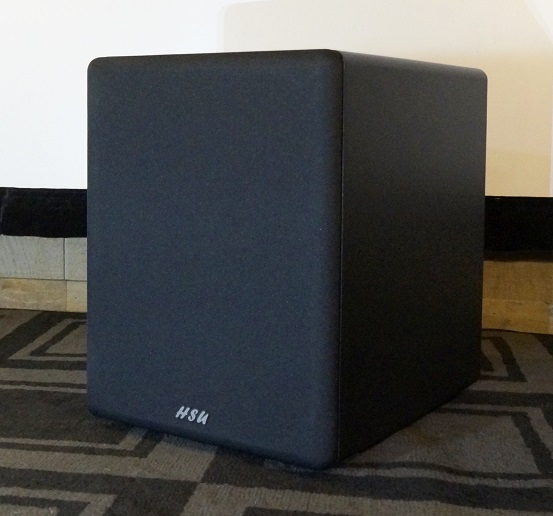

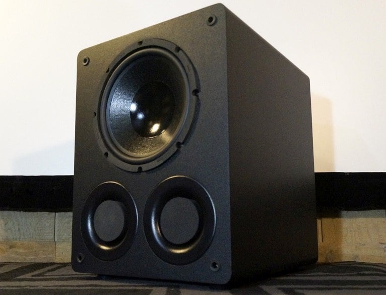

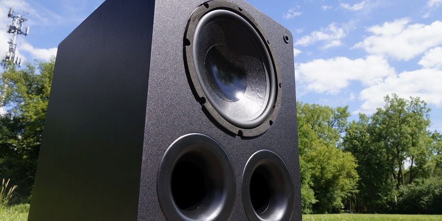

Out of packing, its looks like a fairly typical subwoofer. The vinyl finish has a smooth sheen that is nice, although, as with the VTF-2 mk5, it seems to be somewhat of a downgrade from the satin black finish of the previous mk2. The rounded edges do soften its appearance, especially with the grille on. It is not a very large sub, at least in comparison to the subwoofers I normally review. It should be able to disappear in a dimly lit corner without problem if the user does not want it to stick out. Without the grille, it does look functional with the driver, ports, and grille guides on display. I do like the shiny inverted dustcap of the cone. The VTF-1 mk3 looks like a smaller VTF-2 mk5.
As with other variable-tuning subwoofers, new owners are advised to read the manual to operate them properly, even more so than with regular subwoofers. They are not quite as simple as plug-and-play if you want to get the most out of them. Owners would do well to understand how sealing the ports combined with onboard equalization mode will affect the system.

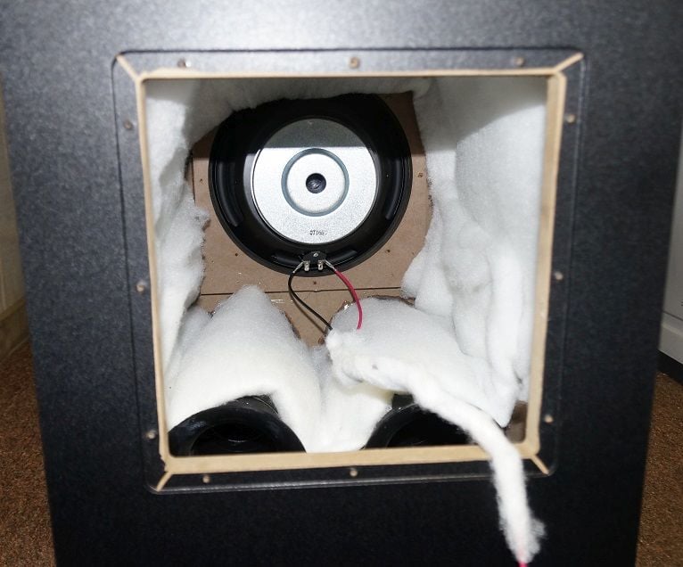

Design Overview

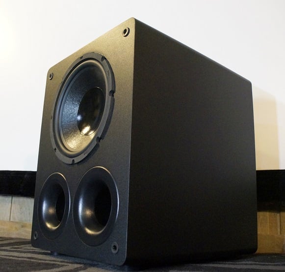

The VTF-1 mk3 looks like a smaller VTF-2 mk5, because, in many ways, it is a smaller VTF-2 mk5. It shares the same amplifier technology, same cabinet construction and design; only the sizes are different. As with the VTF-2 mk5, the cabinet paneling of the VTF-1 mk3 uses 3/4” MDF, except for the front baffle which is 1.5” thick. There is a piece of cross-bracing supporting the two 12.5” long ports. Each port has a 3.5” diameter. The cabinet is lined with polyfill. The rubber feet are the same, as well as the grille construction that uses rounded metal pins for the grille guide sockets.
Inside view of VTF-1 mk3 Subwoofer
The ‘VTF’ in the VTF-1 stands for Variable Tuned Frequency, which is the system that allows the user to adjust the extension of deep bass. For those who are not familiar with how this system works, we will quote from our VTF-2 mk5 review:
The function of ports on speakers and subwoofers is to produce sound more efficiently at low frequencies than the drivers are able to. They do this by using the backward motion of the woofer into the cabinet to resonate the air mass within the port. The port’s length and width affect the frequencies at which the port generates sound; the longer a port is with respect to its width, the deeper frequencies it will produce. However, the wider a port is, the more output it will generate at its resonant frequency. Placing multiple ports in a speaker or subwoofer will act like one port that has the width of all the ports combined. In systems such as Hsu’s VTF subwoofers, the user can exchange output headroom at higher frequencies for lower frequency output by plugging one of its ports, thereby increasing the length of the ports with respect to their collective width. This enables the subwoofer to play deeper frequencies far more effectively but at the cost of output potential at some frequencies above that point.

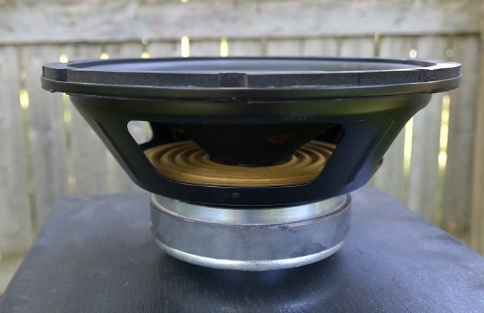

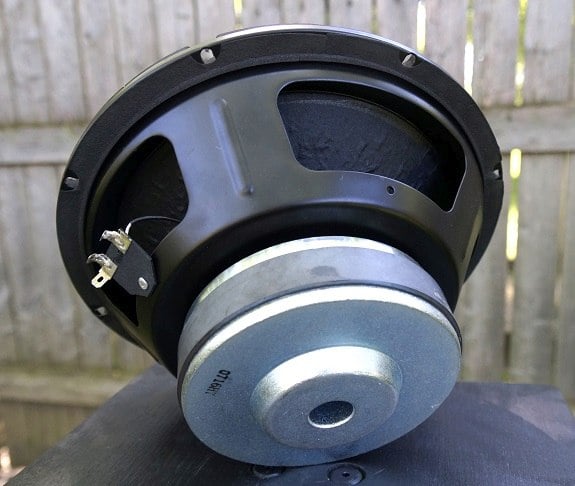

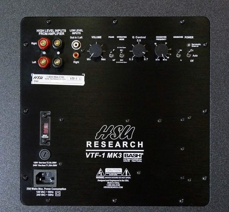

The driver lookVTF1_rear_amp_plateC.jpgs adequate for the task but not heavy-duty. It is largely assisted by the generous cabinet size and port area. It uses a stamped steel basket, a decent sized Nomex spider for a 10”, a 2” voice coil, and a single 5” x ¾ magnetic slug. We can see that the backplate has been bumped out to make room for higher excursions, and there is a hole in the pole piece for ventilation. Hsu informed me that the driver uses a shorting ring. On the whole, the driver looks adequate for the task at hand.
The VTF-1 mk3 amplifier is similarly a scaled version of the VTF-2 mk5’s amp. For the VTF-1 mk3, Hsu has upgraded the BASH amplifier to a 250-watt unit, up from the 200-watt amp of the mk2. The BASH (Bridged Amplifier Switching Hybrid) amplifier technology combines the sound quality of AB amplifier topologies with the high efficiency of Class D amplifiers. Among the features of the VTF-1’s amplifier, a Q control is used to manipulate the slope of the low-end roll-off. Speaker-level inputs allow the subwoofer to be used with systems that do not have an LFE output or a line-level output. An adjustable low-pass filter ranging from 30 Hz to 90 Hz gives users control over the subwoofer’s bandwidth for setups that lack bass management. A voltage input switch makes the subwoofer usable in countries with different electrical standards.

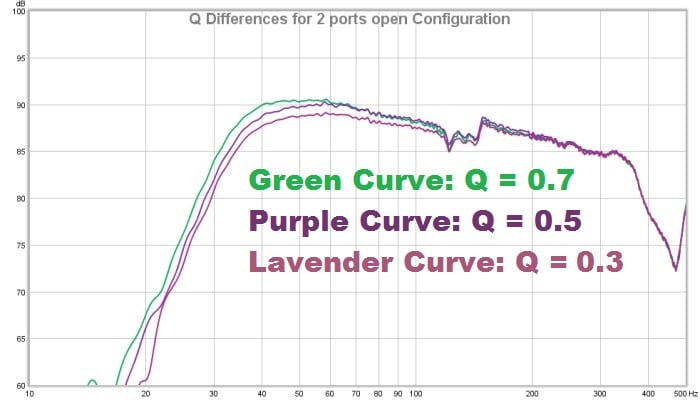

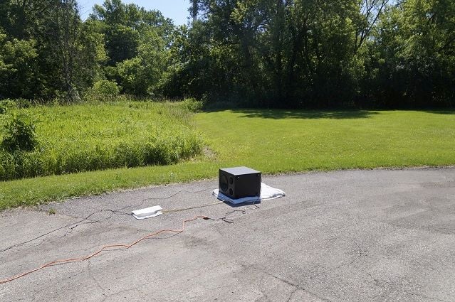

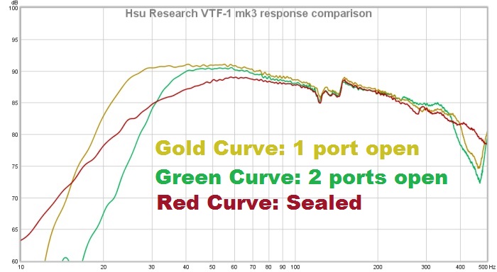

The Hsu Research VTF-1 mk3 was tested using ground plane measurements with microphone at a 2 meter distance in an open setting with well over 100 feet from the nearest large structure. The sub was tested with woofer and port side facing the microphone. The subwoofer’s gain was set to maximum, phase was set to 0, and the low pass filter was left off. Weather was recorded at 70°F and 43% humidity.
frequency responses of the VTF-1 mk3 for different configurations

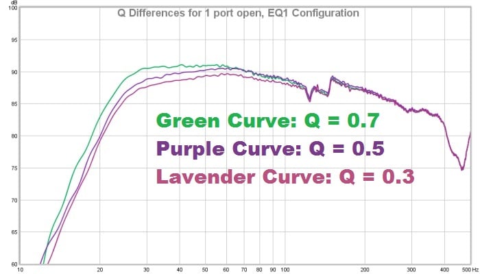

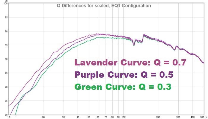

The above graphs show the frequency responses of the VTF-1 mk3 in various configurations. In its vented configurations, we can see the VTF-1 does sport a nicely flat response. Of course, the single ported mode does have a more extended response that is flat out to 30 Hz as opposed to both ports open which is flat down to 40 Hz. Our measured responses do not quite meet the stated window of responses by Hsu Research, but it is close. It is so close that the difference could easily be due to slightly different measurement methods. One feature to note is the extended high frequency response; this is a subwoofer that could feasibly be used with a crossover point as high as 300 Hz if the user wanted. While that is not practical in the vast majority of setups, it certainly doesn’t hurt anything and might be fun to experiment with for those who are curious.

One important point that can be seen in these graphs is the sheer difference of extension between having both ports open with the VTF-1 set to ‘2EQ’ versus having one port open and set to ‘EQ1.’ The -3 dB point between them are the mid 20 Hz region and the mid 30 Hz region. This is by far the most significant difference I have yet seen on a variable-tuned subwoofer. Most variable-tuned subwoofers have their tuning points at the low 20’s and the mid teens, and that is not a big audible difference. That sort of difference usually only a subtle one in actual content that takes advantage of such deep frequencies. However, the difference between 25 hz and 35 Hz is very audible and can significantly alter the listening experience (providing that the content takes advantage of frequencies that deep).
This leads us to the question of why would anyone want to use the VTF-1 mk3 with two ports open when it chops off so much of the deep bass? The answer to that is it can be worthwhile trade-off if the VTF-1 mk3 offers substantially more output at 40 Hz and above with both ports open. The reason is that while modern movies can routinely take advantage of frequencies below 40 Hz, most music does not. Rock music rarely digs down as deep as 40 Hz, and even dubstep and hip-hop music seldom dig lower than 40 Hz, but they often do have a lot of energy in the range of 40 Hz to 80 Hz as the fundamental in the bass line and tuning of the kick drum. Opening both ports allows more headroom for bass in music ranges, while closing a port exchanges that mid-bass headroom for deep bass extension.
In the VTF-1 mk3, this exchange of deeper bass for louder bass is far more useful than in typical variable tuned subwoofers, since there is only so much headroom that can had from a smaller subwoofer built from modest components. With the ability to reallocate its strength towards frequency bands that suite specific content, the user has the choice between a punchier sub for music content or a deeper digging subwoofer that can catch low-frequency film content like earthquakes and rocket launches.

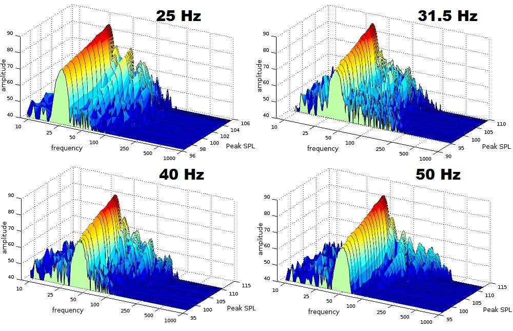

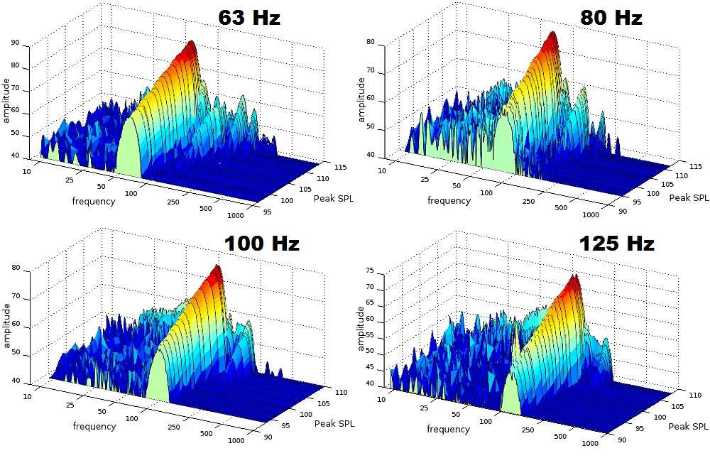

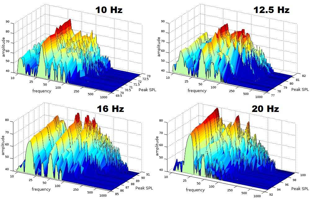

Frequency Breakdown of CEA-2010 Burst Measurements for the Hsu Research VTF-1 mk3
The above graphs show the measured frequency spectrum of the increasing CEA-2010 burst tests. Essentially, it depicts the behavior of the subwoofer reproducing short burst tones at successively louder levels, with each test tone raised by boosting the input gain by 1 dB until no more output was to be had from the subwoofer. The frequency marked above the graphs note the fundamental tone being tested, and this can also usually (but not always) be discerned in the graphs by the horizontal axis frequency point of the “main ridge,” the highest levels on the vertical axis. The noise below the fundamental (that random spikiness to the left of the main ridge) should be ignored. What should be looked at are the smaller ridges to the right of the fundamental; these are the distortion products of the fundamental, and it is here where we see how cleanly the subwoofer handles a given output level. These are mostly harmonics: whole number multiples of the fundamental.
The above graphs are of measurements of the VTF-1 mk3 with one port open. This can be seen by comparing the 20 Hz measurements to the 25 Hz measurements; the 25 Hz performance exhibits for more control and linearity. The 10 Hz through 16 Hz graphs show the output is dominated by distortion, since, of course, this frequency range is below the subwoofer’s intended operational range. For those who are worried about hearing a lot of distortion, the good news is that output down here is very low, since the VTF-1’s limiter doesn’t permit much sound to be generated in this range at all. The overall performance shown here is quite good until the last dB where the subwoofer is pushed to the very edge of its mechanical limits, but even then distortion does not become so severe as to overwhelm the fundamental.
What is seen here is that the VTF-1 mk3 produces clean bass for the great majority of its dynamic range of operation. It is a well-balanced system that will not be pushed into high levels of distortion above 30 Hz no matter how hard it is pushed. 25 Hz does allow for a greater levels of distortion than 30 Hz and above, but that is the bottom of its response knee. To be sure, the bass seen here is not quite as clean as much larger and more expensive subwoofers we have tested in the past, but, when not even considering its size, specifications, and price, it is still good. However, when considering its size, specifications, and price, it is exceptionally good.

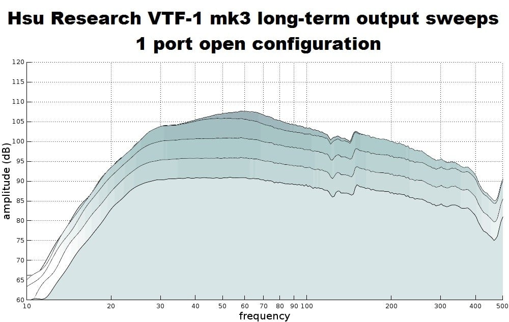

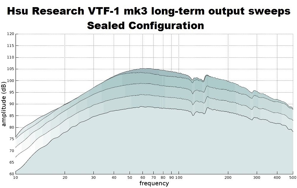

Long term output sweeps of the Hsu Research VTF-1 mk3 in different operating modes

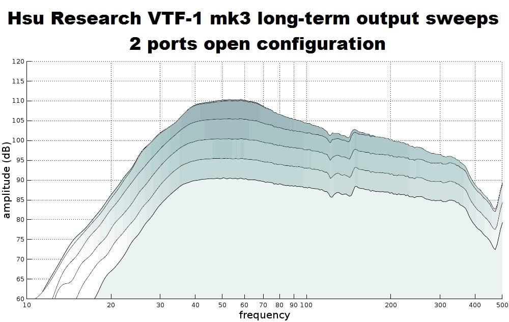

Testing for long-term output compression was done by first conducting a 20 second sweep tone where 50 Hz hit 90 dB with the subwoofer 2 m from the microphone. We then conduct further 20 second sweeps by raising the gain by 5 dB until no more output could be rung out of the subwoofer. One thing we can see here is a more explicit view of the difference in headroom that the different ported modes make. Again, we see that 2 ports open mode has a big advantage from the mid 30 Hz range and above, while the single port open mode has a big advantage at the lower 30’s and below.
 In its 1 port open operating mode and sealed operating mode, the VTF-1 mk3 sees only mild compression affecting its frequency response at the highest drive level. With 2 ports open, compression does take a more significant toll at 70 hz and above, but for those using an 80 Hz crossover point, that isn’t going to make a big impact on the sound. From 40 Hz to almost 70 Hz, the VTF-1 mk3 is hitting 110 dB continuously. In that frequency band with both ports open, that is the kind of performance one would expect to see from a decent 12”, not a 10” subwoofer with its modest specification set. This design is squeezing the absolute most performance that can be wrought from these components. Altogether this is a heavily optimized system, and that shouldn’t be so surprising considering that this is essentially the fifth generation of this subwoofer when the VTF-2 mk1 and mk2 are considered in its lineage.

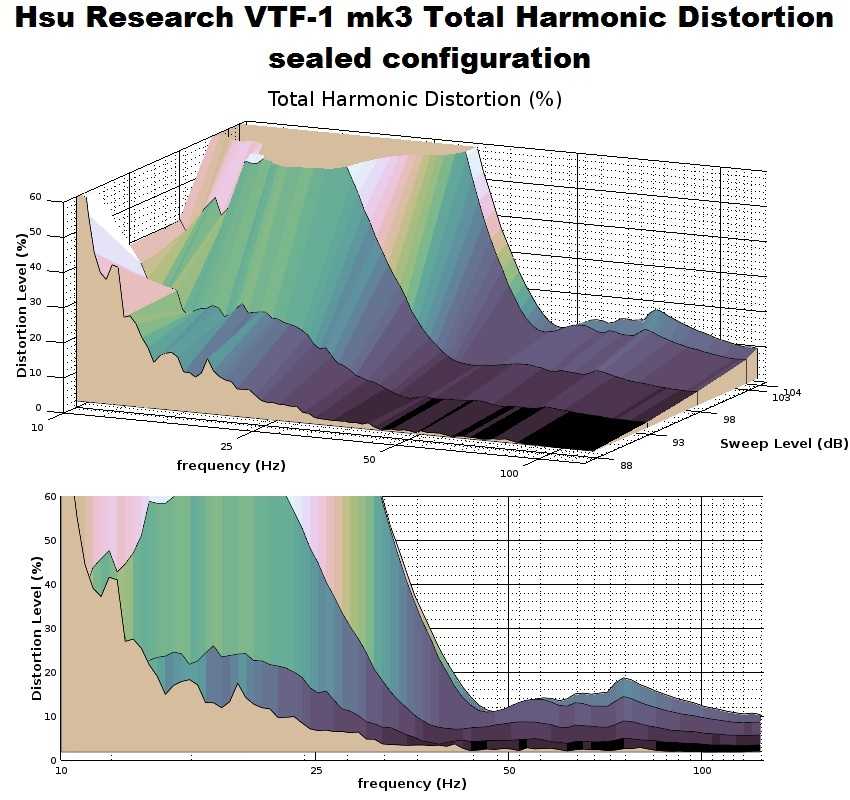

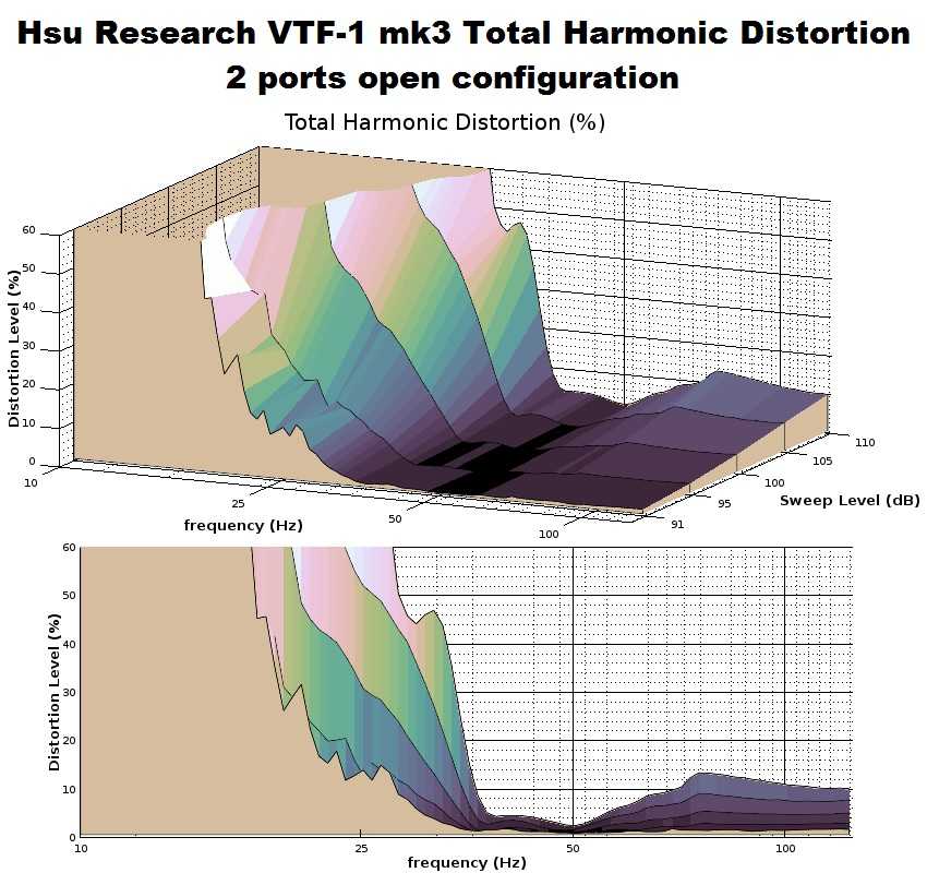

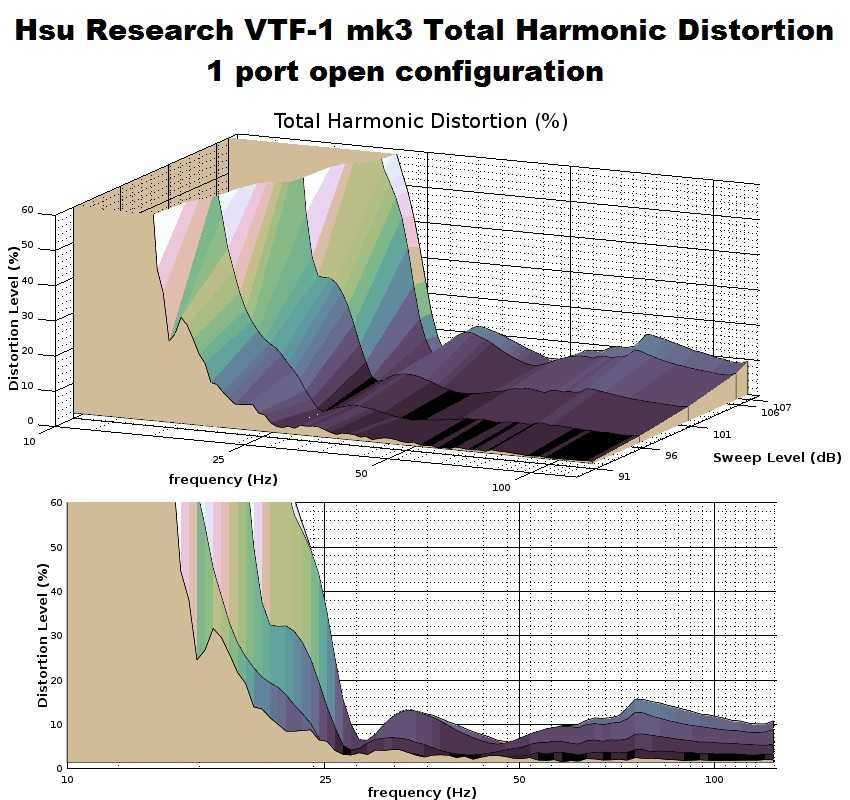

Hsu Research VTF-1 mk3 Total Harmonic Distortion per operating mode and output level
The above graphs show the corresponding total harmonic distortion to the long-term output graphs. Essentially they depict how linear the subwoofer remains for the corresponding drive level seen in the long-term sweeps. The quantity being measured is how much of the subwoofer’s output is distortion and is shown here as a percentage. For those who are familiar with our reviews of variable-tuned subwoofers, there will be no surprises here. One thing worth mentioning is that at the 90 dB sweep, we can see a bit more distortion in the low frequencies than what is seen at the next higher sweep; this is because there is so little output in that region that environmental noise becomes a significant fraction of what is recorded, and anything not recorded as signal is seen as distortion by the test equipment. The reality is there is not much output produced by the VTF-1 mk3 in those frequency bands at all. Lower output should be kept in mind for all the regions where distortion is seen to be skyrocketing; it is spiking up rapidly as the drive level increases, but the subwoofer’s output is rapidly declining as well. This is more true for the ported operating modes than the sealed operating mode which rolls off at a shallower rate.
A t nominal drivel levels of 90 dB and 95 dB, distortion is extremely low in the various modes’ intended range of operation; non-existent for practical purposes. At the 100 dB sweep, THD rises to roughly 5% across the board. Here we can see mechanical stress is having an effect, but 5% is still very unlikely to be audible. The 105 dB sweep brings THD closer to 10% and the 110 dB sweep, where the VTF-1 mk3 is being pushed to its absolute limit, is mostly north of 10% THD. The bottom line is that this is a very clean subwoofer until it gets pushed hard, but even here it still maintains reasonably good performance. We can see it brush up against its mechanical limits when it is being throttled, but it never loses control completely.

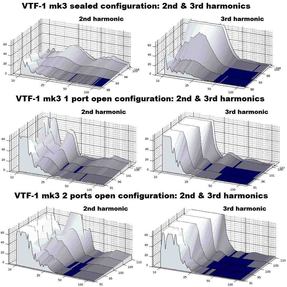

Component harmonics of the Hsu Research VTF-1 mk3 for each operating mode

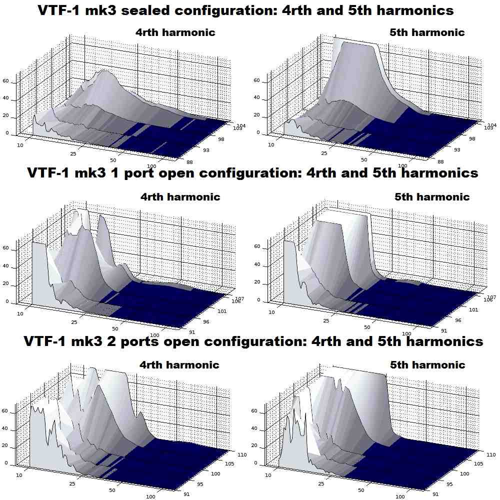

The above graphs depict measurements of the constituent harmonics from the long-term output sweeps and is what the total harmonic distortion measurements are composed of up to the fifth harmonic. The individual harmonics can give us a clue as to what might be the cause of some quirk or non-linearity. There is not much surprising in the VTF-1 mk3’s measurement set here, but one thing we learn is that most of the distortion above deep bass frequencies is primarily composed of the second harmonic. This is very likely the result of induction, where the motion of the voice coil around the permanent magnet’s field causes a counter-current with its own corresponding magnetic field. This counter magnetic field interferes with the desired magnetic field between the voice coil and magnet. Its effects can be seen by higher levels of 2nd order harmonic distortion and also a reduction in higher frequency output. Both of these effects are present in the VTF-1 mk3, but neither is severe thanks to the shorting ring in the driver which helps to short out the counter current.
The third and fifth order harmonics in the sealed configuration lucidly show the effects of high-excursion stress on the driver. It is not a high-excursion driver, so it does run into a great deal of distortion in deep frequencies in its sealed mode at high drive levels, but the limiter can be seen bringing it under control again by the time it reaches down to 10 Hz. Something else than can also be seen more clearly is the effects of the noise floor in lower level sweeps, which shows up here erroneously as output from the subwoofer. The reader should keep in mind that at lower drive levels, speakers and subwoofers almost always have lower quantities of distortion, not higher quantities, and the VTF-1 mk3 would be no exception.

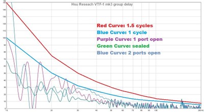

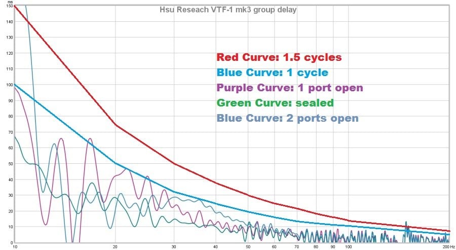

Hsu Research VTF-1 mk3 group delay per operating mode
Group delay is the measurement of how much time it takes for individual frequency bands of an input signal to be produced by the speaker. It can indicate that some frequency components are developing slower than others or are taking longer to decay. It is generally thought that 1.5 sound cycles are needed for group delay to be audible at bass frequencies, although there is an argument that group delay should remain under 20 ms to be completely unnoticeable, but that is likely meant for mid and upper bass frequencies. The VTF-1 mk3 has very good control of group delay across all three of its operating modes. Nothing here would be close to being audible, except that blip at 160 Hz, which theoretically might be audible in laboratory conditions, but since few VTF-1 mk3 owners are going to cross their speakers to their subwoofer at such a high frequency, let alone in a carefully controlled laboratory, that is nothing to be concerned about. Any of the larger peaks of group delay below 30 Hz is much too deep in frequency to be audible. As usual for variable-tuned subwoofers, the sealed mode has the lowest amount of group delay, but since nothing in the ported modes would be audible, that makes little difference. Overall, what is seen here is a reflection of all the other metrics that we have seen from the VTF-1 mk3; it is a heavily-optimized system with well-controlled behavior.
