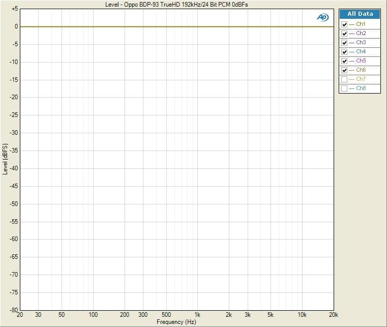

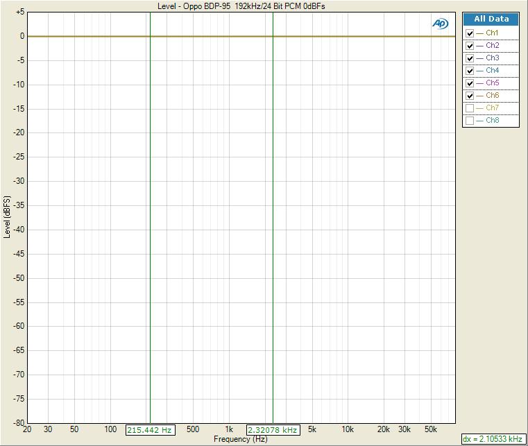

Setting the BDP-93 and BDP-95 players to LPCM so that the Audio Precision APx585 could analyze the integrity of the HDMI transmission from both players, we measured frequency response and distortion.
BDP-93 HDMI Freq  BDP-95 HDMI Freq
Oppo BDP-93 (left image) & BDP-95 (right image) HDMI Frequency Response

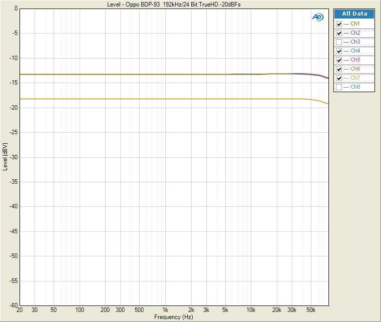

We ran both 192kHz/24 bit 6 channel and 96kHz/ 24 bit 8 channel Dolby TrueHD signals into both players and both produced similarly ruler flat frequency performance from 20Hz all the way up to the Audio Precision test gear bandwidth limitation (80kHz).

Oppo BDP-93 / BDP-95 Analog Frequency Response

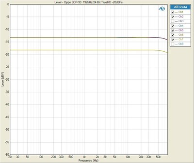

 With all speakers set to "large" we used a 0dBFS Dolby TrueHD 96kHz/ 24 bit 8 channel test signal to measure frequency response which was ruler flat from 20Hz all the way to the Nyquist frequency (1/2 sampling rate 44kHz).

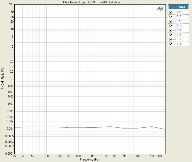

Oppo BDP-93 (left pic) and BDP-95 (right pic) Distortion vs Frequency

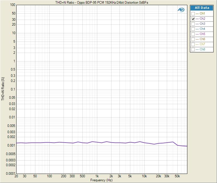

With all speakers set to "large" we used a 0dBFS 96kHz/ 24 bit 8 channel PCM test signal to measure distortion vs frequency response which was commendably low on both players.  CH7 is the subwoofer channel which measured slightly higher distortion on both players compared to the seven main channels.  The BDP-93 THD+N was measured to be 0.003% THD+N rising up to 0.01% at 44kHz.  The Oppo BDP-95 in comparison was ruler flat at 0.0015% THD+N all the way up to 44kHz.
Repeating these tests using a -20dBFS 96KHz/24 bit 8 channel Dolby TrueHD test signal, the Oppo BDP-93 measured ruler flat distortion of 0.03% for all seven main channels and 0.05% for the subwoofer channel while the BDP-95 measured 0.01% THD+N for the seven main channels and 0.02% THD+N for the subwoofer channel.

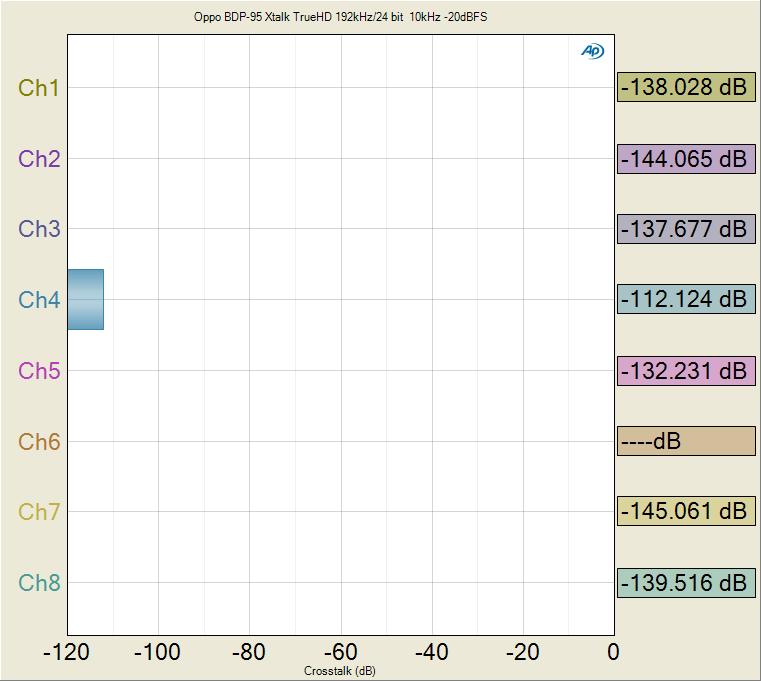

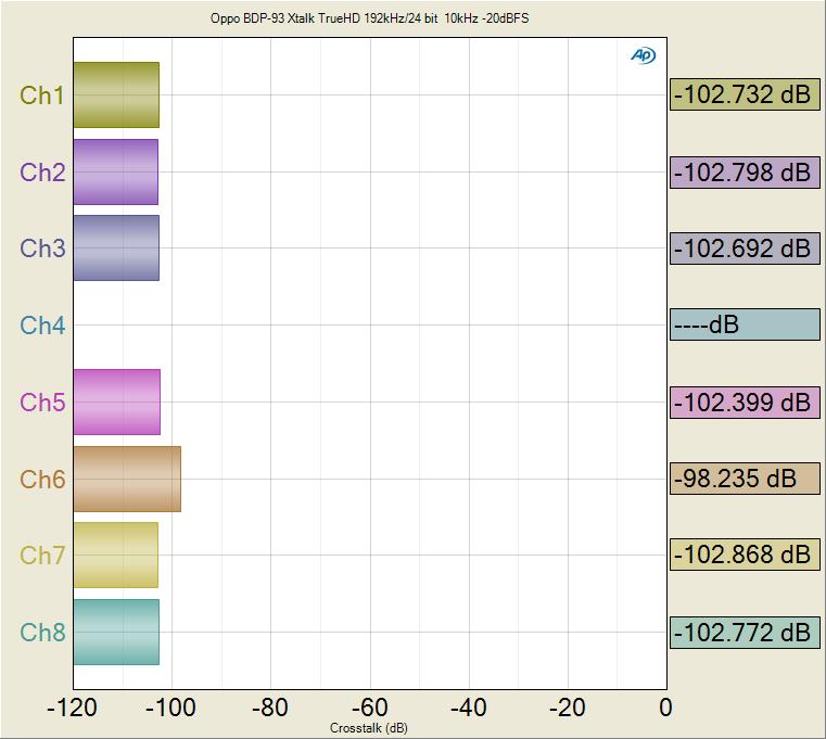

 BDP93 Xtalk  BDP95 Xtalk
Oppo BDP-93 (left) and BDP-95 (right) Channel to Channel Crosstalk
Using a -20dBFS 192kHz / 24 bit Dolby TrueHD test signal, we measured channel to channel crosstalk at 10kHz with all channels set to large and 0dB.  The Oppo BDP-93 produced excellent results (>100dB) which is better than you get with most high end preamps let alone Blu-ray players.  The BDP-95 defied all logic and produced #'s to the measurable limits of our test gear.  The audible differences with regards to crosstalk between these two players would be like trying to compare the loudness of a gnat's fart in loud New York City traffic if one listener was sitting in Florida and the other in Australia.

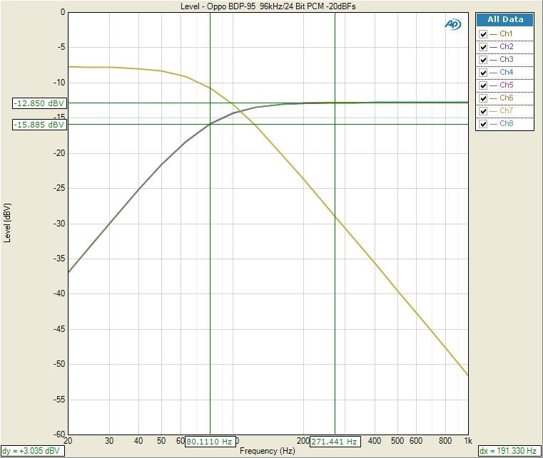

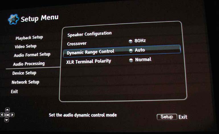

Setting all speakers to "small" and selecting 80Hz as our choice crossover point, we measured the analogue bass management capabilities of both players.  Unlike the Oppo BDP-83 model with a fixed 80Hz crossover point, the newer BDP-93/95 models offer variable crossover settings from 40-250Hz (20Hz increments from 40Hz to 80Hz, 10Hz increments from 80Hz to 120Hz, 50Hz increments from 150Hz to 250Hz).
BMGMT Xover  BGMT SPK
Oppo BDP-93 & BPD-95 Analog Bass Management System
BDP95 Bass MGMT
Oppo BDP-93 & BPD-95 Analog Bass Management Measurements

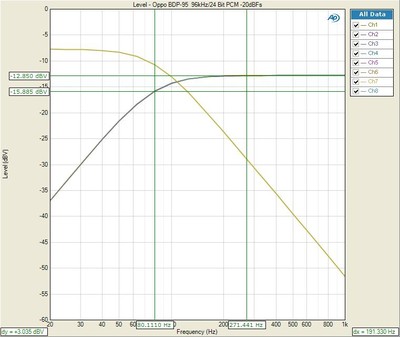

We measured the filter slopes using a -20dBFS 96kHz / 24 bit PCM test signal.  Setting the crossover to 80Hz, we in fact measured an 80Hz -3dB point for the HPF and LPF with a 12dB/octave slope.  We personally prefer to see a 24dB/octave slope for the LPF like THX recommends, but Oppo said their goal was to meet the minimum Dolby requirement of at least a 1st order filter (6dB/octave) for the HPF and at least a 2nd order filter (12dB/octave) for the LPF.  Considering THX informed us they don't even test the analogue outputs of Blu-ray players, we are just picking nits here.
