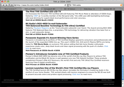

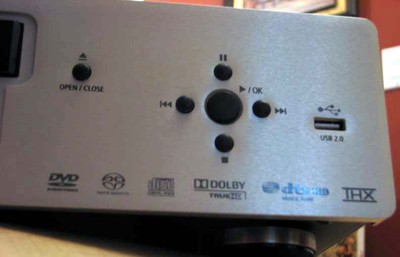

We first had an inkling that the Lexicon BD-30 was in fact an Oppo clone when we saw it at the 2009 CEDIA Expo in Atlanta. Looking at the player, its button layout and, most importantly, its rear panel, showed us that this product had the exact same layout as the Oppo BDP-83 Blu-ray player. What we didn't know, was how much technology they borrowed or how they repackaged the technology. According to the reps at the show, Lexicon had merely taken components of that player and tweaked them to make it their own - adding technology and making improvements to what was a good basic building block.

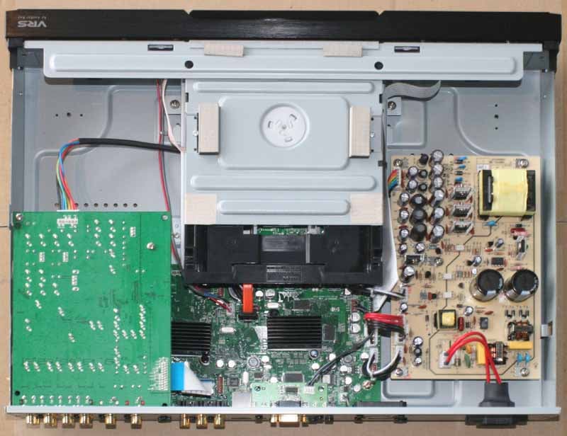

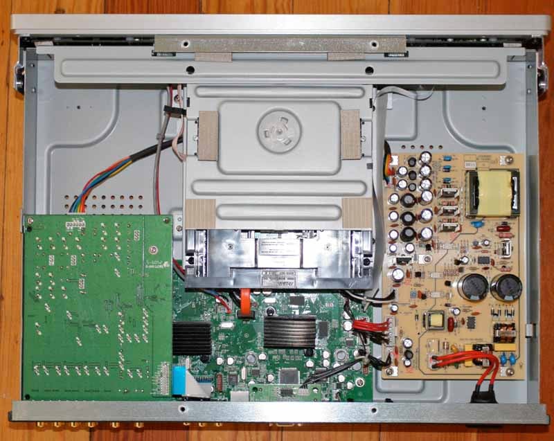

What a load of hogwash. When we received the player the first thing we did was open it up to get a look at the inside. Imagine my surprise when I found that not only did the Lexicon share the same boards and transport as the Oppo - it was in fact AN OPPO BDP-83 PLAYER, CHASSIS AND ALL, SHOVED INSIDE AN ALUMINUM LEXICON WRAPPER. As far as we could determine, Lexicon didn't change a single thing in terms of the hardware. Heck, they didn't even lift the boards out of the chassis, opting instead to cut out the bottom of their own chassis to accommodate the venting locations, and putting a darker blue filter over the Oppo's VFD display to give it a slightly deeper hue.
Don't take our word for it, however, check out these pics (click on them for larger images):
BD-30 inside BDP-83 inside
Lexicon BD-30 on the left, and the Oppo BDP-83 on the right.
Notice the identical extrusions on the bottom and the venting of both players. The reason they are identical is because the entire BDP-83 chassis is sitting INSIDE the Lexicon BD-30 player. Even the mechanical dampening is the same, as are all wiring and capacitor values and tolerances. Lexicon merely took off the backside so it could fit the connectors flush to its own back plate, and placed a billet aluminum faceplate that sits over the existing Oppo button and VFD hardware.

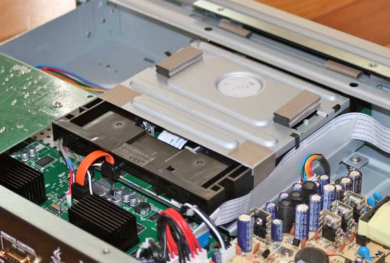

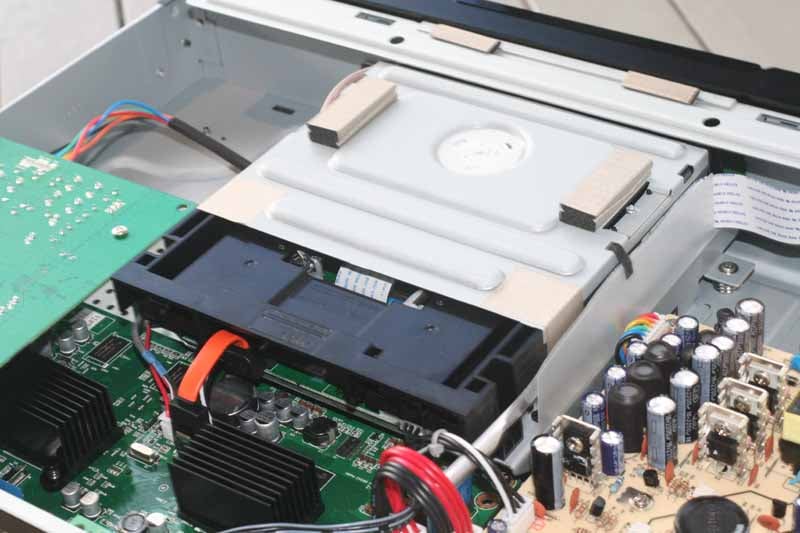

BD-30 interior angled 1 BDP-83 interior angled 1
Lexicon BD-30 on the left, and the Oppo BDP-83 on the right. Same transport, same caps, same anti-vibration material, same CHASSIS

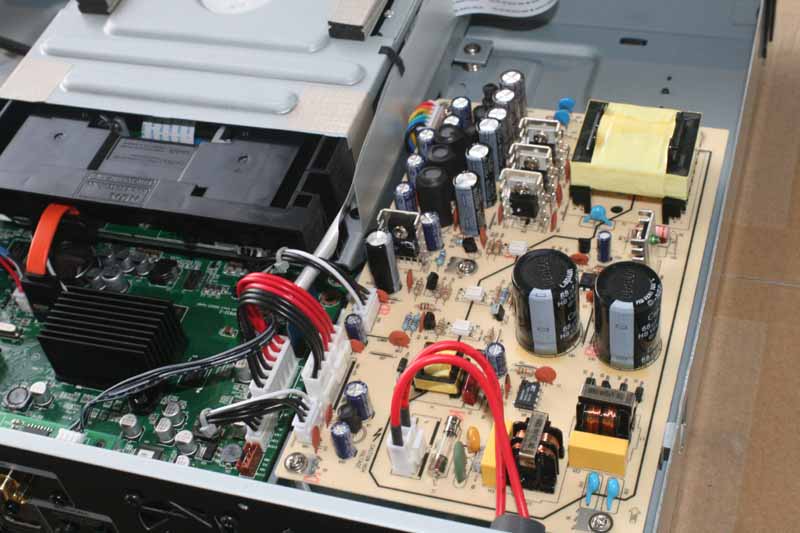

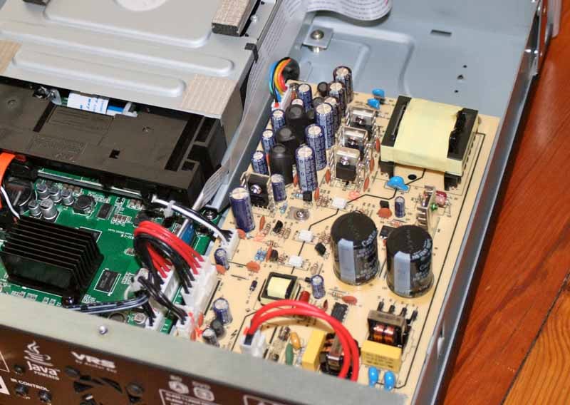

Wanting to do due diligence, Gene DellaSala made me take apart the Lexicon BD-30 after the fact (for the third time) to verify the cap rating, since we noticed a color discrepancy on the two players with a series of three caps on the power supply board. After taking a close look, we verified that both sets of caps are indeed 2200uF 16V caps with a rating of 40-105 degrees C. We have no reason to believe the discrepancy isn't simply due to the fact that my Oppo BDP-83 player, being from an earlier run, used capacitors from a different batch or manufacturer, but at the same specs and rating as those used by current models.

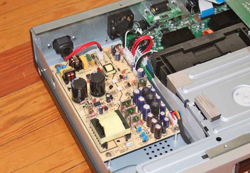

BD-30 PSU BDP-83 PSU
Lexicon BD-30 on the left, and the Oppo BDP-83 on the right. Not a single improvement to the power supply could be found

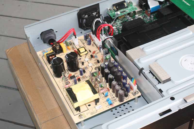

 BD-30 PSU2 BDP-83 PSU2
Lexicon BD-30 on the left, and the Oppo BDP-83 on the right. The more you look, the more amazing it becomes. This is a $3000 chassis.

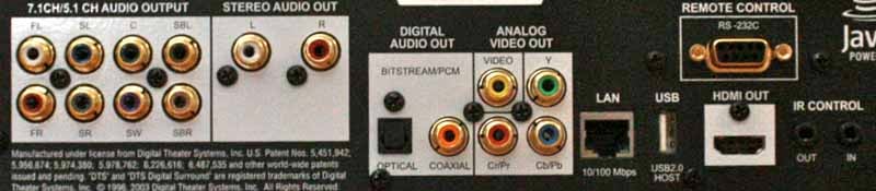

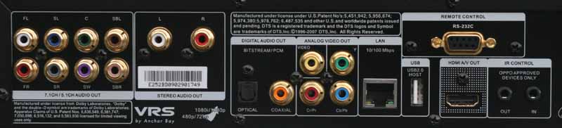

And the back of the player, of course, sports exactly the same connections on both players, since Lexicon simply used the Oppo's back panel as a template and manufactured its own to meet the height requirements of fitting the Oppo inside.
BD-30 connections
Lexicon BD-30 connections
BDP-83 connections
Oppo BDP-83 connections

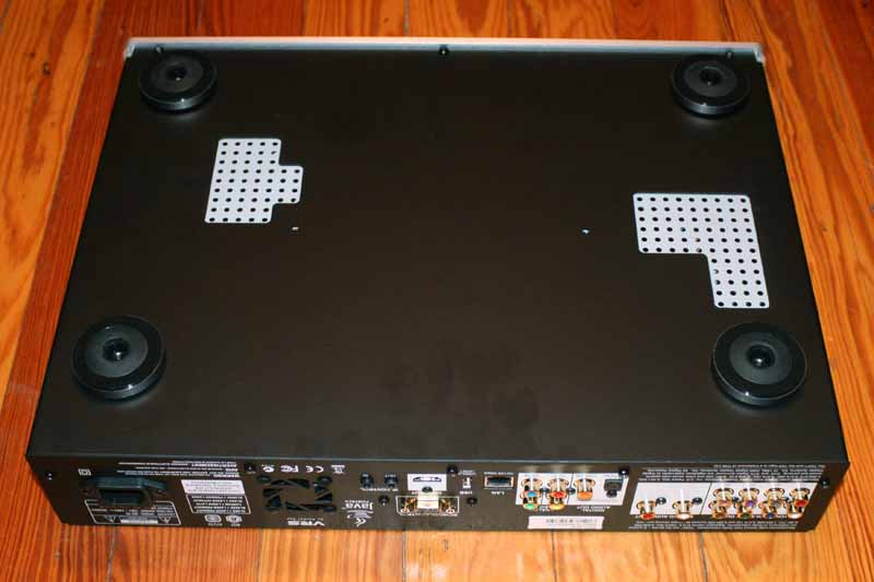

BD-30 underside
The belly of the Lexicon BD-30
Possibly the funniest shot was the one we took of the bottom of the Lexicon BD-30 Blu-ray player. Here you can see that they literally cut out the aluminum bottom to make space for the vent holes of the Oppo's chassis. If you didn't "get" that Lexicon actually put a full Oppo BDP-83 INSIDE of a chassis, slapped a label on it and is shipping it for $3000 more, this photo should help. Of course, they did add a Lexicon splash screen to the menu system (which, by the way, is identical to the Oppo except that some items are reordered) and a billet aluminum faceplate is certainly nice.

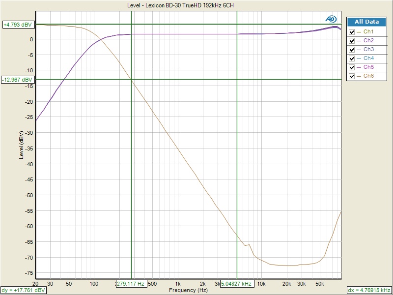

One of the staples behind THX certification has always been to maintain an 80Hz crossover point on all THX certified electronics.  As we measured prior, the Oppo BDP-83 did not meet this requirement which wasn't really a huge deal since it wasn't THX certified.  We were interested however in measuring the Lexicon BD-30 which was THX certified to see if Lexicon fixed this design deficiency and if THX even tested for it.
 Oppo BDP-83 Bass MGMT  Bass MGMT BD-30 Cor
 Bass Management Frequency Response
Oppo BDP 83 (left graph) and Lexicon BD-30 (right graph)
   LPF   HPF
fc Slope fc Slope
Oppo BDP-83 143 Hz 18 dB/ Oct 90 Hz 13 dB / Oct
Lexicon BD-30 140 Hz 18 dB / Oct 88 Hz 14 dB / Oct
THX Spec 80 Hz 24 dB / Oct 80 Hz 12 dB / Oct
Bass Management Tabulated Test Results
An ideal THX certified product should exhibit a -3dB rolloff at 80Hz with a 12dB/octave slope for the High Pass Filter (HPF) and a -6dB rolloff at 80Hz with a 24dB/octave slope on the Low Pass Filter (LPF).  As you can see, neither the Oppo NOR the Lexicon players meet this requirement and they actually measure identically to each other. The slight tabulated variance is a function of cursor interpretation error on the graphs combined with measurement variances caused by component tolerances.  Based on our findings we can unofficially (but in practicality) state that the Oppo BDP-83 is (or might as well be) THX certified despite the bass management doesn't meet their 80Hz 12 dB/octave HPF and 24dB/octave LPF requirements.

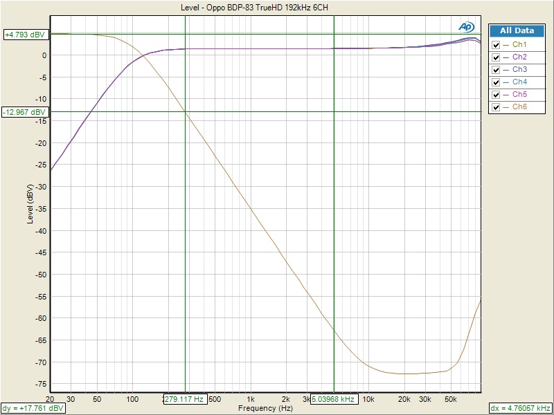

Frequency Response

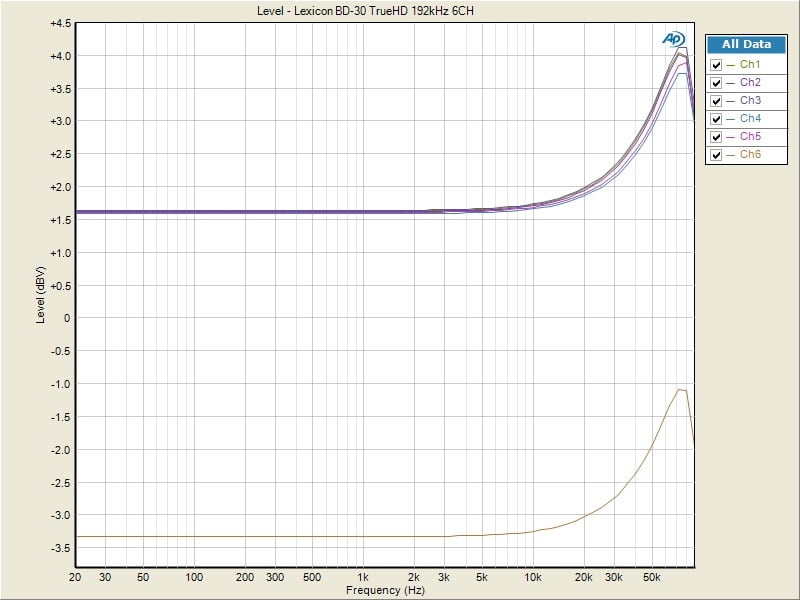

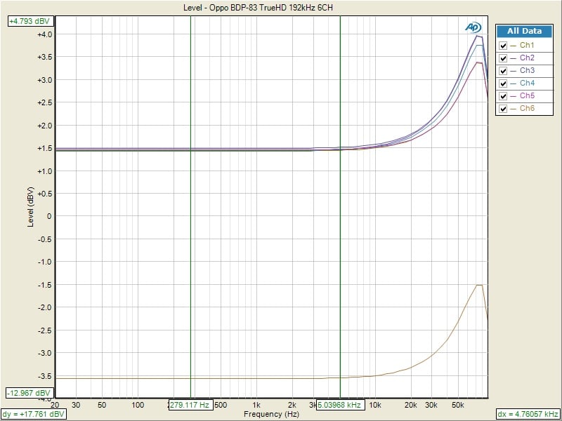

We previously measured a 2.5dB bump above 20kHz on the Oppo BDP-83 when running all channels full range and using a 192kHz Dolby TrueHD test signal.  We were curious to see if the Lexicon exhibited similar peculiar behavior.
Oppo BDP-83 Freq Peak  Level BD-30
Analog Fullrange Frequency Response
As you can, see both players exhibit the same frequency peaking above 20 kHz.  Incidentally, both players also produce a full range signal via the subwoofer output channel which Oppo deliberately did to accommodate users playing Chesky 6.0 DVD-Audio discs that require a full range subwoofer channel.  Although THX doesn't disclose the type of testing they do, we have a hard time believing the frequency response non-linearity we measured above 20kHz would fit within their acceptable performance window.

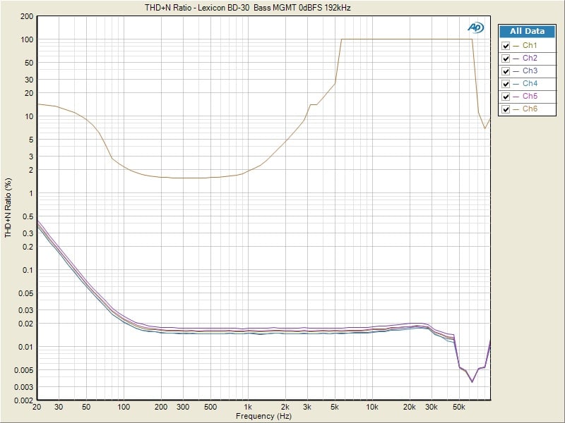

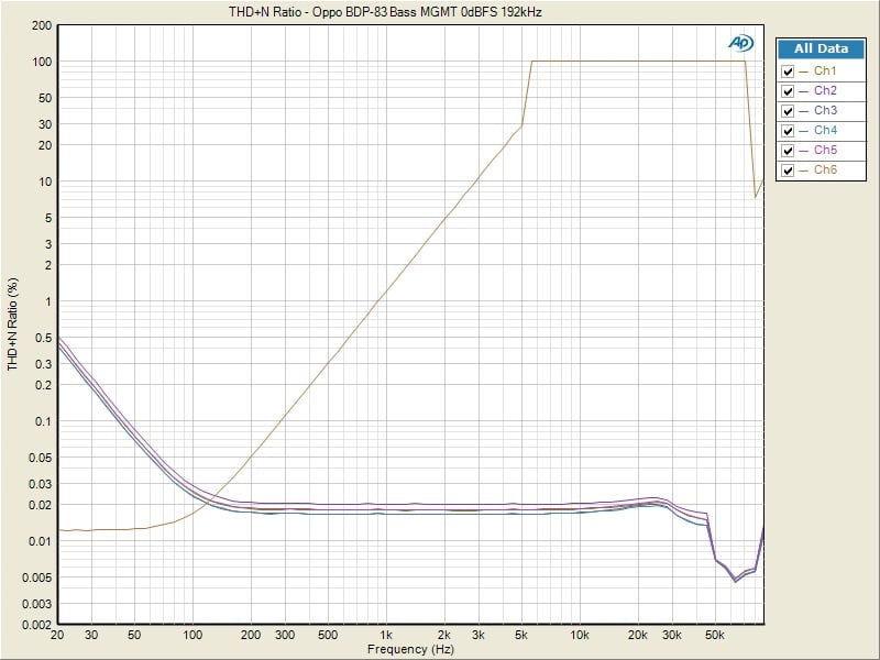

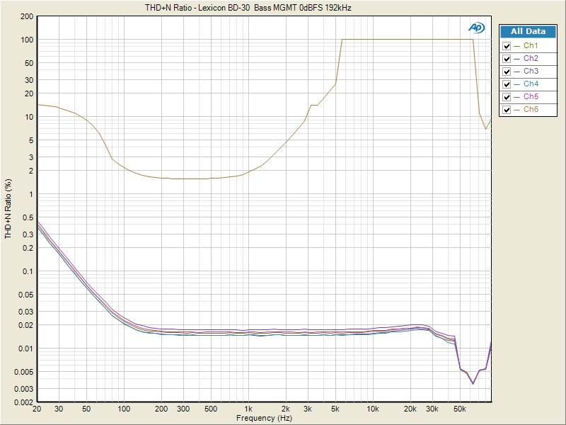

Distortion (THD + N)
Oppo BDP-83 Dist  Lex Dist BD-30
Distortion (THD + N) vs Frequency
Both players exhibited virtually identical and excellent distortion measurements for the main channels. When I originally bench tested the Lexicon BD-30, I restricted my tests to the two main channels plus the subwoofer to quickly identify if there were any differences.  There of course weren't any so we wrapped up this article indicating that both players appeared to be identical in terms of audio performance.
On January 17th, 2010, a contributing editor of Widescreen Review named Amir correctly pointed out I should check all of the channels to ensure there were no differences.  Since I only tested 6 channels in the Oppo, I repeated my test of the Lexicon with the six same channels.  To my surprise I found the subwoofer channel went into gross distortion on the Lexicon BD-30.  It took me several hours to realize this was a result of setting any channels but the main front channels to "small".  Apparently there is a bass management recombination issue with the Lexicon that doesn't exist with the Oppo since the Oppo receives numerous firmware updates to address such issues.  To our knowledge,  Lexicon has yet to offer any firmware updates for their player to address such issues.  Thus at this time I must correct our previous statement that both players are identical and now state that the Oppo actually fairs better than the Lexicon when using the analog audio outputs and bass management facilities under the current firmware Lexicon supports their BD-30 player.
If THX tested the analog outputs this would have never been the case hence why its our opinion that the THX certification should also support their certified legacy devices and connection methods.
