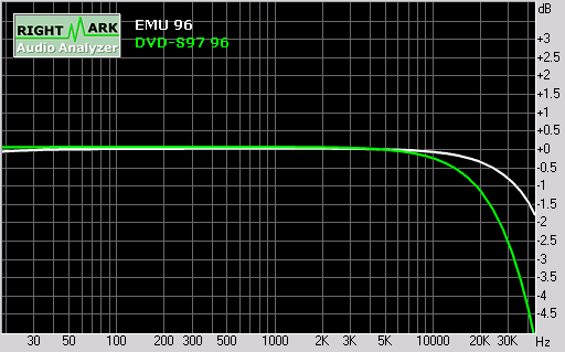

The frequency response graph indicates the player has a low pass filter that is down -1dB at 20 kHz, but is very flat for low frequencies. This filter is to compensate for ultrasonic noise generated by the DAC:

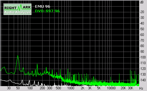

Looking at the noise level, the DVD-S97 has a noise floor that is mainly concentrated at below 1kHz, with the most significant contributor being residual 50Hz (fundamental plus harmonics) from the power supply. In addition, there are several significant spikes clustered at around 30kHz, plus another set around 1-3kHz:
In comparison, the multi-channel front left/right outputs appear significantly noisier around 30kHz.

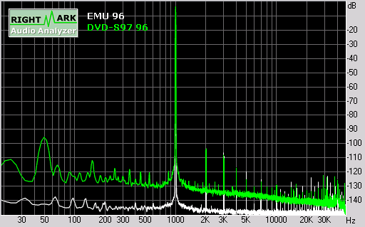

This is the graph comparing the outputs in response to a 1kHz tone at -60dB:

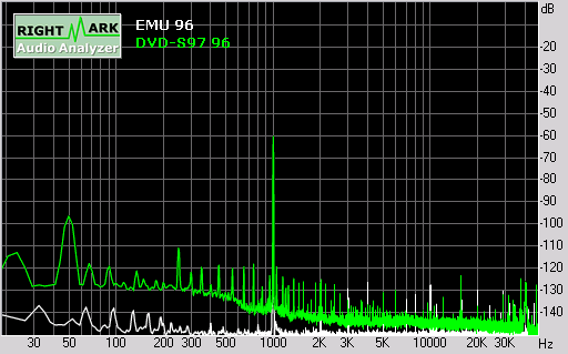

And this graph shows THD+N (at -3dB FS):

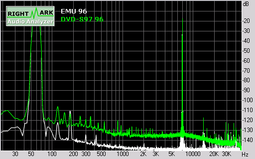

Intermodulation distortion for a standard 60+7000 Hz signal:

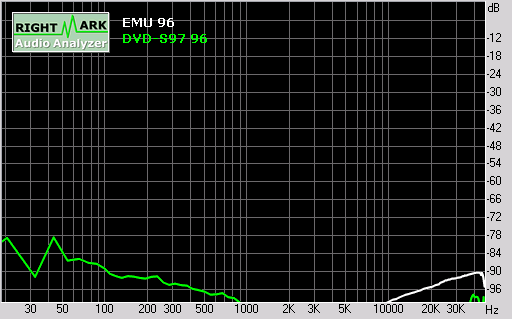

As can be seen, stereo crosstalk is focused below 1kHz (consistent with the noise floor):
Intermodulation distortion rises with frequency from around -90dB to -66dB (at 48kHz), but these are still acceptable:
