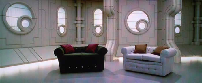

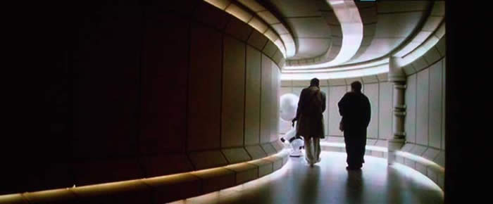

DVD: Hitchhiker's Guide to the Galaxy
Hitchhiker's Guide to the Galaxy offered a wealth of material with which to check the visual quality of the Oppo player in a real-world home theater environment. There were plenty of scenes with difficult deinterlacing combined with moving on-screen elements. Noise reduction was possibly the area in which I would desire some improvement as this film has some very "dirty" looking scenes that could have come out looking a bit more refined. Still, I found that it reproduced the myriad of textures, colors and luminance values present in this DVD with grace. Detail on the Jim Henson creatures was impeccable at times, with fine hair and clothing accents making this a very fun movie to watch - this despite its disappointment as a screenplay adaptation of what I consider to be some of the best sardonic literature ever written. Paying attention to the many instances of black space and bleak environments (both on-ship and on-planet) I noticed that the Oppo consistently avoided banding, though macroblocking was apparent after the correct video levels were set.

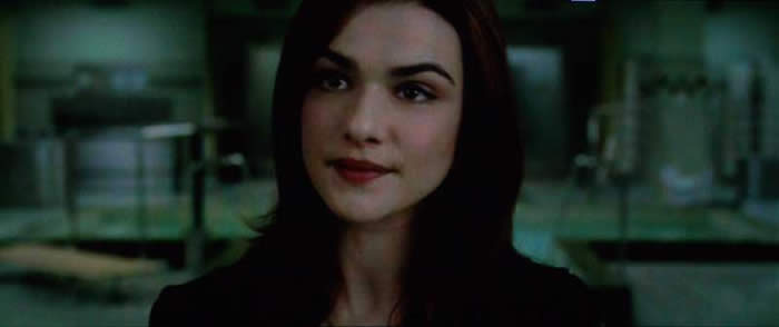

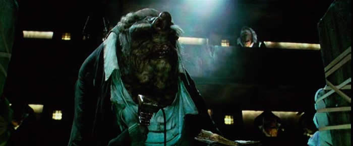

DVD: Constantine
No, it's not an epic movie about a third century Roman Emperor... Constantine is done in the (seemingly endless?) style of comic book-turned-movie franchises which pepper the audience with dark, dimly lit scenes periodically erupted by peaks of action and explosions. I chose this disc, not for its great cinematic qualities - but to check out how well the Oppo did in low luminance level situations. What I found was that, while the Oppo passes blacker than black signals (and this DVD had quite a bit of very dark content) it tended to crush the blacks a bit more than my DVD-3910 reference player. Since there was no way to adjust gamma on the player, this condition was a consistent issue during dark scenes. For people who don't adjust the brightness on the player this could be a real problem. The picture in Constantine was not as noisy as the previous movie and so I didn't see too many occurrences of noise that detracted from the viewing experience. There was quite a bit of motion in this disc, which gave the Oppo OPDV971H a chance to show off its motion adaptive deinterlacing ability along with a consistent color representation that didn't seem to falter (lose bit depth) during action-heavy scenes.
