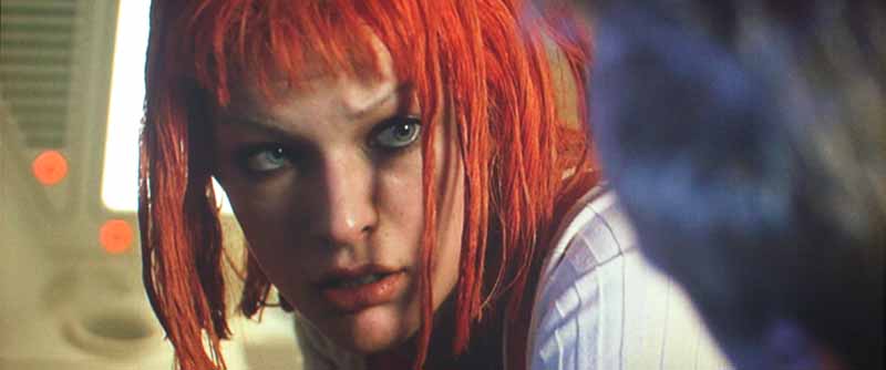

DVD: The Fifth Element (Superbit)

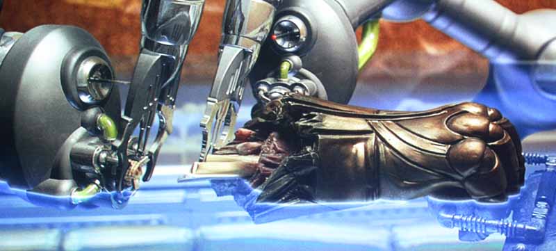

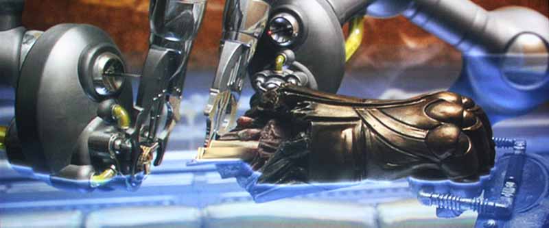

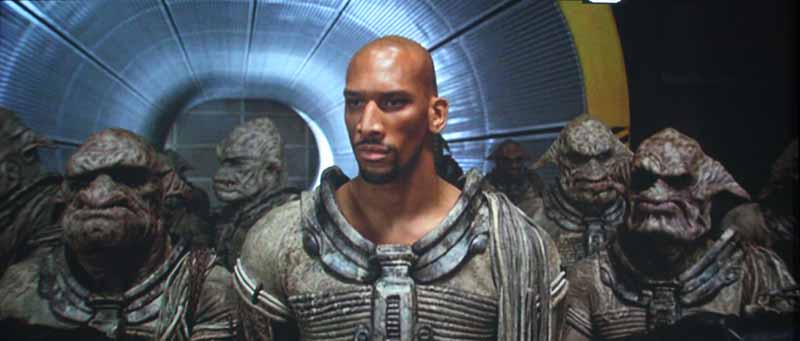

DVD-fifth-element.jpgYou're going to see a lot of this movie in any display or video source component review I do. It's simply a great title and represents some of the best picture quality in both the DVD and Blu-ray formats. We weren't surprised by anything we saw and found the DV-983H to put forth a great picture with no perceivable artifacts or jaggies anywhere in the common areas we check. Faces had all of the skin textures you could want, and the clothing and backgrounds which abounded in this film had a very realistic look and feel that seemed to pop off the screen if you looked closely. You know your detail is exceptional when you begin to see things like reflections in eyes and are able to take note and begin identifying some of the various materials used to make the props in the film.

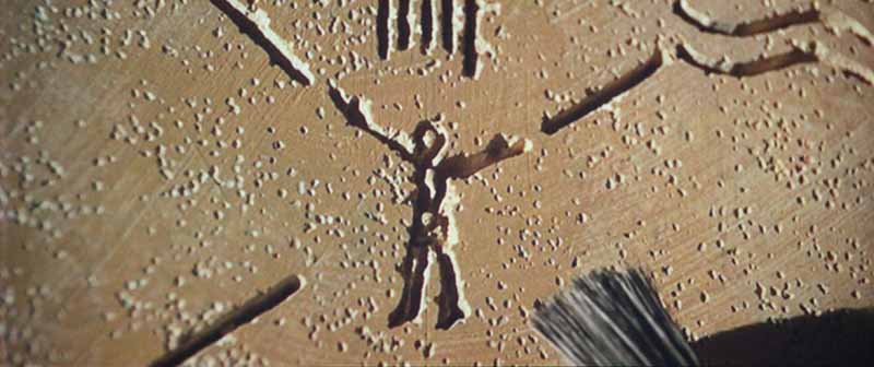

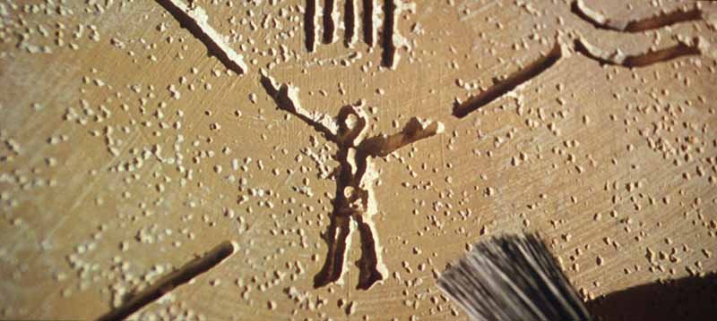

What we did find interesting was to host a quick comparison of the Oppo DV-983H against the same title, only in Blu-ray format. A lot of people don't understand the fascination with Blu-ray and its increased resolution. There's a good reason for this: it's often hard to appreciate a significant difference when you sit back and have a good DVD player at your disposal. We snapped several pictures to illustrate Blu-ray vs. DVD expecting to show a vast difference. In all honesty, there WAS a difference, but the camera (much like our eye) rendered the results extremely similar from 11 feet away.
DVD Clip1 via Oppo DV-983H
BD Fifth Element 1
Blu-ray Clip1 via Playstation 3
BD Fifth Element 2
Blu-ray Clip1 via Oppo DV-983H - not much different when viewed from an appropriate distance
The next time you're in a store and marvel at the quality of Blu-ray - take about 7 or so steps back to your typical sitting distance and see if it's that much more amazing than a really good DVD player. We think it's definitely a step up in terms of quality, but we've also found that there are many things that affect whether HD is a big deal. This includes the quality of the source player, the resolution of the display, the distance you sit form the TV, and the actual movie content you are watching.

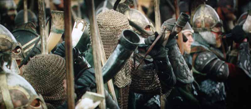

DVD: Lord of the Rings - Return of the King

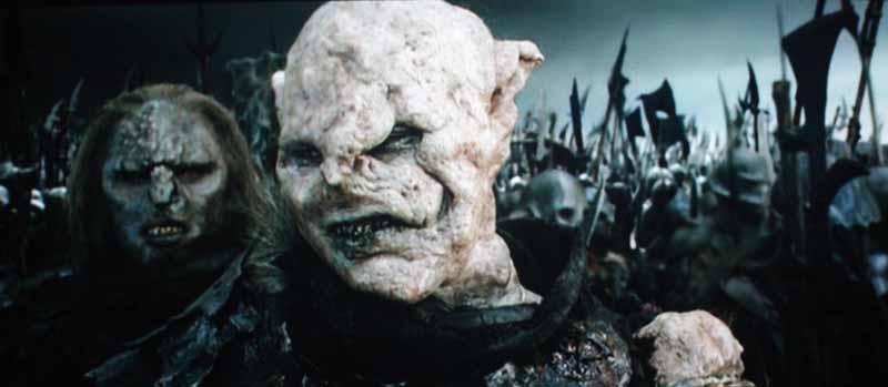

DVD-return-king.jpgThis movie continues to be an incredible film, though a tad muted in the area of color. What it does well is present a fully dynamic picture whose histogram (black to white levels) is incredibly rich and, assuming a worthy display, is capable of separating the average players from the top performers. The Oppo did a really good job of bringing to life every nuance that was in this third installment of the Lord of the Rings trilogy. We've seen players only barely carry through detail, so that everything appears smoothed and washed out. Some players cannot handle the articulate detail present in on-screen elements like chain mail or detailed crests and emblems. During this film, which had ample of each, the DV-983H never broke into a moiré pattern or blurred details which were present in the digital video stream. Take a look at some of these shots:
Move that chain mail across the screen on a Wal-mart special and see if it holds together!
How someone so ugly can look so good is beyond me…

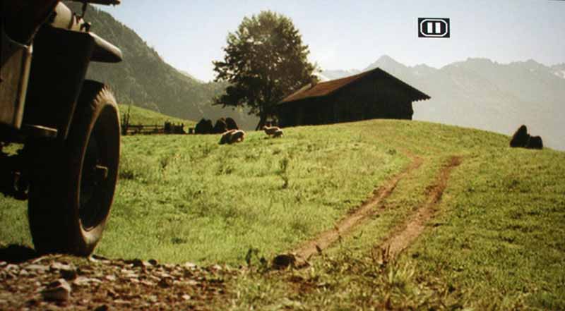

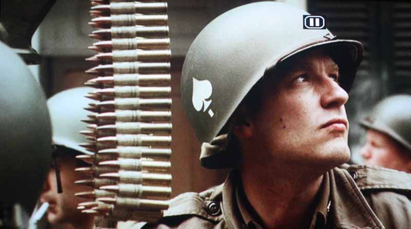

DVD-band-brothers.jpgThis epic World War II film series takes you through a roller coaster of emotion and scenery as Easy Company travels around Europe fighting off the Nazis. I found the various landscapes fascinating in that they captured the full range of textures and fast-moving imagery that makes for such great viewing material. One thing this picture isn't is "crisp". They instead opted for a smoother, grainer "old-school" film-like picture and so we mostly counted on the vast array of angles, granular landscaping and rugged equipment and uniforms to challenge the player to new levels. From the pics below, you'll see that the very natural look of the film was perfectly displayed and preserved and the Oppo didn't artificially attempt to sharpen it up or eliminate the natural picture noise which gave Band of Brothers its look and feel.
