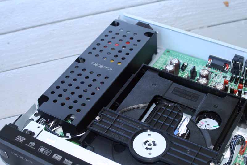

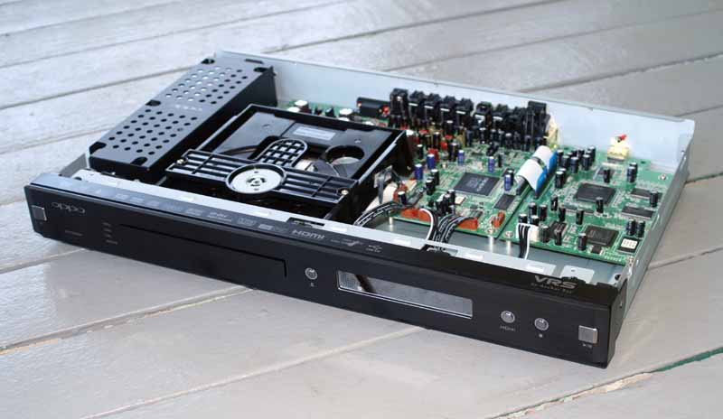

DV983H-inside-PSU.jpgOpening up the unit (my favorite part), I saw that Oppo had been careful to physically shield the power supply from the rest of the components. They also located the circuit boards to the back of the chassis, separating them as much as possible from the VFD. It was nice to see that Oppo didn't succumb to the forces of darkness and place its electronics into a chassis that was grossly oversized in order to make the unit appear more "elite". They simply packaged the DV-983H into the same sized box they have used for their other models but gave it a nicely upgraded thick aluminum face. It's honest and it works.

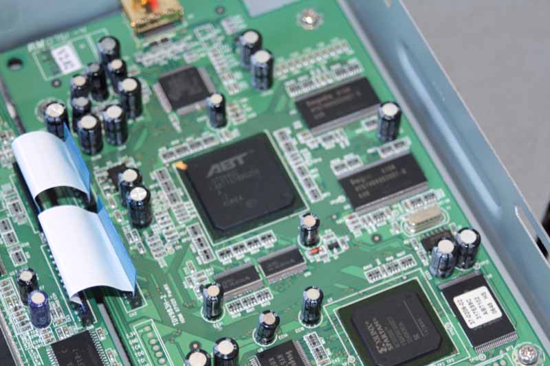

DV983H-inside-ABT.jpgIt takes two chipsets to make up the ABT-based system Oppo is using for the DV-983H. The Xilinx SPARTAN chip handles de-interlacing standard definition video, removing chroma artifacts and detecting the need for 2-3 pulldown. The ABT1018 chip handles video scaling up to 1080p, including frame rate conversion, aspect ratio control and adding video zooming features. Oppo did not, or could not, implement 24p output due to the methods they used to arrange the video processing on their board. ABT has long been highly regarded in its standard definition capabilities and is, in fact, one of several very competent processors available today. In fact, it's used by Denon, Yamaha, and a host of other manufacturers. For whatever reason (more detail is given below) Oppo opted to not successfully implement ABT's renowned Mosquito Noise Reduction circuitry in this player.
