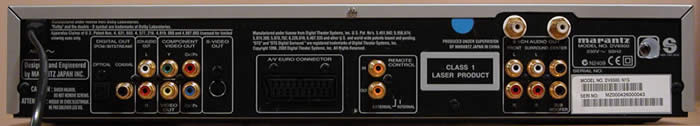

The rear of the player features standard connections, including both optical and co-axial digital outs (no Firewire), analogue 2-ch and 5.1-ch outputs, plus composite, S-video, component video and SCART connectors (no HDMI or DVI). There are also Remote In/Out jacks and a switch for selecting between internal/external remote control. Finally, JLTi has installed an additional set of 2ch analogue outputs (prototype unit only) from the new audio stage, using high quality RCA sockets.
