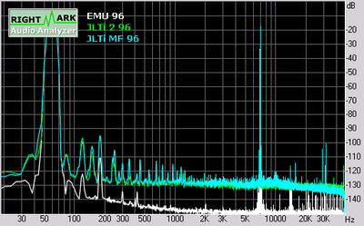

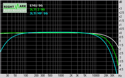

  • Poor progressive scan implementation (not motion adaptive, no film mode detection, chroma upsampling error, and overly soft image quality)
  • Poor measured audio results (low and high frequency attenuation, reduced output level, high intermodulation distortion above 1kHz, and clipping on 0dBFS+ levels)
  • High quality output on 2-channel only
