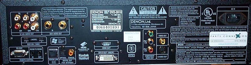

Denon-DVD-3910-rear.jpgThe rear panel has a host of connectors. Separate 5.1 and 2 channel jacks furnish analog audio output. In the modded unit the 2-channel jacks are upgraded, though there are options to upgrade the rest. Digital audio outputs are available thru one coax, one toslink, one 'DENON LINK' and two IEEE 1394 firewire jacks. System control connections provided thru one RS-232C and in/out jacks for wired remotes. Analog video connections are thru one composite, one s-video and one set of component jacks. Digital video outputs are a 24P DVI-D and HDMI jacks, the HDMI jack outputs audio and video digitally and I really hope to see this soon become the standard for digital interconnects in all consumer electronics. And I almost forgot, there also is an IEC AC receptacle. From a connectivity and functionality perspective, this unit certainly gets my highest accolades, other than the remote control.
