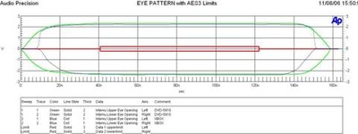

I also threw up a digital Eye pattern to see just how well the digital signals of the DVD players were transmitting. The Red line shows the AES3 limits as per standard. A CD/DVD player must be able to produce an eye pattern via its SPDIF outputs outside the vertical limits of the red box in order to properly transmit the signal. The Eye pattern (green - represents the DVD-5910CI, Blue - represents the XBOX) should follow a similar shape to the red AES pattern. In the real world you will never have a perfect rectangular shaped eye pattern as per AES3 but the more box like it is, the less bandwidth roll off and jitter the interface will suffer from. As you can see, both players meet the AES3 standard just fine, but the DVD-5910CI's eye pattern is superior to that of the XBOX (no surprise there). For skeptics thinking all digital outputs are created equally, think again! It's clear as to why the DVD-5910CI exhibited such a low noise floor. Aside from its excellent component usage and layout, the player was carefully designed for the lowest amount of jitter possible making it a robust design that will work flawlessly with any processor/receiver. Bravo!
