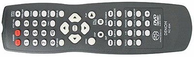

Remote Control Interface
The remote control included with the DVD-5900 is essentially the same as the one found on Denon's lower model DVD-2900. I would have preferred having a joystick like interface rather four arrow pads and an 'Enter' button. I find a joystick to be easier to navigate and less cumbersome in operation. For a $2000 DVD Player, it would have been nice to have had a backlit joystick type remote.
