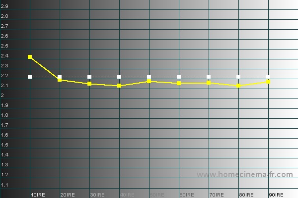

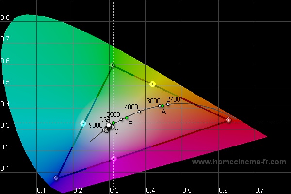

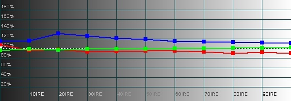

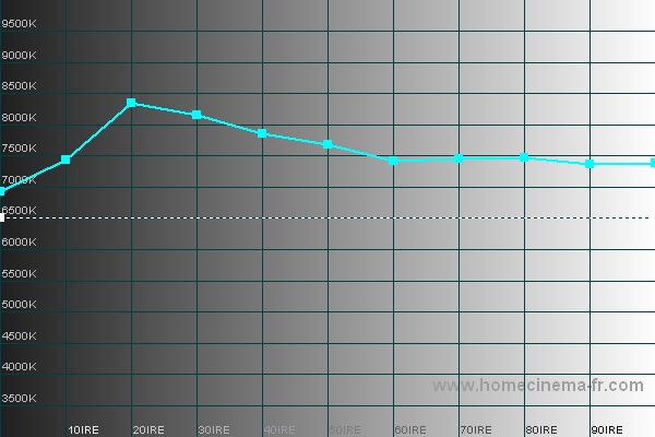

CIE (left); RBG Levels (right)
Color Temp (left); Gamma (right)
It's not all that surprising that you'd want to use a different brightness setting depending on the lighting conditions in your room. What we usually suggest is that you use the Movie mode for your nighttime viewing and adjust one of the other settings for your daytime viewing. Unfortunately, you don't have a lot of control over the calibration of this display (meaning you'll have to call someone to get into the service menus for you to make those adjustments) so you can't do that. Your only real option is to remember to adjust the brightness for each lighting condition or to live with one of the washed out, bluish, and overly-bright Standard or Dynamic settings for daytime viewing. What I did was to live with the Dynamic setting after bumping the brightness way down and engaged the DNIe setting (which I felt gave a bit better saturation to the colors and blacks as well as counteracted some of the blue). It wasn't as good as changing the brightness on the Movie mode on Warm2, but it was easier and I tended to fiddle with it less (lowering considerably the amount of family tension in the house).
