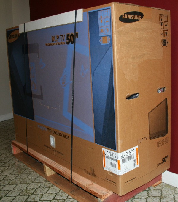

HL-T5087S_inbox.JPGI've reviewed a number of flat panel LCD and Plasma displays from 42 to 50 inches and I can tell you this - moving the Samsung HT-T5087S was a joy in comparison. At only 63 lbs, I could easily lift it and place it on my component cabinet. I wouldn't recommend it, but I could do it. It was well-packaged (strapped down to its own half pallet, no less) with the appropriate amount of protection. I prefer to see these displays double-boxed, but for all intents and purposes, it's probably a useless gesture. What exactly is that one extra layer of cardboard supposed to do anyway?

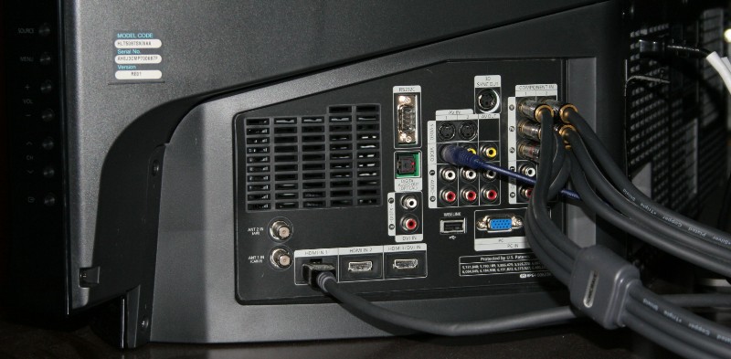

My first impressions were all very positive with the huge flat screen bordered by an impossibly thin edge and the trademarked Samsung logo and power button on the bottom-center of the unit. The little cut out just below that serves not only as a place to reflect the accent light, but also the sound from the speakers. The right side of the unit has all the inputs and outputs with the removable power cord located just around the corner on the rear of the unit. The HL-T5087S has two full HDMI inputs and one HDMI/DVI input (made to be used with a DVI source - also has analogue audio inputs), 2 component video and analogue audio inputs, 2 composite video and analogue inputs, and one composite output with analogue and optical audio outputs. You should be set for connections except that there is no way to get audio to the unit digitally except through the HDMI inputs. I'd like to see a coax or TOSLink input as well.
HL-T5087S_input.JPGNow, if you want to connect up a PC, they've also got you covered with a VGA input and an audio jack. RS-232C is present as is a USB input for portable media such as MP3 files (man, does EVERYTHING play MP3's these days?) and jpegs and movies. Personally, the USB would do better on the front of the unit as many installations are looking to hide the majority of the display, making the side less than accessible. A little door would make it all but invisible.

If you've set up one display you've set them all up - at least as far as connections go. I ran a single HDMI from my receiver to the HL-T5087S, a pair of component cables (for my Xbox 360 and from the Denon DVD-3910), and a composite cable from the receiver "just in case". Hey, don't mock it. In my business, you can always count on that composite to work when everything else fails (thank you, HDMI). Everything on the panel is well laid out and separated so you shouldn't have much of a problem. I wouldn't mind seeing the outputs separated from the inputs (they are mixed in currently) though this is really a minor gripe.
