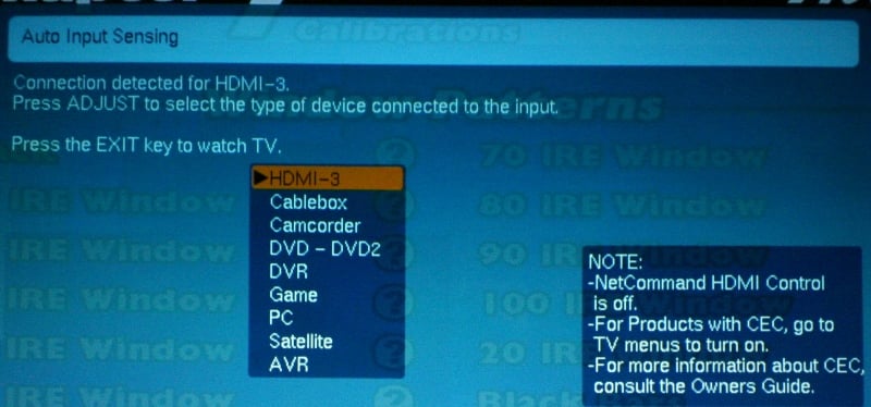

Mits_Menu_AutoInput.JPGOnce you power the unit on, it immediately recognizes every input that you are using. I had already wired up most of my components with Impact Acoustics cables so I was taken to a screen that asks you to name each of the inputs (you can pick from a list rather than enter characters). The WD-73735 will do this every time you add an input. Later on, I moved my HDMI cable to one of the inputs (to make sure they worked) and the Mitsubishi immediately sent me to the naming screen again. The only real problem I had with this process is there was no "Select" button. Instead, once you found the name you wanted, you just hit "Exit" which is not nearly as intuitive as confirming your selection with a button press. You can rename (and reorder your inputs) from the menu system at any time. Overall, this was a very nice feature (if a bit clunky).

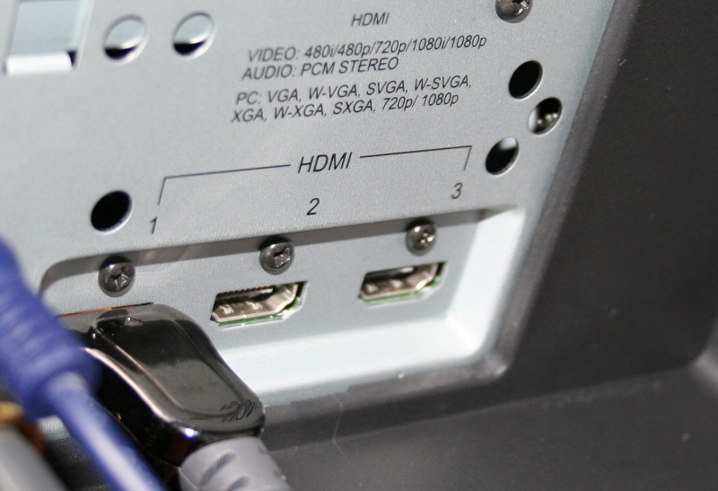

The input sensing of the WD-73735 really took just about all the stress out of setting up the display. The Denon AVR-2307CI didn't seem to want to play nice with the display which caused me to have to turn the display, receiver, DVD player, and cable box on and off until something finally synced up via HDMI. Once that happened, all the other sources worked as well. If I connected the source directly to the unit, I didn't have that problem. I figured out eventually that if I left the receiver on, I didn't have the problem any longer. Irritating, yes, but I blame HDMI and not Mitsubishi.

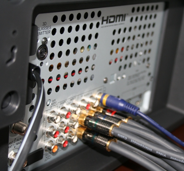

Mitsubishi is now on the list of manufacturers who apparently don't employ anyone with an Xbox 360. The only way to get 1080p out of a 360 is via Component cables. The WD-73735 will only accept up to 1080i via component. Be sure to change your resolution before you make this connection or you'll have to reach back there and flip that stupidly placed switch on the cable to reset everything to standard definition.

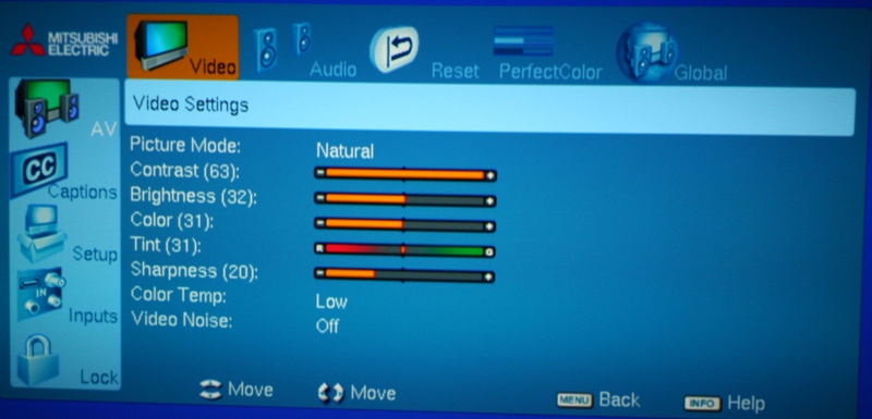

Video - The majority of your calibration will take place here. There are three picture modes (really four but Game is only available to inputs labeled Game or PC) entitled Brilliant, Bright, and Natural. Natural isn't the default for anything so you'll need to select it manually. There are controls for Contrast, Brightness, Color, Tint, and Sharpness. Color Temp is supposed to adjust the white balance and has two settings - High and Low. Video Noise is the WD-73735's noise reduction and has High, Medium, Low, and Off settings.

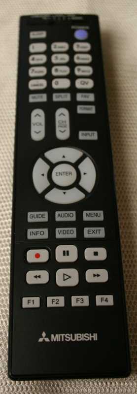

Mits_remote.JPGThe remote is black, simple, and partially backlit. There is a slider at the top to select your different devices (if you plan on using this as a universal remote) though this is not backlit at all. The only way to turn on the backlighting without controlling something is hitting the Enter key. Overall, I like this. It's better than trying to find the backlight button in the dark. As a remote, it is pretty plain but functional. The number keys do not light up so if you are using it to channel surf, it might not work well for you. My big problems were that the Input and Format buttons were too close. Format controls the aspect ratios (scrolls through with each button push) and the Input button brings up a menu to select which input to use. I often hit the wrong one. There is only the Input button and not individual buttons for each input. My other qualm is that the remote isn't very responsive… or it is too responsive. Often, I'd have to hit a button, wait, and then hit it again. I'd say the remote registered about 50% of the time. On the other hand, when I was making adjustments, I'd hold down a button and let it up as I got close to the proper setting just to see the display register 5 or 6 more button pushes. It wasn't so annoying that I wanted to break the remote with a hammer but I sure didn't feel like I had a quality piece of equipment in my hand.

I went to my friends house yesterday, he just got the 60" version of this same tv, and there is a digital coax output on the back. If you are facing the inputs, it's at the bottom left of everything.

I wonder if Tom did an oops. My set has a coax audio OUTPUT strictly for OTA.

I'm looking at the back of that display in the PDF and comparing it to the photo on Audioholics. Hehe...this is Audioholics not videoholics.
The PC inputs are the top two red/white RCA inputs just to the right of the orange coax digital out.
