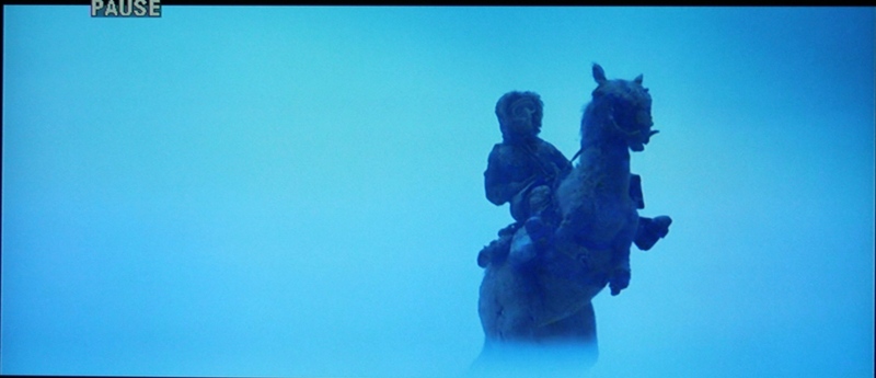

TX_Empire5.JPGOne of the most disappointing results of my measurements was the discovery that the display clipped whites and added a lot of artifacts to blacks (I tried to get a picture of the test screen but I couldn't get it to come out). Using the DVE Pro disc, I found that 95 and 100 IRE were indistinguishable from each other and that 5 IRE had a lot of visual artifacting. This means that any very light or dark scene is going to have no definition (light scenes) or lots of artifacting (dark scenes). Unfortunately, this wasn't one of those "only shows up in the measurements but doesn't affect real world performance" things. It was immediately noticeable with casual viewing. Lowering the backlighting (which was set inexplicably high for default Movie mode) helped with the artifacting but not much. I found the most obvious example of white clipping during a scene in The Empire Strikes Back. When Han goes out on a Tauntaun looking for Luke, it looks like the Tauntaun is standing in an amorphous field of white. Sure, handing your teacher a blank sheet of paper and calling it a white horse in a snowstorm might be funny, but I expect that ILM did a little more work than that. Based on previous viewings of this movie on different displays, I know they did.

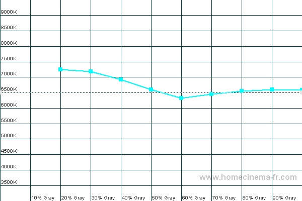

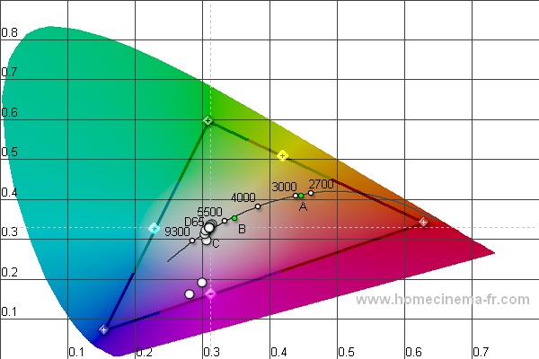

Color Temp (left); CIE (right)

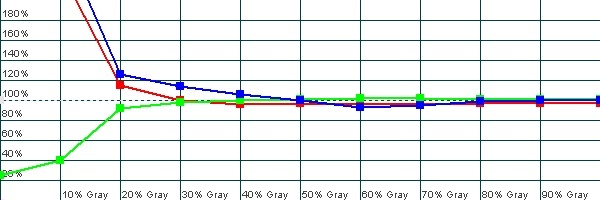

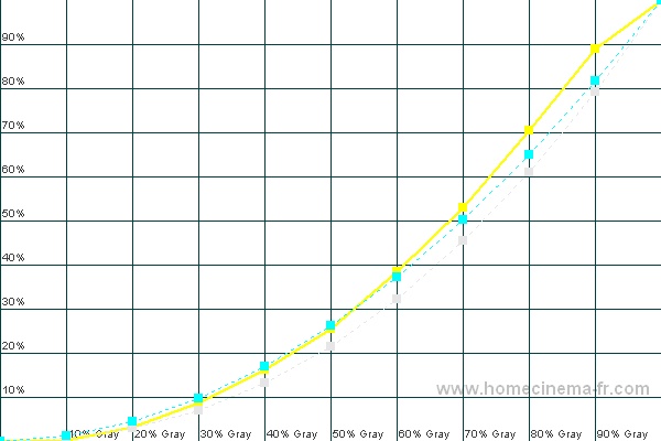

Luminance/Gamma (left); RGB (right)
As you can see, the RGB graph lines up nicely but without gain and cut scores, I couldn't get the Color Temp to get in line. Basically, I could push it up and down but the shape stayed the same. You can also notice on the Luminance graph where the clipping starts somewhere above 90 IRE. With a finer resolution, I'd bet we'd see exactly the point where it clips.
