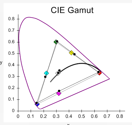

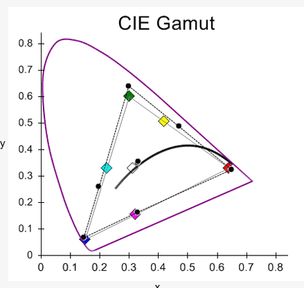

Color Reproduction - CIE Chart
The color primaries on the VF551XVT, in particular Green and Red, exceeded the boundaries of the reference CIE chart. While some manufacturers tout this as an asset, in reality it simply means that you are away from reference color and not reproducing what the colorist sees in the video mastering studio. That's not our goal. Our goal is to view reference material – and that's what we calibrate to, though on the Vizio those user-level calibration options are very limited. The before and after calibration charts show that through the user-level controls we were able to get our reference a little closer, though not nearly as close as if we had dedicated color controls for the primary and secondary colors.
CIE pre-cal CIA post-cal
The VF551XVT before calibration (left) and after (right)

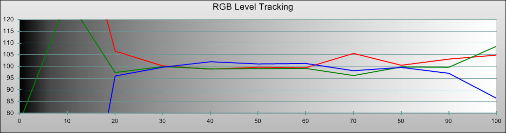

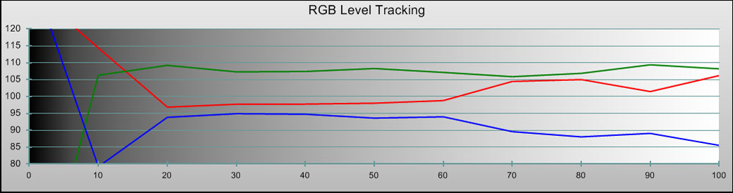

Taking our Chroma5 colorimeter, we calibrated the set and were able to get pretty decent results:
RGB pre-cal
Before: Green is NOT the color you want out in front
RGB post-cal
After: Not bad considering the limited Gain/Cut controls
Calibration options have improved since the SV471XVT. In addition to the RGB color settings, Vizio now has dedicated RGB Offset controls for making adjustments in the ~30 IRE range. The HDMI inputs are also no longer partially shared, so settings like Brightness, Contrast, Color, Tint and Sharpness can be changed on a per-input basis. This is a huge improvement for those who want to perform custom calibrations (or just use different color modes) on a per-input basis.
