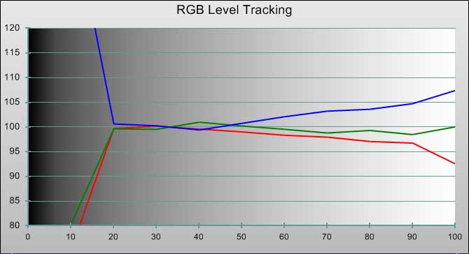

With our Chroma5 colorimeter in place, we calibrated the set and were able to get the following results:
RGB
Not bad considering there are no individual Gain/Cut controls

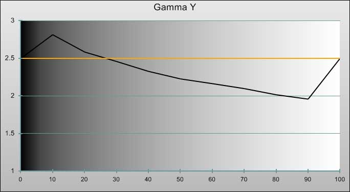

gamma
Gamma ranged, but averaged around 2.25 through the midband
