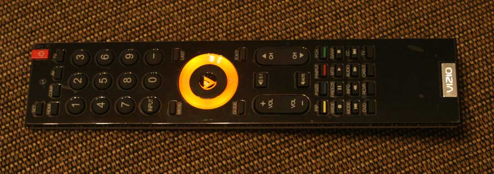

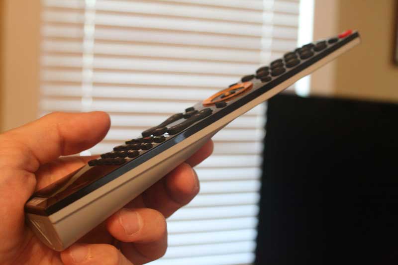

Vizio-remote2.jpgI love the look and feel of the Vizio SV470XVT remote. It is beautifully thin at top and tapers out just enough at the bottom to house the two AAA batteries. Even the way the batteries insert is cool - they drop in from the bottom rather than popping in from behind. The remote is not backlit, except for the center ring, which is really a directional arrow pad with a centered select button in the middle. It's technically capable of controlling a few other AV devices, but ultimately you'll want to get a good universal remote control to handle those duties. I didn't like the positioning of the input selection buttons at the top of the remote as they are a bit out of the way. Additionally, there are no direct inputs for each input, merely each input type. This means that you'll need to hit the HDMI button 4 times to get to HDMI 4. Taking up prime real estate is the 5.1 audio button, which is useless unless you have the optional 5.1 Surround Sound Upgrade (which I've not seen anywhere, including the Vizio website).
Below the Volume and Channel controls you'll find a whole transport section which is also a dual-use area for functions such as Wide (scaling), Info, Audio, MTS and PIP controls. Below that, at the very bottom, are the controls for selecting and using other programmed AV devices. It's an acceptable remote, but it could be a lot cooler.

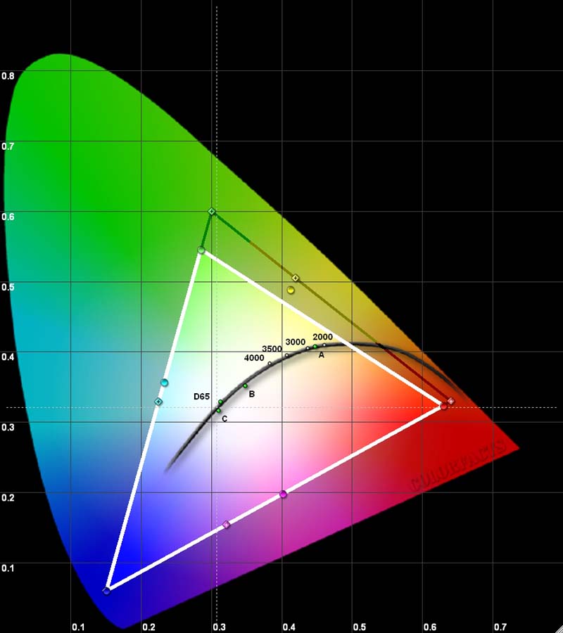

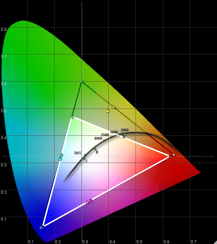

CIE Chart – Color Reproduction & Saturation Potential
After measuring the primaries of the SV470XVT, we noted that it really nailed both Red (almost) and Blue (completely) with Green coming in a tad more towards Cyan (which I prefer to drifting towards Yellow). What this means is that the Vizio has excellent color reproduction - better than several more expensive displays we've tested this year.
In comparing the CIE charts of the Vizio vs the recent Mitsubishi LT-46148 LCD review, you can see that the SV470XVT stacks up pretty well in terms of color reproduction:
Mitsubishi LT-46148 LCD (left) and Vizio SV470XVT (right)

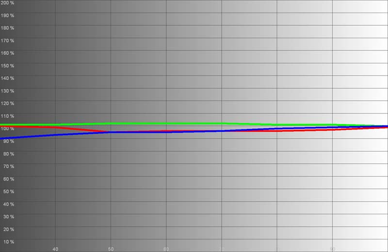

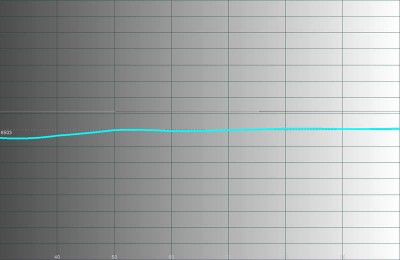

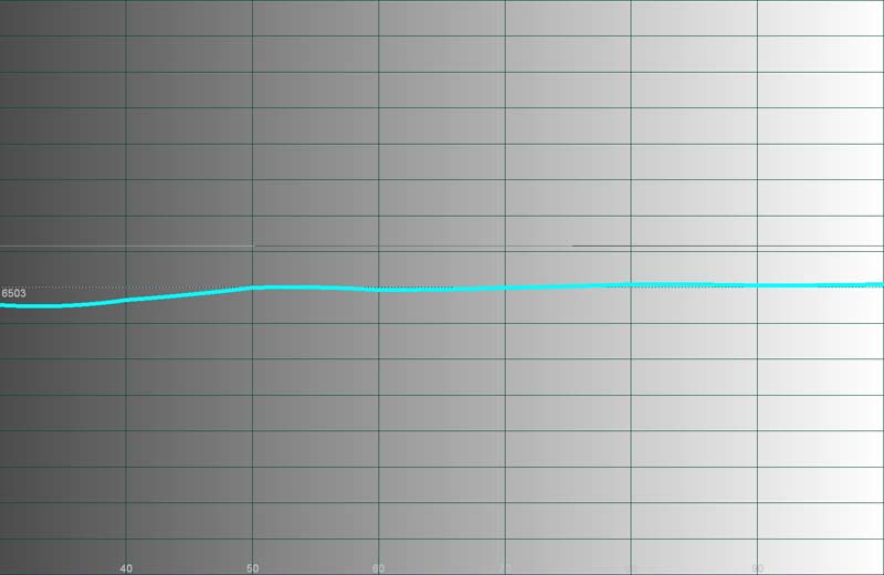

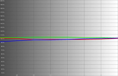

We ended up setting Brightness to 35 and Contrast to 52 and set Color Temp to Normal. At this setting, measured color temperature was 6200K. In Warm mode it dropped to 5300K (perfect for Black & White movies). Setting it to Cool yielded 8700K color temperature (which is lower than many other sets' Normal settings). With our colorimeter in place, we calibrated a custom color temperature by setting Blue to 86 (Red and Green stayed at the default 128) and got the following measurements:
Not bad considering there are no Gain/Cut controls
Color temperature maintained a steady ~6500K from 30 IRE to 80 IRE.

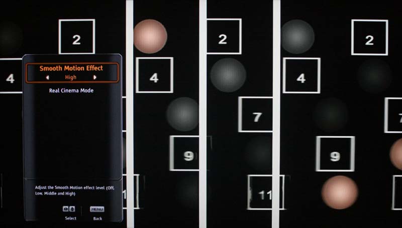

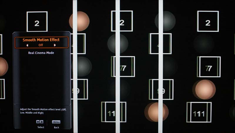

Sharpness is simply set too high by default. Drop it to 1 and you'll immediately notice a decrease in perceived standard definition noise and edge artifacts. At the default setting you will literally see jaggies on any high contrast edges. All Moving Zone Plate tests failed miserably, both with and without Smooth Motion engaged.
Smooth motion is a tough nut to crack. After trying tons of combinations on both standard definition and HD content (it affects both) my final determination is that it should probably be left off. Even at its lowest settings it results in unpredictable artifacts on high contrast edges in motion. You may luck out depending on what type of content you are watching, but since I have some excellent sources I'd probably bypass the feature until it is perfected. 120Hz Smooth Motion is something I wanted to use. It certainly did stabilize some moving images across the screen, just not without introducing artifacts - such as with race cars going around the track (I'm a closet NASCAR fan). Once I deactivated the feature, motion blur returned, but the tearing stopped. If you are going to use the system, be sure to place Real Cinema Mode on Precision as it produces slightly less tearing. Note that without Real Cinema Mode engaged, the Smooth Mode Effect feature really doesn't reduce motion blur.
Smooth Motion set to High (it's a cool feature, but notice the artifacts on the bottom #11 square)
Smooth Motion Off
