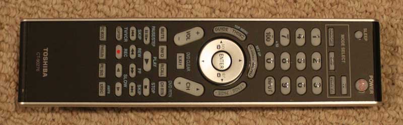

Toshiba's remote is large, well laid out and not backlit in the least. In fact, the only thing that lights up is the source selection whenever you push a button (or select the source). Why they included a backlight there and not for the rest of the remote will remain one of life's great (OK, not that great) mysteries. The remote is separated onto three main sections: Source and keypad, menu navigation, and transport controls. Other than the lack of a backlight and no direct input buttons, the remote is actually quite ergonomic and easy to use. I liked the Menu controls and, though the CH Return button as a "back out of the menu" button was an odd choice, it kinda grew on me. The only way to select an input on the Toshiba remote is to either toggle the solitary Input button or press it once and use the menu selector to choose an input. The remote is able to control up to 3 additional devices (Cable/Sat, DVD, and VCR/PVR) which is a big plus for those looking to simplify control over their A/V systems.
remote control

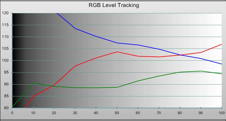

We utilized SpecraCal's CalMan software (v3.5) and an X-Rite Chroma 5 meter. This is a great combination for reviewing LCD flat panel TVs and the Chroma 5 is now available in a form that is ready for LED backlit televisions. The Toshiba REGZA 46SV670U is remarkably flexible in its user calibration menu. Aside from its full RGB Gain and Cut controls, the TV also provides "ColorMaster" controls which allow adjustment of Hue Saturation and Brightness of each primary and secondary color. Our initial measurements showed runaway Blue levels and a very disjointed RGB grayscale response, which matched our initial impressions of the picture, even in Movie mode:
RGB before
Afterwards, we were able to make significant improvements with some grayscale calibration:
RGB after
The above results were calibrated starting at the Movie Mode with a Color Temperature 2 setting.

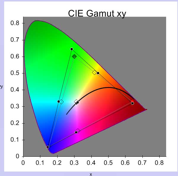

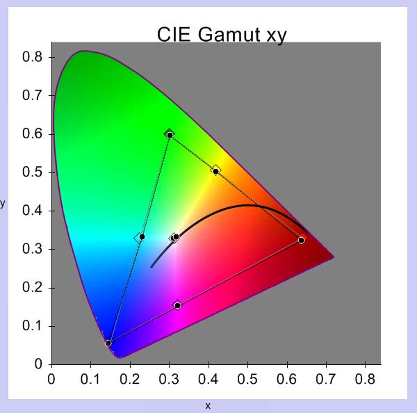

Color accuracy as measured by the CIE chart placed the color ranges outside of the desired Rec 709 boundaries (particularly Green). We adjusted the ColorMaster controls to alter the Hue Saturation and Brightness of the primary and secondary colors to dial in the display almost spot on.
CIE before CIE after
CIE chart before (left) and after (right)
