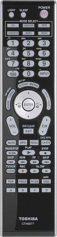

46LX177 Remote and Interactive Features
The
Toshiba remote will appeal to some. It is fully backlit, mostly in a
pleasing amber but with orange buttons for changing the device
control. It is very large, as most display remotes are. It is not a
learning remote, so don't expect it to run your entire AV system
flawlessly, though it does have enough buttons to be more than
functional. I have big hands but I found it to be less than
comfortable to use all of the controls. Typing in a direct channel,
for instance, is most easily accomplished as a two-handed gesture.
The light button is remotely located at the top left of the remote –
completely out of reach and thus inconvenient. A side switch or
option to have it go on automatically would be most welcome. The
remote lacks direct input selection – a disappointment, especially
given its ample size. Overall I'd say it was average and not
particularly bad, but certainly not a great remote.

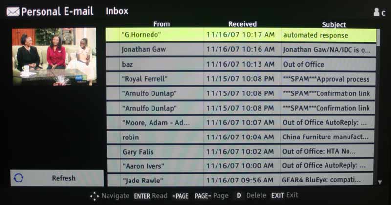

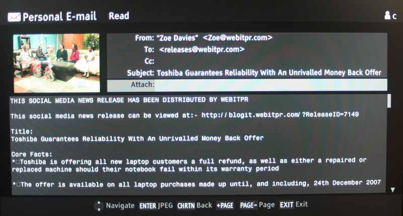

THINC
System with Personal Email
When
setting up my home network the Toshiba easily pulled my IP address
from the router. The first thing I had to try out was the email
system. I mean, jumping over to check your email during commercial?
That's like the coolest geek idea I've heard in a long time. And
what's even better than that? It works! I entered my information
including POP server and password and the system grabbed my email...
spam and all for me to see. Now if that isn't the neatest diversion
in the history of television I don't know what is.

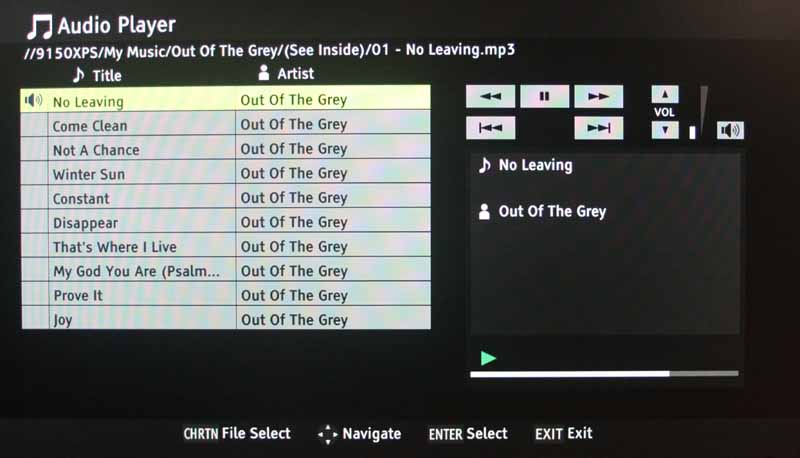

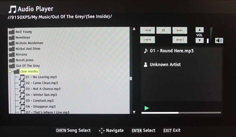

Audio
Player
Since
the networking was a breeze, enabling the Audio Player of the Toshiba
46LX177 was quick and painless. It easily located the Shared folders
on my primary PC and I was able to quickly browse and get some tracks
playing right away. The file list can be expanded by using the left
and right navigation buttons. Up and down sends you quickly through
your music or album list.
When you call up a track or album, the system scans the MP3 meta data and renames the titles and artist accordingly. There are no visualizations, but basic player controls are provided.
