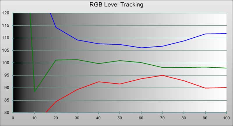

After we dialed in the RGB grayscale, we were able to make some pretty impressive improvements. Here is where we started and how far we were able to bring the television into compliance (all calibration started with Movie mode, though we switched the Color Temperature to '1' before calibrating):
RGB before
The above results were based off using the Movie Mode with a Color Temperature 2 setting.

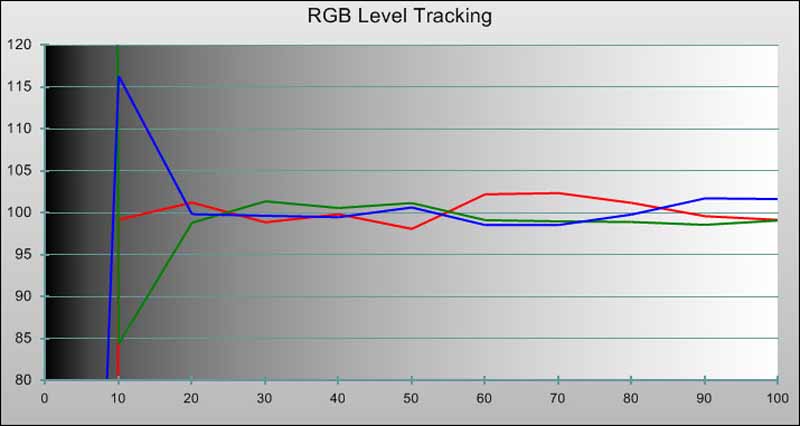

RGB after
Our final results were much closer to what we wanted to see.
Initial color temperature, defaulted at '2' tended towards Blue, with the color coming in at over 10,000K - way too high for our tastes. After switching to '1' it was at a fine place to start calibrating - and we noted that even those who can't calibrate their TVs will enjoy a more accurate picture once you are in that mode.

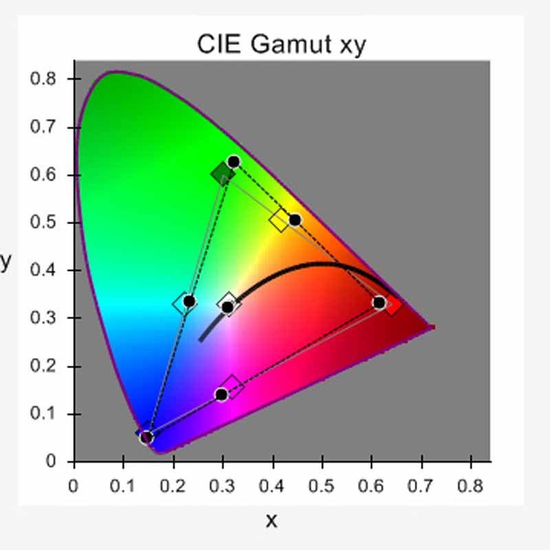

Color accuracy as represented by the CIE chart snapshot was quite a bit off on the secondary colors when we began (leaning dramatically towards Blue), and we'd attribute this to the shift produced by the Color Temperature control. After calibration the color gamut actually looked pretty good, with only a slight narrowing of the color dynamics existing between green and red. This was not something that we could notice apart from measurements, however. We also found that the entire system could technically be made to bring green and yellow into better alignment by adjusting the global Hue control - this simply didn't seem necessary, however, and we were pleased enough with the other colors to not want to compensate in this manner. Incidentally, the Base Color Controls, which are designed to allow you to adjust Hue, Saturation and Brightness for each of the six primary and secondary colors, seemed unpredictable. We couldn't use them, for example, to truly dial in the Red, Yellow and Green colors to bring them closer to Rec. 701 (the high definition ATSC color standard).
CIE before CIE after
CIE chart before calibration (left) and after (right)
