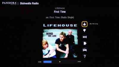

app pandora
Pandora VUDU app
The VUDU apps can be brought up by pressing the 'Widgets' button on the remote control or by accessing them from the Applications menu. As we mentioned, there is a lot to choose from. Aside from select apps like VUDU, Pandora, FaceBook, Twitter, Flickr, Weather and Picasa, the system is largely filled with select video podcasts. While there is a nice selection of podcasts, you cannot add your own favorites and the system isn't customizable with the exception of adding favorites from the existing titles. When going into one of the video podcasts, it was unfortunate to see that the titles and show notes didn't scroll, so on many of them it was hard to see what, specifically, we were browsing beyond the first few words of the description.

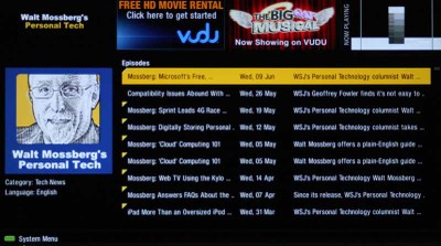

video podcasts names
We also ran into the situation where the video podcasts would buffer while the audio continued to play. We agreed with this prioritization, however it was nearly endless once it began and the buffer ran in the middle of the screen, with the frozen video behind it and the continuing audio running. This happened quite a bit and wasn't relegated to a particular show or time of day. We aren't sure why the buffering system isn't configurable to prevent this or why Toshiba didn't specify a larger buffer in order to avoid this common occurrence. Given that we can stream HDX movies in full 1080p from VUDU, we're perplexed at why the system has issues with what is essentially highly-compressed standard definition web-video.

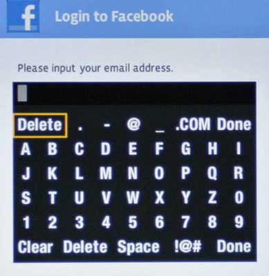

The YouTube app is only accessible from the Applications menu, another odd decision, but one that appears to be tied to the fact that YouTube isn't considered a "VUDU app". To engage in any Facebook or Twitter action, you must first log in, which is a pain as you can guess with a television remote. The good news is that the system can store both your login and password information.
facebook connect login
Much harder than texting, but you only have to do it once...

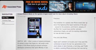

For the non-streaming apps, like the Associated Press, we found the information to be well-presented and easy to read, even from 12 feet away. You could even, on that app, change the content to be white on black instead of the default black text on white.
app AP

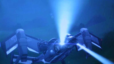

Netflix HD: Appleseed
This show is dark, both figuratively and in the way the material is presented on the screen. While not showing a lot of color, we actually stumbled across it and found it to reveal something about this television that we hadn't expected. Appleseed uncovered just how well the Toshiba's latest LED backlit television could handle streaming content and reproduce fast moving content. But what was really interesting was how the TV handled some of the embedded artifacts of this piece. This movie actually looked better on the Toshiba than on my reference Epson 9500UB Projector, largely because of the 46UX600U's ability to handle a mismatched deinterlacing error that had been made during mastering. It still wasn't perfect during pans, but the effect was rendered more tolerable by the Toshiba's video processing.
appleseed 1
appleseed 2
