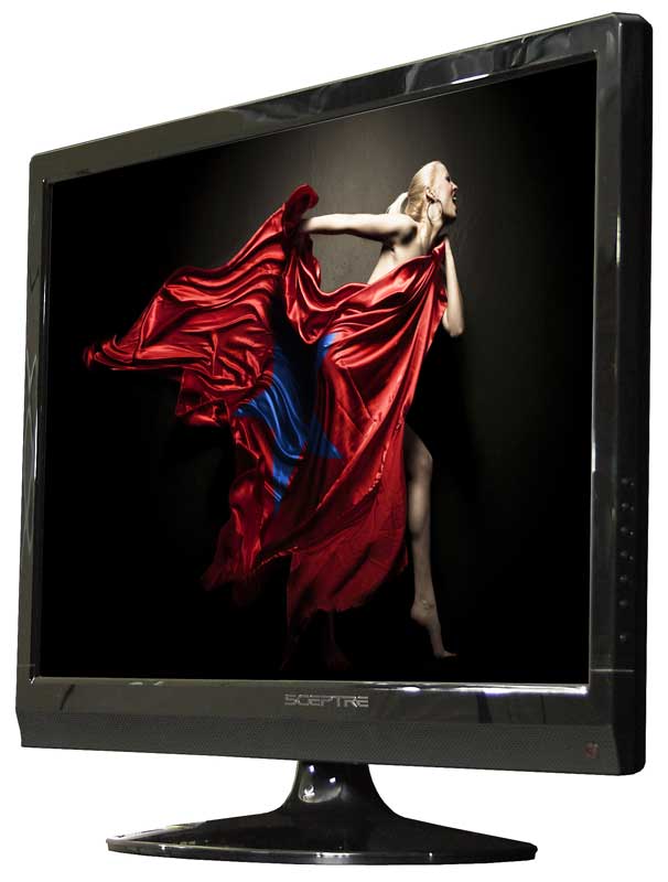

Sceptre is a product we've been watching for some time. Trouble is, we've never been offered the opportunity to review one - until now. The company makes LCD TVs of both the CCFL and LED backlight variety and they seem to specialize in two types of products: straightforward, no-nonsense designs and stylistic, colorful models that are sure to satisfy any interior designer or fashion enthusiast. The model we reviewed, the X270BV-FHD, is a 27-inch model that represents one of the more basic models. Even though basic, the television includes a host of convenience features that makes it very usable and extremely well-suited for use in almost any room.
Sceptre angled
First Impressions and Build Quality

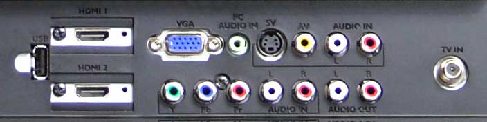

The X270BV-FHD 27” HDTV LCD comes in a stylish black gloss frame with a thin bezel that has the forward-firing speakers oriented at the bottom of the set. The 1080p television features a 100,000:1 contrast ratio and 5 ms response time. Even though the television is simplistic in its design, it still comes with 3 HDMI inputs that allow users to connect multiple audio/video sources like DVD players, personal computers, AV receivers and video game consoles without having to swap cables. In addition to the three HDMI ports, the integrated USB port allows users to conveniently view digital photos as well as listen to digital music. These ports are located in two areas, on the side of the monitor and the rear of the set, allowing both easy accessibility as well as a more permanent storage facility.
Since the unit uses a standard CCFL backlight system, it's just over 2-1/2 inches thick - hardly thin by today's standards, but still easily wall-mounted or placed just about anywhere. The set is rated for 50,000 hours of use - a good long life span to be sure - and it puts out a peak brightness of 400 cd/m2. Most of the inputs are rear-mounted, but the left side of the TV also provides access to an additional HDMI port, a headphone (labeled "earphone") jack, and a S/PDIF digital audio output. Rear inputs include 2 HDMI inputs, VGA, component, composite, S-video, coaxial cableTV and associated stereo analogue audio. There is also a USB input for streaming stored audio files.
Sceptre inputs

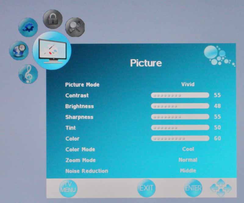

menu systemGetting everything set up is simple, and the menu system is part of what makes this an easy television to configure. There is even a Setup Wizard, that takes you through a brief process to configure Language, Date and Channel setup for the tuner. The on-screen display system includes 5 sections, which are pictorially represented as an animated series of six sphere's around the selected menu item. Yu can adjust Picture, Audio, Time, option, Lock and Channel. If you are unable to make an adjustment, it typically indicates that the current source or preset renders adjustments in this area impossible.
Picture adjustments include the expected Brightness, Contrast and Picture Modes as well as Noise Reduction and Zoom modes. These adjustments are all possible for the analogue and video inputs, save the VGA (PC) input, which eliminates Noise Reduction and Zoom modes in favor of Clock, Phase, and Position controls). Also, when viewing music and photo content via the USB connection, only basic Picture adjustments are possible (no Noise Reduction, Zoom, or Color Modes).
The Channel menu is used to select the TV source (Air of CableTV) and also to initiate an auto channel scan and Show/Hide channels. This menu also delivers a visual representation of the DTV signal level - very handy if you are pointing a digital antenna.
Audio adjustments include the Sound Mode (kind of an EQ preset), Bass, Treble, Balance and the enabling of SRS TruSurround. There is also a really great feature that allows an input to be converted to "Audio Only" - a setting that means you can use just the speakers of the TV and turn off the video display. Some of the audio settings change depending upon whether or not the TV is being sent a digital or analogue signal, but overall these differences are small and center on the presence of an MTS signal.
The Time menu controls only the Sleep timer, Time Zone and format as well as daylight savings time setting. It's a bit odd to have an entire menu dedicated to this, but given the simplicity of the menu system I suppose they had some room to split off these features. The Option menu lets you set the menu transparency, OSD timeout, language and Dynamic Contrast Ratio (DCR) settings. The Lock setting is dedicated to parental controls.
When making settings, the menu stayed up for 15 seconds before disappearing. That's a bit quick if you're in the midst of trying to adjust brightness or Contrast, but not as bad as some systems we've seen. Overall it's an easy menu to use and navigate.
