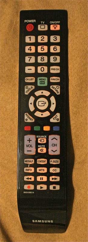

Remote controlI liked the styling of the Samsung 7000-series remote. It has a gloss black face and a nicely curved back that fits well in the hand. It is completely backlit save for the four colored multifunction buttons. You can engage the backlight and then have it automatically come on when you press the buttons on the remote. To save the batteries during the day the backlight feature can be turned off as well. The remote is organized into three main sections, though this is organizational in nature and not via any specific defined breaks.  The top section is for the numeric keypad and power. The middle handles and menu functions and the lower part is for navigation, volume and channel controls.
What made this remote intolerable, however, was its absolutely horrendous responsiveness. Pressing buttons was painstakingly slow as you had to allow nearly a half second between each press. In addition, none of the keys seemed to repeat, so scrolling down a list was mostly impossible. I don’t think there is any good reason for this and Samsung should take a long serious look at the processing involved in remote operations as it takes a really good experience and puts a very negative overlay over the entire thing.

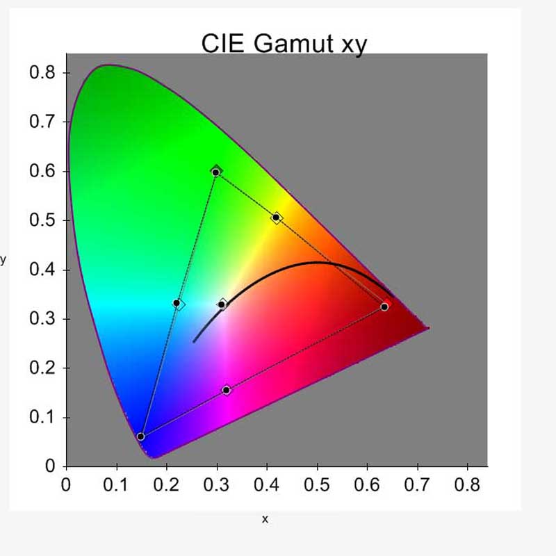

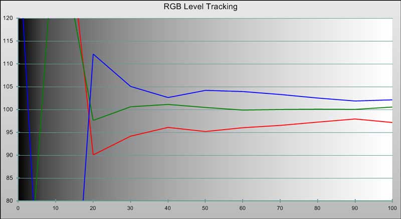

CIE afterWe again utilized SpectraCal's CalMan software (v3.5) and an X-Rite Chroma 5 meter. This is an excellent combination for reviewing LCD flat panel TVs and the Chroma 5 is now LED-ready so it will deliver correct color measurements. Calibrating grayscale on this set was like playing tug-of-war. Adjusting the Gain also affected the Offset, and dramatically so. This was so much the case that I actually wondered if the controls were truly separated or if there was just one Siamese control for each color that turned up the Red Offset along with the Red Gain. In contrast to this, the Color Space controls are extremely sophisticated and we were able to dial in the color perfectly. This set comes pretty well calibrated out of the box with a few key exceptions, but the calibration options are sophisticated enough to get you where you need to be.
RGB before RGB after
Grayscale tracking was much better after calibration, but the controls
were very awkward and Gain and Offset appeared to be connected

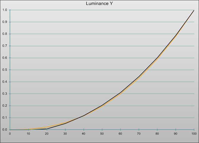

luminance
Luminance response was good and users have the ability to tweak Gamma if desired

I am trying to figure out why you had a delay on the response of your remote, as mine and my cousins both work fine. The response is quick, no delays. What firmware you were using? I did the firmware update (1013 as of Nov 3) the networking software PC Share Manager Version is 2.3. I did this soon after I received my UN40B7000. I used a wired connection as my Panasonic PD 55 and my new (not ordered yet) Yamaha AVR will need Ethernet too so I went with a switch off a Belkin N+ router downstairs.
