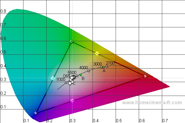

For calibration I'm using both the Sencore ColorPro System and Colormetre HCFR software. Basically, Sencore is great for calibrating your set but doesn't give you the pretty graphs that we like to show in our reviews. That's where Colormetre comes in. From the default settings, I measured:
Dynamic - 9100k (1700:1 contrast ratio)
Standard - 8100k (1150:1 contrast ratio)
Movie - 6300k (1150:1 contrast ratio)

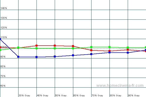

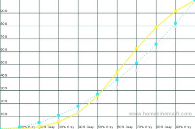

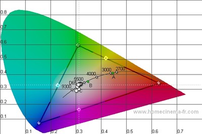

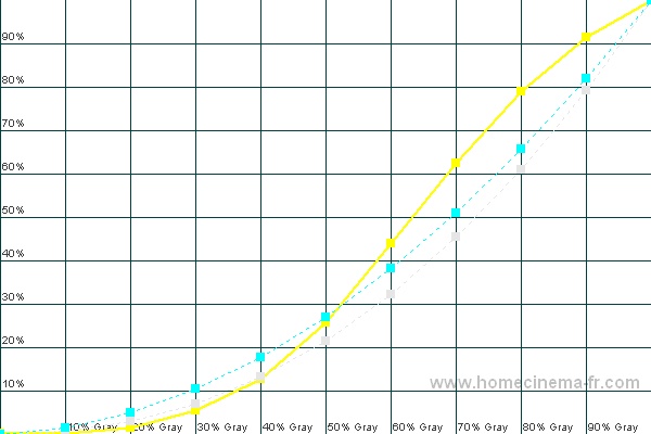

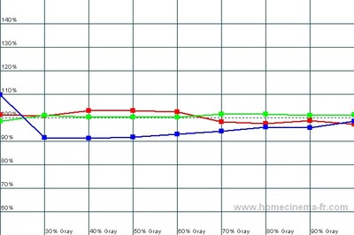

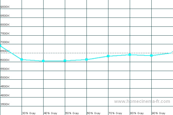

Calibration options were nearly unlimited on the PN50A760 - not that you needed them. All the standard stuff was there (Brightness, Contrast, Tint, etc) along with your gain and cut adjustments under the White Balance menu under Detailed Settings. I fiddled with these controls but in the end, I don't think you need to do much else other than turn the set on. I was able to achieve these measurements from the default Movie setting (Note: throw out any color readings below 30IRE due to limitations of the colorimeter I am using):
Color Temp
CIE
Luminance
RGB
The above measurements were taken without any calibration. The only problem area really is the Luminance which seems to be crushing blacks a bit at the bottom end. During the viewing evaluation, I didn't notice any artifacts or problems with this phenomenon. It looks as if some sort of processing is engaged but I triple checked all the settings and didn't find a problem. With a bit of tweaking I brought the RGB and Color Temp in line but I wanted to show you out of the box performance since it is very, very good. Not as good as the LCD counterpart, but close.
