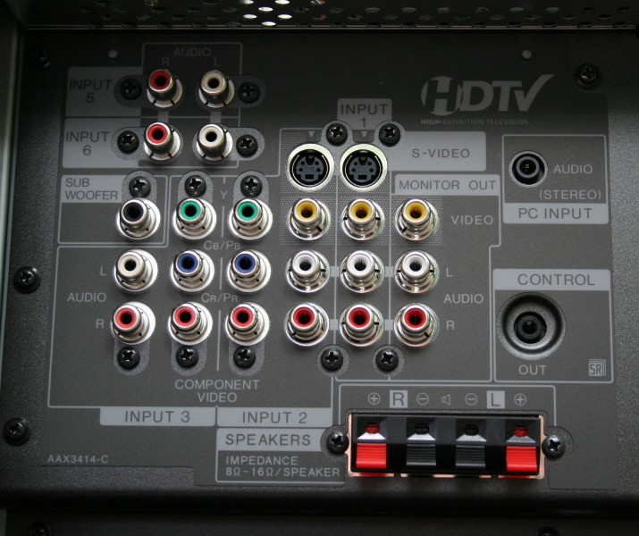

PDP-5070_side.JPGThe back of the PDP-5070HD is full of inputs that you can see and a few that you can’t. The inputs are labeled numerically (even in the menu) rather than by function (composite, component 1, component 2, HDMI 1, etc). There are three connection points, one on the back of the unit parallel to the screen, one on the back of the unit perpendicular to the screen, and one on the side of the unit. You’ll want to familiarize yourself with the inputs that are perpendicular to the screen before you set the unit up (and perhaps go ahead and connect a couple of cables). I’ll take you through the inputs one by one and list their type and location:
  • Input 1 – S-video, composite video, analogue audio – back parallel
  • Input 2 – Component video, s-video, composite video, analogue audio – back parallel
  • Input 3 – Component video, analogue audio – back parallel

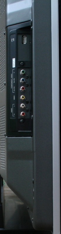

  • Input 4 – Component video, composite video, analogue audio – side

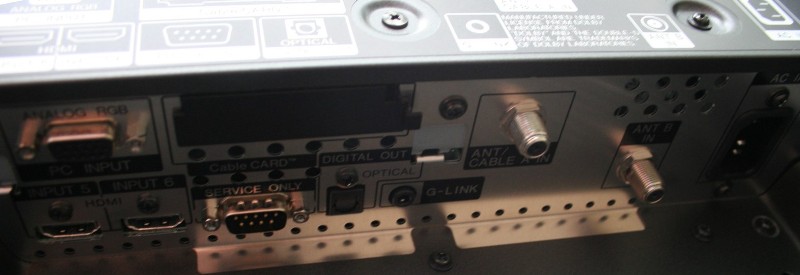

  • Cable CARD – for direct control of digital cable service – back perpendicular
  • Cable/Antenna input – two are located on the back perpendicular
  • Subwoofer out (to supplement the display’s speakers – back parallel
  • Digital out – TOSLink connect if you want to route your audio/video through the display and out to the receiver – back perpendicular
  • G-link – an IR flasher to control a VCR if you want to use one to record your programming – back perpendicular
  • Monitor out – Composite, analogue audio – out to a VCR or other recording device – back parallel
The only thing missing is a digital input for audio other than the HDMI’s. Since display's don't typically offer bass management, however, the analogue inputs typically serve 99.9% of anyone's needs should they want audio to be routed through the television.
