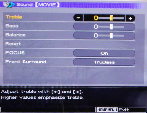

PRO-940HD-sound-menuHow does the PRO-940HD function in terms of audio? HDMI audio is passed through to the television in 2.0 and the onboard speakers are actually quite good. They won't fill a 3000+ square foot room or provide chest-thumping bass, but they definitely get the job done. The low profile of the speakers and ability to engage some interesting options make it a cut above the typical speakers found in many entry-level televisions. A Focus option allows the set to "elevate" the sound to the center of the set using DSP. This is an on or off function and seemed to work quite well in fact. I also tested out the SRS and TruBass functions of the set. SRS is a great feature for those who simply cannot accommodate surround sound in their rooms. The effect is immersive, though a bit "phasey". It's definitely an improvement if you're trying to get emotionally involved in a movie and not doing critical listening. TruBass elevates some of the lower frequency information into the frequency range of the television's speakers and gives listeners the perception of lower bass response. If you have a subwoofer connected to the system I'd recommend leaving this off, but if you don't, then feel free to engage it and hear a taste of what you are missing.

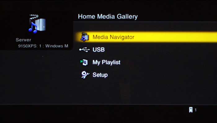

PRO-940HD-media-galleryMedia Center? Yes, the Pioneer PRO-940HD includes the ability to network files from connected PCs (yes, plural) within your home network... and it works! The requirements are simple: Have a Windows XP (Service Pack 2) PC on the network running the free Windows Media Connect 2.0 software. This software allows you to configure your PC for which files it will share with compatible network devices which may request these files (like the Pioneer). Setup took all of 5 minutes to download and install the software. It's likely that this software already exists on your PC, and it is embedded within the new Windows Media Player 11 software.
PRO-940HD-media-music2To connect to the PC, well... just go to the Home Media Gallery. That's about it. Now browse your music, movies and photos and you can get them to show up on the Pioneer plasma display. I was able to network with all of my music and images (at least all of the tracks I tried) and only ran into trouble when trying to play back unsupported AVI video files that were generated directly by my Pentax Optio digital camera. While not surprising or tragic, realize that if it's not WMV or MPEG 1 or 2 it probably won't play. My workaround was simply to use the USB jack located on the side of the TV or play the videos into the plasma using the AV cable that was supplied with the digital camera. This TV comes standard with a lot of options, so you can get just about anything done if you think hard enough.
Having a Media Center in your living room is quite a bonus for a television - especially when it comes without any extra boxes or cables to connect. The Home Media Gallery is easily accessed via the remote control - there's a big button called "Home Menu" that brings you to the place where you can select the Home Media Gallery. From there you can select the Media Navigator to browse videos, music and photos, connect to a USB drive, or view your playlists. A setup menu is available for checking version numbers, performing firmware updates or adjusting your network settings. If it were wireless it would be the perfect TV... but to be honest, it's getting pretty close as-is.

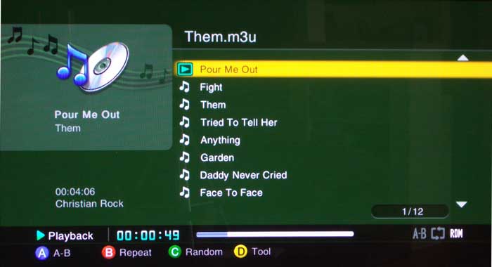

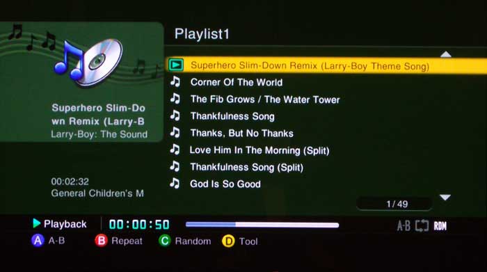

PRO-940HD-media-playlistBrowsing and playing back music was a very simple process, though some features I've come to love about Windows Media Center were noticeably absent. This included Album cover art and a simplified way to create and manage playlists. I found that the interface is somewhat cumbersome if you intend to do anything other than select songs or albums one at a time for playback. Simple playback worked as expected with fast forward and rewind controls functioning as well as the ability to repeat and randomize selections. Playlists were not well-integrated or easy to make and seemed to be an afterthought.

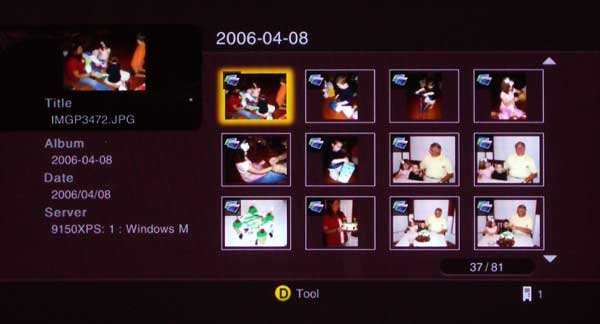

PRO-940HD-media-picsFor photos, the interface worked equally well. It was an easy process to locate and play back folders of photos. Folder names were displayed along with the image name and format. Thumbnails of all photos located within a folder are displayed when navigating the contents. It may take a few seconds for the thumbnails to refresh, but the screen always updated and I was able to select either individual images or begin a slideshow of an entire folder. The resolution of the images on screen was perfect. The PRO-940HD does an excellent job of scaling. These were 5 megapixel photos (2560x1920) - way more than the resolution offered by the plasma television - and yet they displayed as if they were made to perfectly match the native resolution of the Pioneer. If you want to show off a family photo album, this is a great solution. My suggestion for photos is to create a separate set of folders specifically for playback, allowing you to configure custom slideshows to show off your favorite memories.
