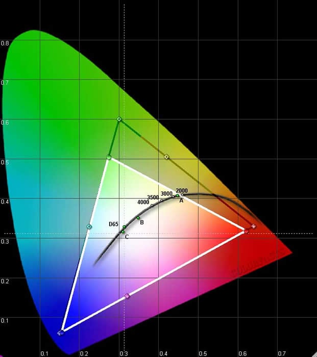

CIE Chart - Color Reproduction & Saturation Potential
940HD-CIEWhile the CIE "shark fin" is representative of all the colors we can see as humans, the part we're focused on is shown with a black triangular outline. This is the target color range for HDTV video and the current standard we measure against when determining a display's color reproduction capability. The closer the white triangle is to the black triangle, the richer the overall colors.
Using a signal generator is best for capturing extreme RGB color data, however we ran the test using an AVIA Pro DVD as our source for color. That, combined with setting the Intelligent Color and Color Space menu settings to their lowest possible points may have contributed to the diminished greens we see here. In practical viewing, the Pioneer still looked extremely vibrant and colorful.

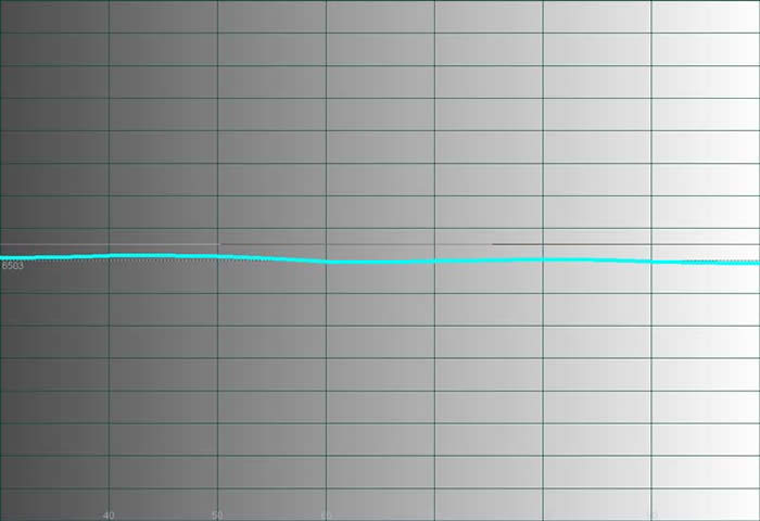

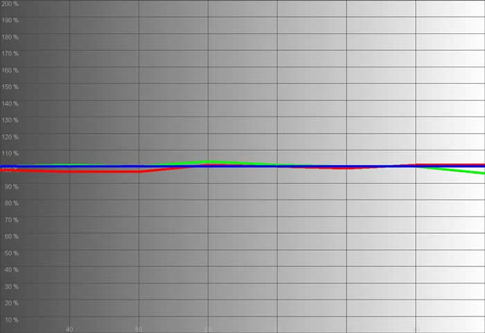

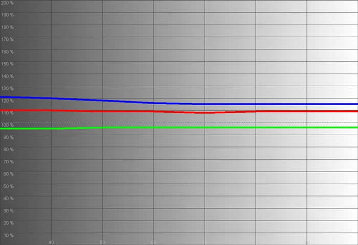

We first determined that the best color temperature starting point was 'Mid-Low'. Our 'Before' measurements showed a display with excessive blues and reds throughout the entire luminance range. Even this isn"t bad compared to the defaults of many models we've seen, however.
Calibration yielded excellent results that didn't jump around too much across the working range of the television. The resulting grayscale was flatter than ever. There as no "rubberband syndrome" on this calibration.

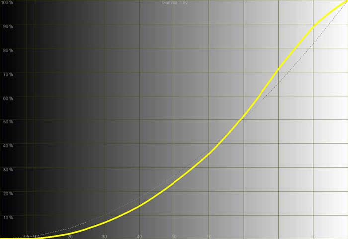

The starting gamma luminance curve was actually a bit brighter than we desired, and blacks took on a more grayish tint.
After calibration and setting the black levels a bit more accurately we still had the slight s-curve gamma response, but the results were extremely pleasing to the eye and shadow information could be discerned in great detail.

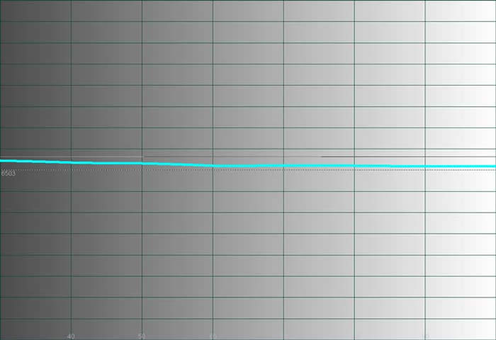

The color temperature reading before calibration was approximately 6800K. Not bad.
We actually managed to get it almost exactly to D65 across the entire range.
