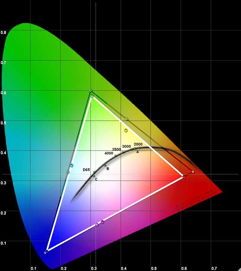

TC-37LZ800-CIE.jpgUsing our reference Datacolor Colorfacts Professional software, we measured grayscale and primary colors as well as the contrast of the TC-37LZ800. Color reproduction, as seen by the CIE chart was pretty good, though red really looked off - like it was leaning towards a more pinkish hue. This bore out in our results, but not as much as I had initially guessed, showing me that instrumentation is a vital addition to my eyes.

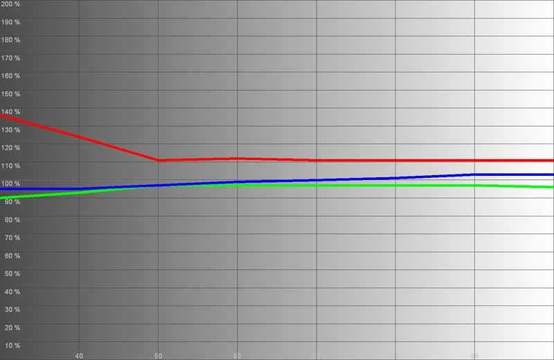

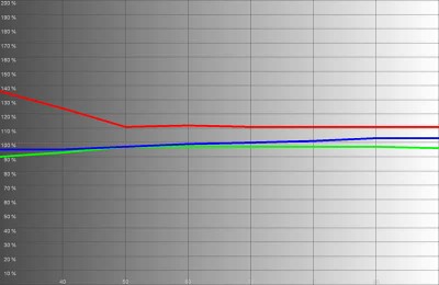

Considering the grayscale cannot be adjusted in the user menu, the best RGB performance I measured wasn't too bad. There is a bit of Red topping out on the television, but easing off the saturation control might help a bit. Overall it’s an apparent attempt to goose up the weakest color of the set and the real-world performance of the set doesn't bear out any sort of deficiency - at least not to my eye:

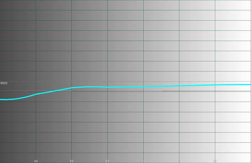

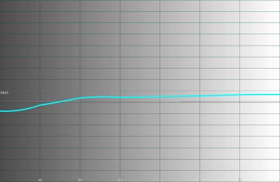

Temperature tracked consistently, though not quite the D65 that we would have hoped for. You may actually find slightly more accurate color in the Standard mode as compared to Cinema, but you'll need to make other adjustments as well.

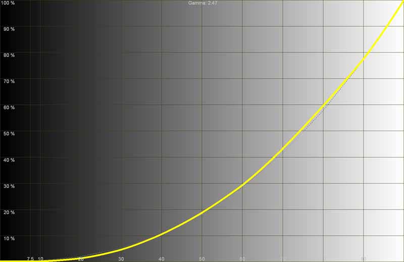

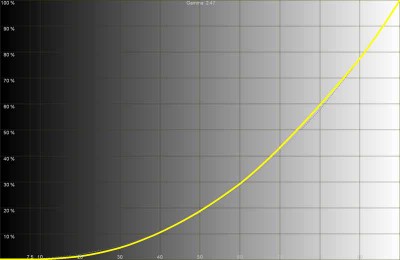

Gamma measured out at 2.47 and was a nice gradual track with no crushing of Black or White anywhere in the spectrum. This bore out with our viewing tests which showed an exceptional picture.
