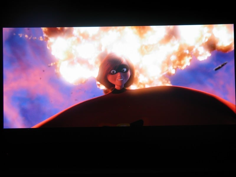

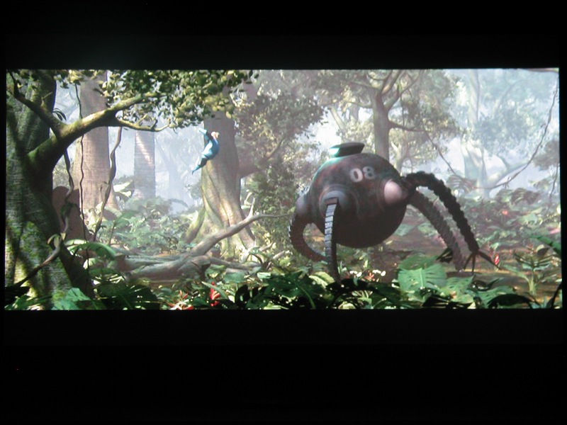

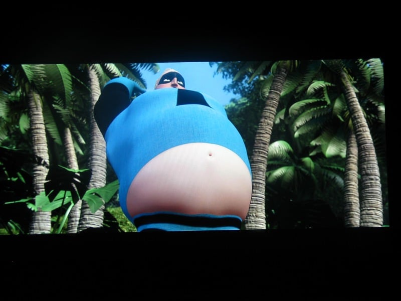

I freakin love this movie. In my opinion, it is by far Pixar's best work. Superheroes with a James Bondish plot?! Brilliant. I was noticing a ton of detail that I wasn't noticing before. The texture of the suits, the movement of the hair, a lot of little details that just weren't apparent on other displays. Colors were vibrant but not oversaturated. Blacks looked good as did the nuances of the textures on the uniforms. Motion was never blurred nor did I notice an abundance of macroblocking during the darker scenes or explosions.

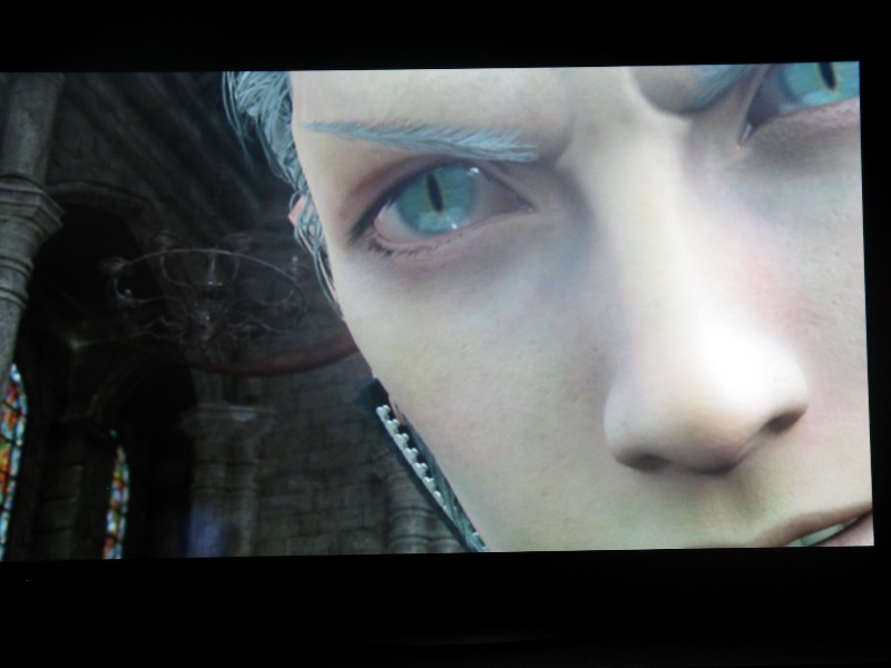

Now, for people that know and love the game, this movie might make sense to you. For everyone else, don't think this is Spirits Within part two... cause it ain't. I never was one for the epic RPGs that have such a rabid following so I wasn't familiar with the story. Fortunately, I have a friend (who brought the movie over for me to watch), so he translated... sort of. The prelude "movie" (really, just outtakes from the game) makes no sense even with a "translator" and I don't think I could sum up the plot of the main movie if I wanted to. "Disjointed"is a word, though "drug induced" might fit better. My comment after it was over, "Hey, man. Someone went to the bank and cashed a check after writing that story. They got paid for that! How do I sign up for that gig?" Anyways, it was a beautiful movie to look at if a bit smoky. It seemed as if there was a layer of haze over the entire movie. When it was clear, however, the textures were beautiful and the graphics intense. There were lots of action scenes that were intentionally blurred but those that weren't generally worked fairly well. There was some evidence of jaggies here and there and some graininess to the layer of fog but overall, it was fairly well done.
