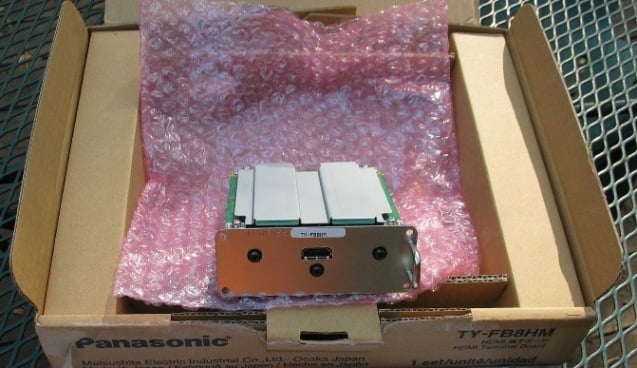

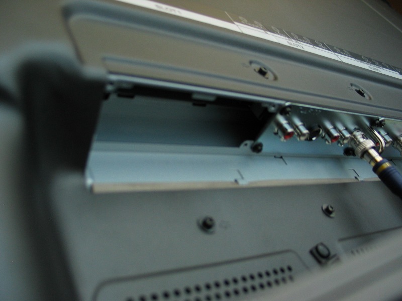

The input and connections are exactly the same as the TH-50PHD8UK. This time I asked for an HDMI blade so that I could a) report to you about how hard or easy it is to install and b) use it to test out another piece of equipment that I had under review. Unfortunately, the other equipment wasn't performing video conversion very well so I can't tell you definitively how the HDMI blade performs. I will say that you should seriously consider installing this (or any) blade while the unit is on the ground. Preferably face down. I already had the unit on the stand and while it is possible to install it that way, it is not easy. Well, it is easy, it is just not very convenient. You'll need a very small screwdriver and a lot of patience.

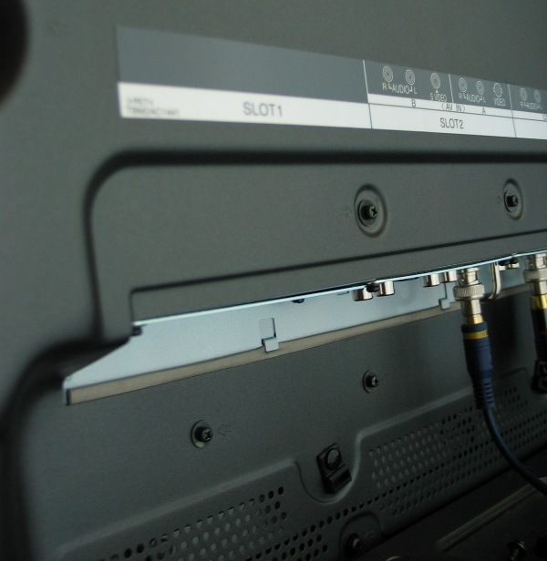

9UK_Input1open.JPG The best way to install a blade is to lie it face down (on something clean and soft). You'll need a fairly long, thin Phillip's head screwdriver to remove the plate. I chose input one as it was the same size as the blade and it wasn't currently in use. You'll need to remove the cover (four screws) and set them aside. The blade will slide in easily. There is a grove on the metal plate that will let you know you are inserting it the right direction. After you feel it click into place, you can lock it down using the same screws that held on the faceplate. If you are inserting this blade into a double blade slot, there is a blank faceplate and screws to cover the unused side. You are also provided with a label to use that matches the rest of the labeling on the back of the unit. Overall, the process was quick and easy.
