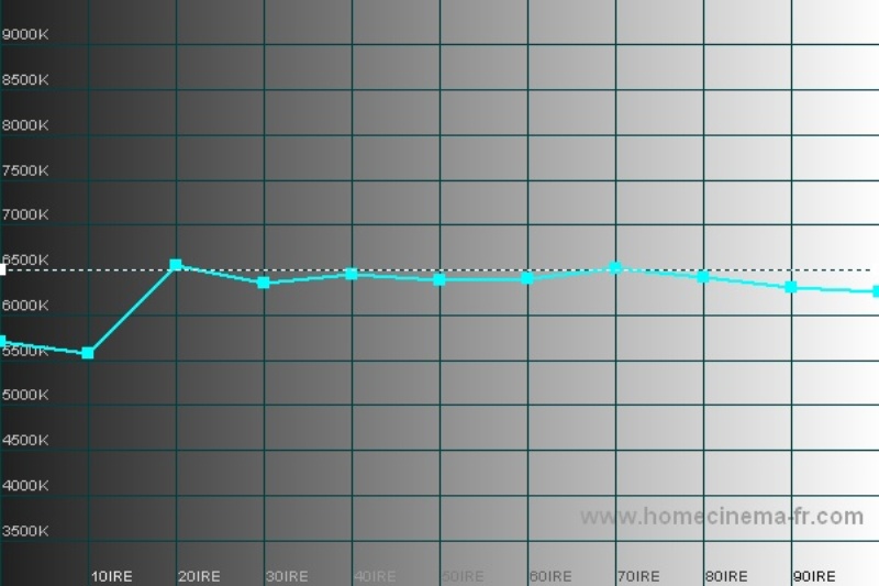

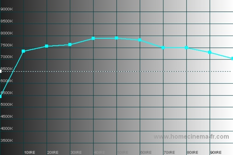

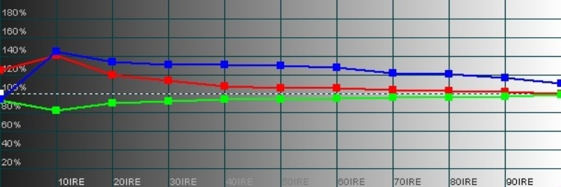

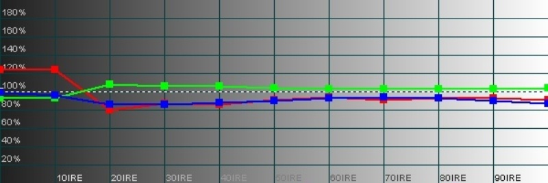

CIE_afterEven though this is a 1080p display, I was surprised and the similarities in the calibration to the 720p sets I’ve tested. Once again, blue was way too high and to a lesser degree, red. I’ve often been asked to give my calibration settings but honestly, that would be a bit misleading. I’ve calibrated both the inputs (component and DVI) on multiple sources and for every source it is a bit different. Suffice it to say that you most likely need to knock blue down a significant amount (on some inputs, I bottomed it out) and red about half as much. Even then, I couldn’t get the set dialed in perfectly. I used the Sencore ColorPro 5000 to calibrate the display but used the free program HCFR Colorimeter (which Jeff Lawson recently pointed out to us on our forums) along with the Spyder II meter from the datacolor SpyderTV PRO kit to generate the below graphs. If anything it pointed out that the two colorimeters were still tracking pretty closely together.
temp_b4
As you can clearly see, the display was running fairly hot out of the box (using the Standard setting) between 7500 and 8000k.
temp_after
After calibration we were much closer to the desired 6500k.
RBG_b4
Before calibration, it is obvious that the blue is very high with red a bit over the mark.
RBG_after
Here we see much better alignment between the primary colors.
