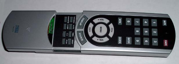

Remote Control
Olevia LT30HV remote
  • Simple Operation
  • Narrow Profile
  • Lacks programmability
  • No backlighting or nighttime illumination
The remote control furnished with the LT30HV contains all of buttons necessary to operate the display, but is sparse when it comes to extras such as universal codes, programmability, and backlighting. Don't even try to operate this remote in the dark. My recommendation is to purchase an aftermarket remote from the likes of Harmony or Universal, or use the one that came with your A/V system.
