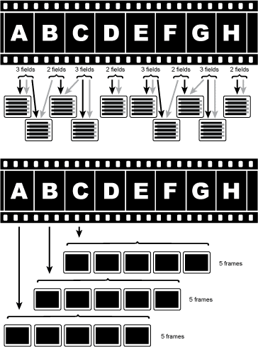

What the NuVision attempts to do with regards to its 120Hz processing is actually pretty straightforward. In addition to dealing with frame interpolation, which requires intensive video processing and advanced deinterlacing. Where the NuVision's FFM (Frame Forward Motion) system essentially makes up new frames based on guesses at what an additional inserted frame would have looked like, the NVU40FX5LS also uses its FX5 (Film Times Five) system to duplicate each frame on a 24p source (like Blu-ray or DVD) five times. That means that both the 24p source and the resulting 120fps video are evenly divisible by each other - so no deinterlacing is required. The two systems can be used together, or you can use just the FX5 by itself.
If we map this out visually, here is what it looks like:
120Hz vs pull-down
Standard deinterlacing (top); NuVision FX5 120Hz processing (bottom)
As you can see, the above version is what happens when a 24p source is regularly deinterlaced. The result is a complex field-rendered mess that must be error checked to avoid all manner of unsightly video artifacts (imagine one field from frame B and one field from frame C during a scene change, for example). NuVision cuts right through all this with straight duplication if each frame 5 times. The result is smooth motion at a higher refresh rate that eliminates the judder effect that is a naturally occurring "stutter" when you persistently try and fit 2 frames into 3.

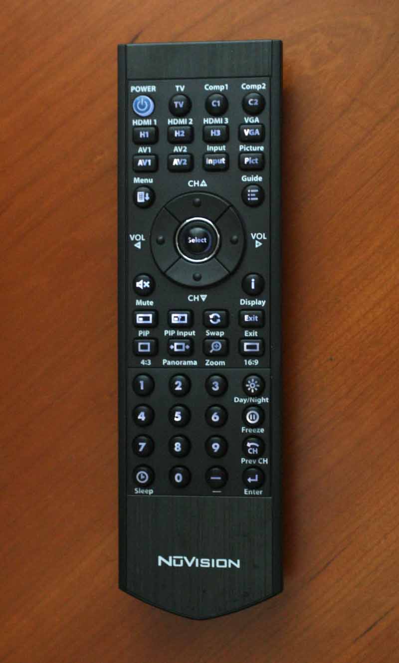

We liked the remote control that came with the NVU40FX5LS. There a re a few quirks, like the lack of an HDMI 4 direct input button, though the remote allows access to nearly all others. This seemed like a case where NuVision simply didn't want to redesign or recommission a remote control and simply made due with what they had - which isn't bad. The remote is completely backlit and about the only thing you can criticize, apart form the above, is the duplicate button shapes which dominate the remote. This is offset, in my opinion by the excellent backlight, so it's not much of a ding.
remote control
