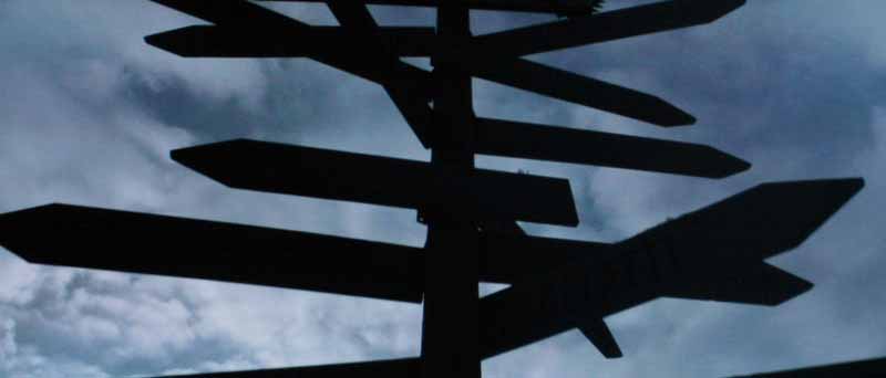

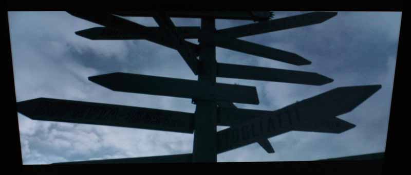

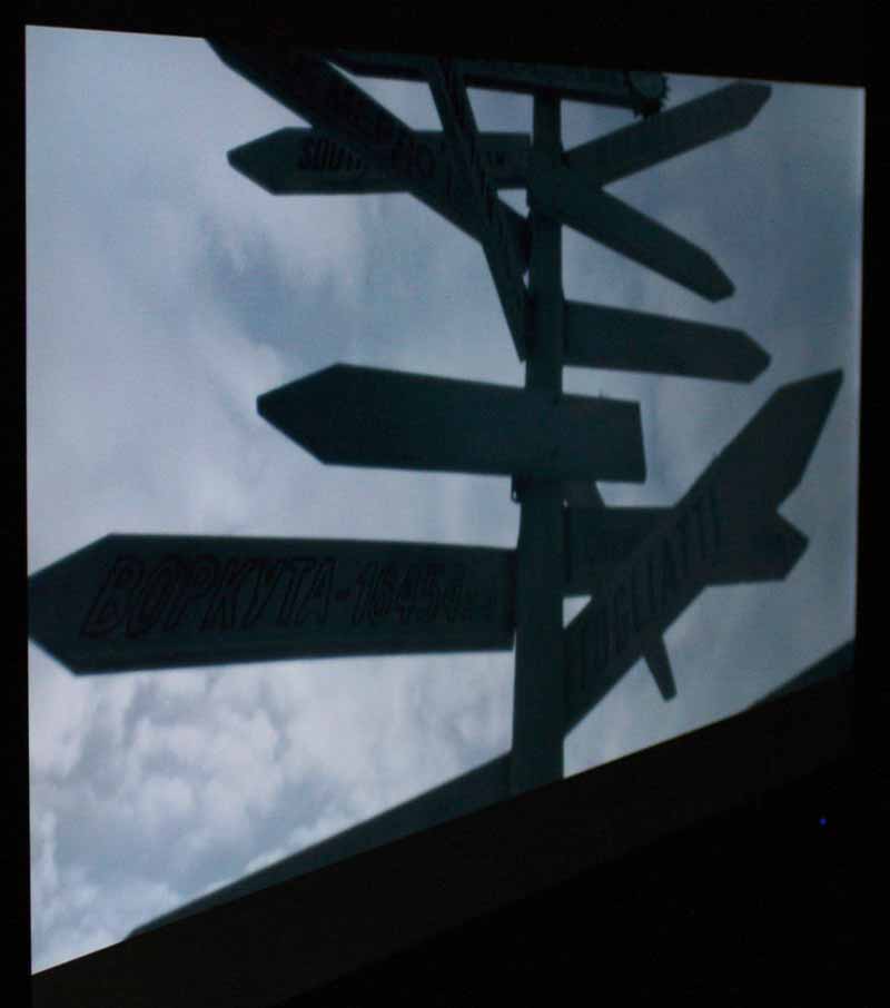

Whiteout had several scenes that showed off black levels, but none so poignant as the city sign that points the way from the pole to the different major cities across the world. You can barely read this sign on a poor TV, and just make out the names on a set with excellent black level detail. With the straight on view the contrast (at default) was close to perfect, and the signs were nearly a silhouette. What I did next, however, was angle myself up so that I was above the TV looking down at it. Next I stood off to the left. In both off-axis positions the contrast dropped and the black levels rose. This made the signs easier to read, but showed that the NVU40FX5LS doesn't have a perfect off-axis viewing response and could use some work in that area (IPS, or in-plane switching works well to combat this, though there are other solutions as well).
whiteout front
whiteout side whiteout top

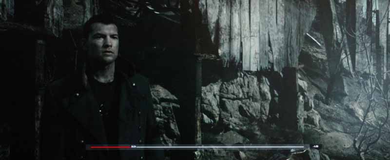

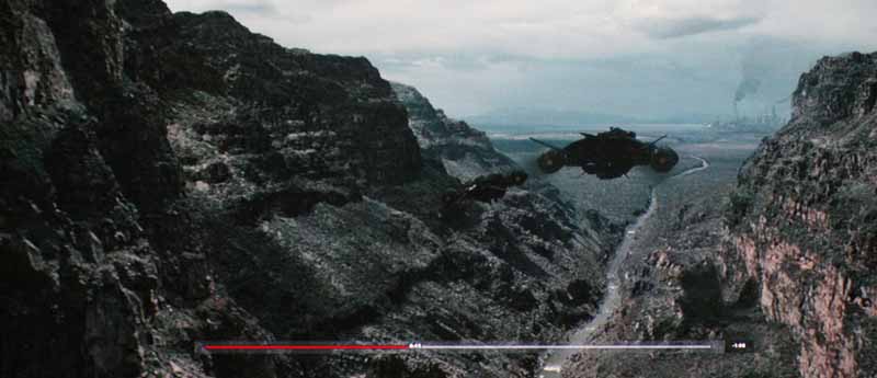

This movie was entertaining, and it was certainly detailed and action-packed. We snapped of a  few shots and included them here to show you the level of black detail and crisp response that is possible from this set. One thing this movie brought to light was the difficulty of maintaining black level uniformity with the edge-lit technology NuVision uses. This is a common problem with edge-lit LED LCDs and it looks like there is still some maturity needed in this area. This is more a statement about this type of edge-lit technology (which is primarily responsible for the availability of thinner screens), rather than NuVision.
terminator salvation 1
terminator salvation 2
