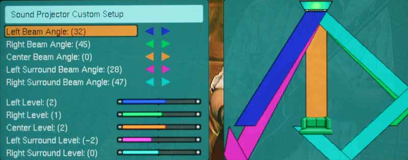

We tried out several of the default modes, which include various positions the television might occupy in your home. These recall preset virtual beam locations which get the sound across the front of the soundstage and also behind you as surround sound information. You even set the wall lengths and the distance to your seated position (or "sofa" as Mitsubishi labels it). What we liked best, however, was the Custom Setup mode where you could steer the beams around the room until you located just the perfect positioning for your seated position. Both the front and rear speakers need to be beamed off side or rear walls but you have plenty of leeway to help this take place. Once we were done directing the beams, we got to work setting the levels with our SPL meter and dialed in the system quite nicely. The sound projector worked well in both corner and side wall locations, but, as with other sound projectors I've tested, the side wall location worked best for a realistic surround field.
