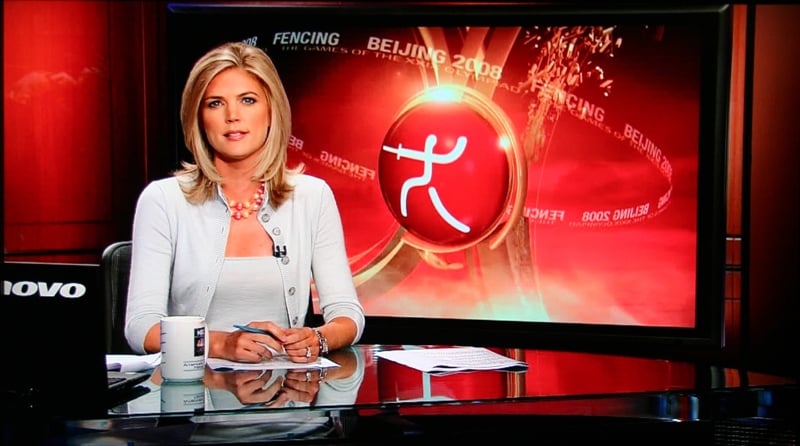

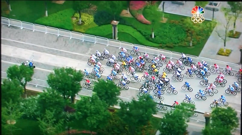

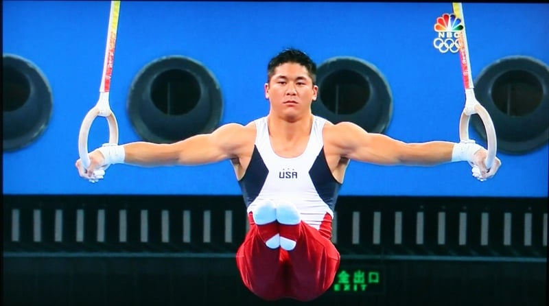

HDTV - 2008 Beijing Summer Olympic Games
I love the Olympics, always have. Now that I have HD, I really, REALLY love it. With a good HD signal, watching the games is like sitting in the stands. It looks so real. Of course, most of these sports are fast moving which is an excellent time to gauge how the display handles fast motion. The LT-42SL89 did remarkably well with fast motion and I was very pleased to note very little motion blur. Even on the fastest scenes, the motion blur was very subdued and only by paying close attention could I even see it. None of the others that viewed the set noted it (some, even after I asked them to look for it). The images were crisp and clean and the colors well saturated. Any major (or minor for that matter) problems I noted were attributable to bad signal quality and not any problem with the display.

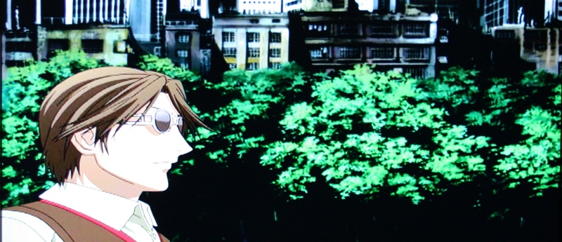

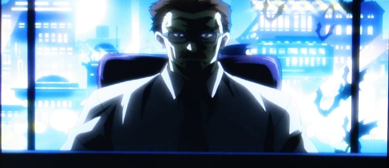

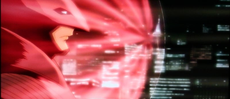

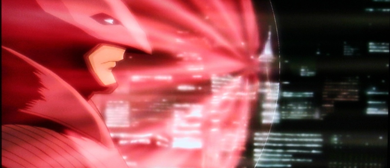

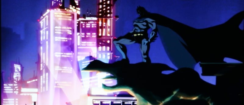

DVD - Batman: Gotham Knight
This animation DVD sports six short stories about the Dark Knight that supposedly takes place between the Batman Begins and The Dark Knight. I was very interested in this DVD as I am allergic to movie theaters (has to do with the bad sound, noisy people, and ridiculous price of popcorn) and wanted my Batman fix. You can only see so many previews for The Dark Knight before you go a little stir crazy. The animation varied between lame and just OK with most of the stories hovering somewhere between boring and "wait, did I just nod off?" I was particularly concerned about the black levels and how well the LT-42SL89 would handle them. For the most part I was pleased as I didn't note any macroblocking or visual artifacts. The blacks were just OK, however, as I noted that even after calibration they were more a dark gray than black. If I lowered the brightness enough so that the blacks were truly black, the entire picture looked a little dim. Overall, it wasn't too bad though.

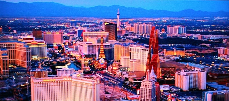

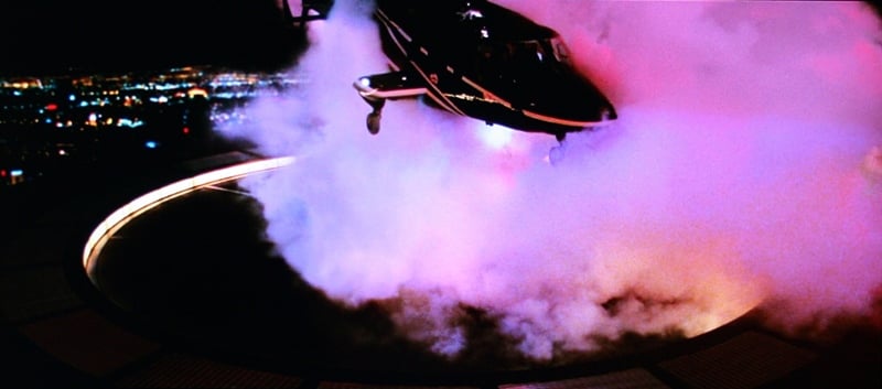

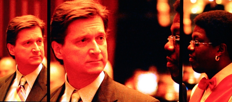

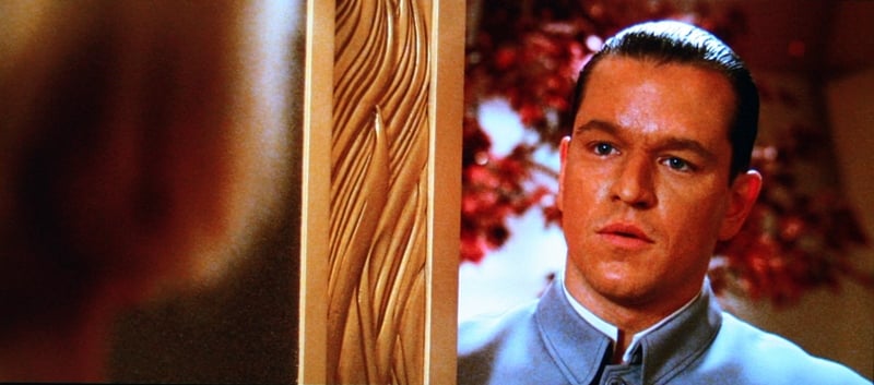

HD DVD - Ocean's 13
Imagine my surprise when I found a movie on my Netflix cue that was available in HD DVD (yes, it had been there a while). Like everyone else, I had really enjoyed Ocean's 11. Ocean's 12 was sort of a bomb for me but I had heard that this one was better. It was, but it still lacked the magic of the first as far as I am concerned. The picture overall was crisp and clean and the colors really popped. There was one scene where everything was tinted red and if you had the display in anything but Theater you'd see a TON of artifacting. Even when calibrated, this scene was mighty grainy. Overall, though, the picture looked really good.
