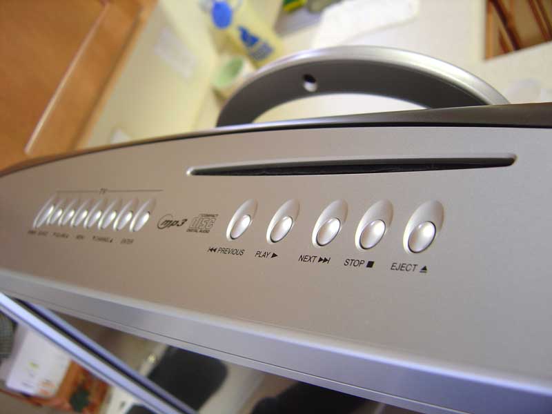

Axion AXN-7200 LCD slot loadingRemember those cheesy 50's television shows & commercials that depicted the household of the future? You know, the ones with bubble TVs, bubble sofas, and bubble cars (if you're having trouble picturing this, just visit an Ikea store.) Even the Jetsons didn't present such a hokey picture of the 21st century. While you have these picturesque visions of the future in mind, let's think about a more realistic - and truly contemporary - version of what a television could be. The AXN-7200, with its top-side slot-loading DVD player and curved display stand, presents what I feel is a forward-thinking "next stage" design for televisions - without reaching too far ahead or appearing completely out of place. This next-generation design is only compromised by a rather disappointing level of performance (both functionally as well as visually) that we hope Axion will eventually remedy.

image008_011.jpgThe layout of the remote is sensible and ergonomic. I have to admit, however, we had some difficulties with the remote control functions of this set. The remote seemed to lag severely - so much so, that certain functions literally took seconds to complete. Even when bypassing the remote and using the hard buttons on the top of the device, functions like changing the source would take 6-8 seconds . There was also no immediate visible feedback on the set that the command had been received. After a few seconds the on-screen display would show the new input source selection at the top right. As a result, it could conceivably take over 15-20 seconds just to cycle inputs (and it did.) We would like to see the software tweaked for additional speed and better user feedback. In television mode, changing channels took about 1.5 seconds between channels - another slow function and one we would like to see accelerated in future revisions. As it stands now, this is unacceptable behavior for a television set and makes this unit practically unusable in our opinion. Axion has indicated that future versions of this unit should correct these problems, however we can only report on the model we have which was shipping at the time of this review.
