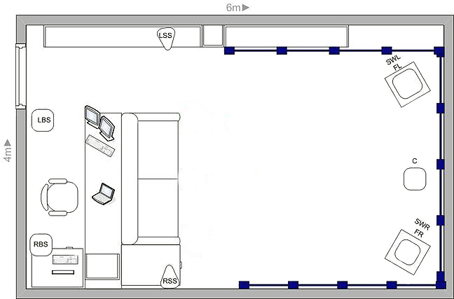

Listening was done in a room measuring approximately 6m x 4m, no windows and enclosed on all four sides, with the VTF-3 Mk3 located at one end of the room. (See illustration below). The sub was (at various times) positioned either between the front center channel speaker and the front left channel speaker or simply placed in substitution of the sub that ordinarily sat beneath the front left channel speaker.
