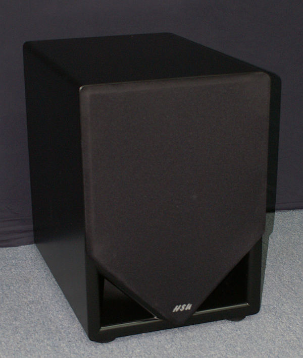

The Hsu sub as submitted had a smooth black finish, neither attracting attention nor warranting special notice.  There were no issues to be seen with the cabinet finish, and I found the dual V shaped ports at the bottom of the cabinet both sound from an engineering standpoint, as well as visually appealing.  If you have the room for it, there is not too much chance it is going to clash with any of your furniture or draw much attention to itself.   What I liked most was that it's styling of the ports and grilles was both unique and attractive.  During his visit to my laboratory, I was informed by Dr Hsu, that the "Rosewood" would be available at a $999 price point.  For some reason, the $999 model is called "Rosenut" on the website. (It looks like Rosewood!)  Likely for the same reason that Champagne is called sparkling wine when the grapes are grown in California instead of the Champagne region of France, but I should leave that explanation to Dr. Hsu.
