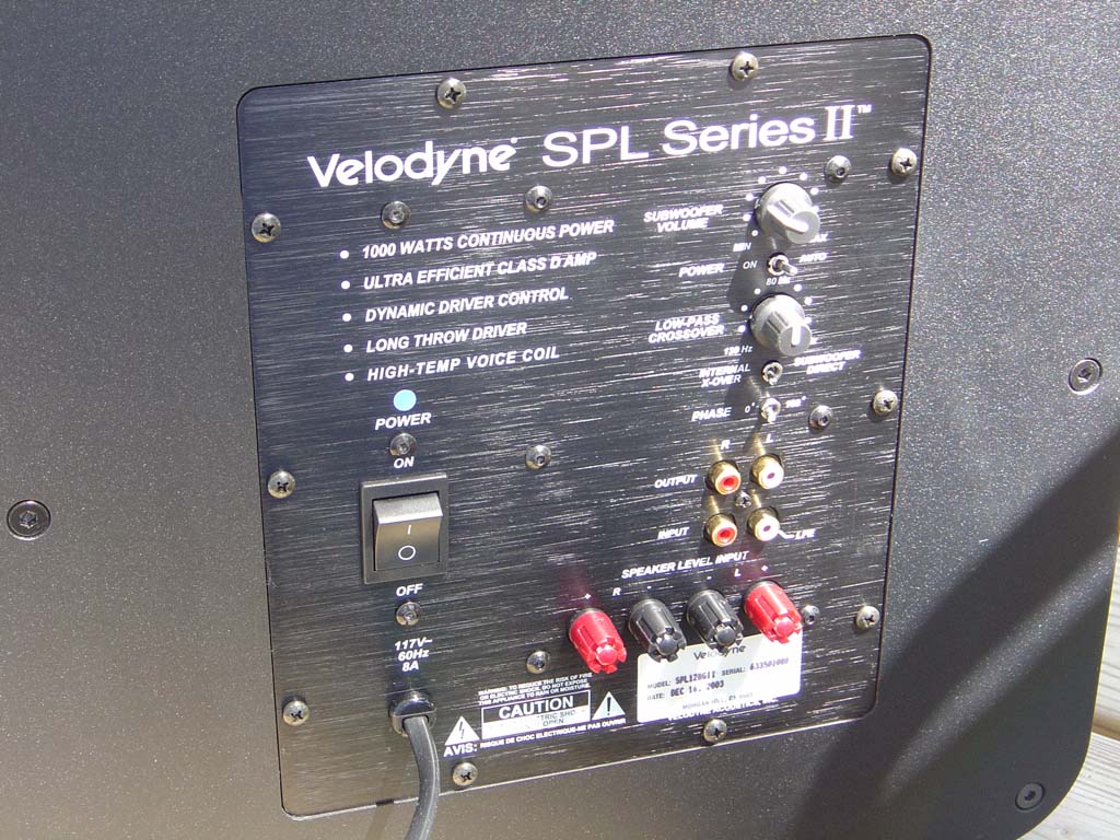

All in all, the entire SPL line of subwoofers has benefited from some significant upgrades.SPL-1200_panel_lg.jpg
Setting up a subwoofer can be difficult and is best done with two people. If, however, you only have one person, Audioholics helped pioneer a way of placing a subwoofer called "Crawling for Bass" nearly four years ago. Basically, since low frequency information will sound the same coming or going, the subwoofer can be placed in the listening position. Then, while playing bass-heavy content, the listener can crawl around and find the best subwoofer placement. Sound odd? Try it - it really works! We've been using this method for quite some time now and it has saved countless hours of going back and forth between different positions in the room. I found the best spot in my listening room was the same spot my current subwoofer occupies, the front left corner. This provided the tightest, loudest, most defined subwoofer performance. Settling back into my listening position, I configured my receiver's crossover at 40Hz for musical listening, and also tried it at 80Hz (THX) for feature films and THX processing.SPL-1200_amp_lg.jpg
The SPL Series II supports line level inputs as well as speaker level inputs. For a majority of people, you can simply connect the LFE or subwoofer output of your receiver to the LFE input of the SPL-1200. If, however, you have a processor, receiver or preamp without bass management, you can connect the main channel pre-amp outputs of your receiver/processor to the SPL line level inputs, and then take the line level outputs and send them to your receiver/processor's or amplifier's pre-amp inputs. The Velodyne's crossover will determine the frequencies that will be produced by the sub and your main channel amplifier is only being used for frequencies above the fixed 80 Hz high pass crossover point. Of course, if your receiver or processor has bass management (most do), stick to using the LFE input- it accomplishes the same thing.

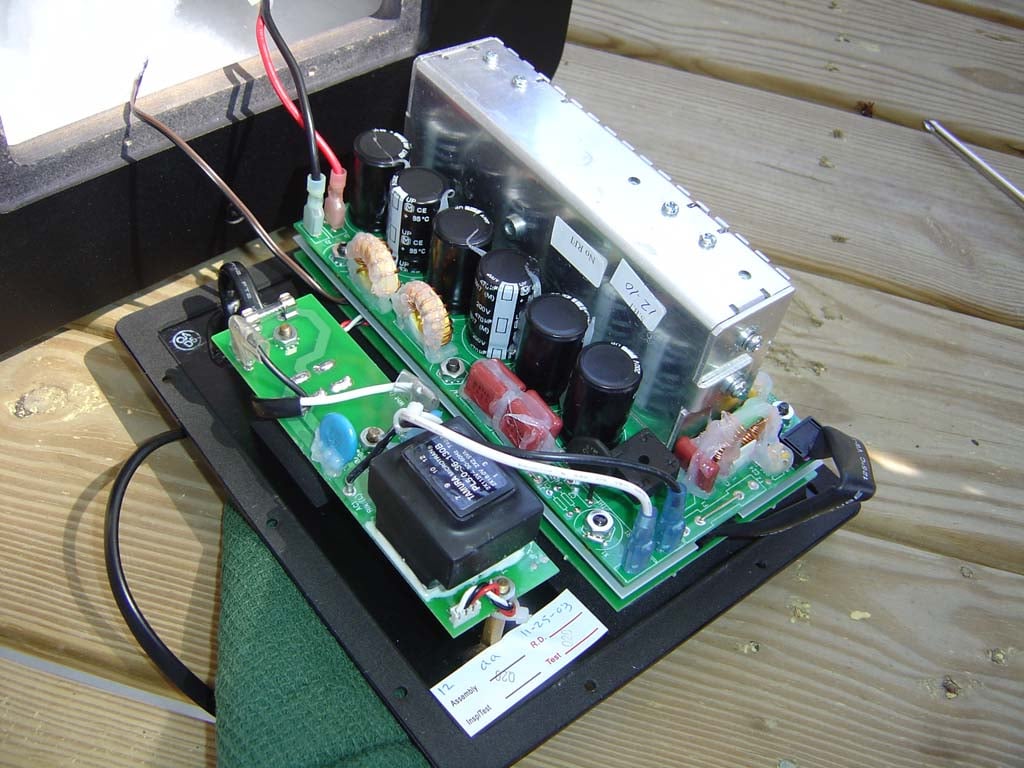

We opened up the SPL-1200 to see if Velodyne continued its tendency towards solid build quality. We weren't disappointed. The interior of the subwoofer showed excellent corner bracing and sufficient padding to render the shell of the unit as inert as possible. The tightness of these subs and their lack of audible resonance is testimony to the fact that they are well-reinforced and built like a brick.
The new Series II SPL line amplifiers are patented ERS (Energy Recovery System) 1000Wrms (2000W dynamic) systems that deliver an abundance of Class-D digital amplification. They utilize a distortion-lowering DDCS (Dynamic Driver Control System) that uses impedance feedback to lower distortion to around 5% at rated power.
